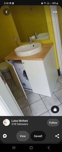

I am a first home buyer of a small 2 bed unit that currently has no laundry.
I would like to incorporate my washing machine into a new bathroom vanity with sink ontop.
I'm wondering plumbing wise would the be enough room underneath for waste pipe and taps to be connected to the front loading washing machine?
Also is a vanity able to be made out of the practa worktop bench? I like the speckled white one but can see it's only 28mm thick so may not hold a basin on its own? And because it's only 600mm wide, gluing two together may also weaken its strength?
Wanting cheap options on what to create the vanity with as am on strict budget.
