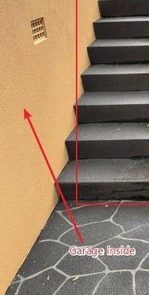

The acrylic rendering on top of the brickwork seems to be already water resistance, however, some lower part of the house exterior wall are easily exposed to rainfall as there is no cover (tree canopy or roof/gutter).
See the orange is acrylic rendering. Grey/blue-ish stair is coated with some sort of concrete topcoat (used concrete sealer on top of it).
Is this correct product to waterproofing the acrylic rendering layer? Or something else (better)?
