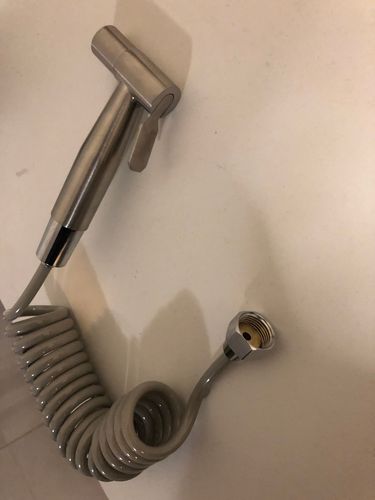

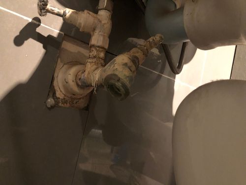

I need help choosing the right adapter to install a hand bidet shower with a tap. I have attached the pictures. Would you please suggest what adapter should I use?
Welcome to the Bunnings Workshop community @Abrar. It's brilliant to have you join us, and many thanks for your question about install a handheld bidet.You'll need to enlist the services of a licensed plumber to install the device for you as they are not a D.I.Y. installation. There are some fairly strict regulations surrounding bidets and at a minimum, they need to be connected to a high-hazard backflow-prevention device to prevent contaminated sewage water from getting into your drinking water supply. Your plumber will be able to supply one of these devices along with the installation.
