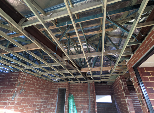

I'm also looking to hang a chair from the ceiling in my house (built 2 years ago - sharing this mid-construction photo to show the different types of beams). Could you please suggest which type of beam would be best to connect the chair to? Eg one of the metal ones?

Hello @sallyykingg
Thanks for posting that photo of your roof framing. Although there is a large metal beam running along the center of your two walls, it's been designed to carry the roof framing and trusses only. Adding extra weight might offset the balance and damage your roofing frame. The metal beam will not only need to hold the weight of the person, but the dynamic forces applied to the swing which would be considerable if the swing were to be used vigorously.
In this instance, I suggest engaging the services of a professional. They will be able to determine how to reinforce your ceiling frame so that the swing can be attached safely. It might even require adding a whole new timber piece just dedicated to hold the swing.
