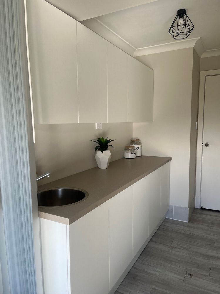

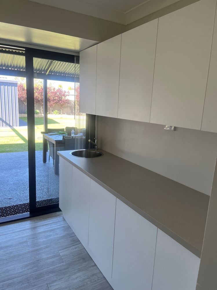

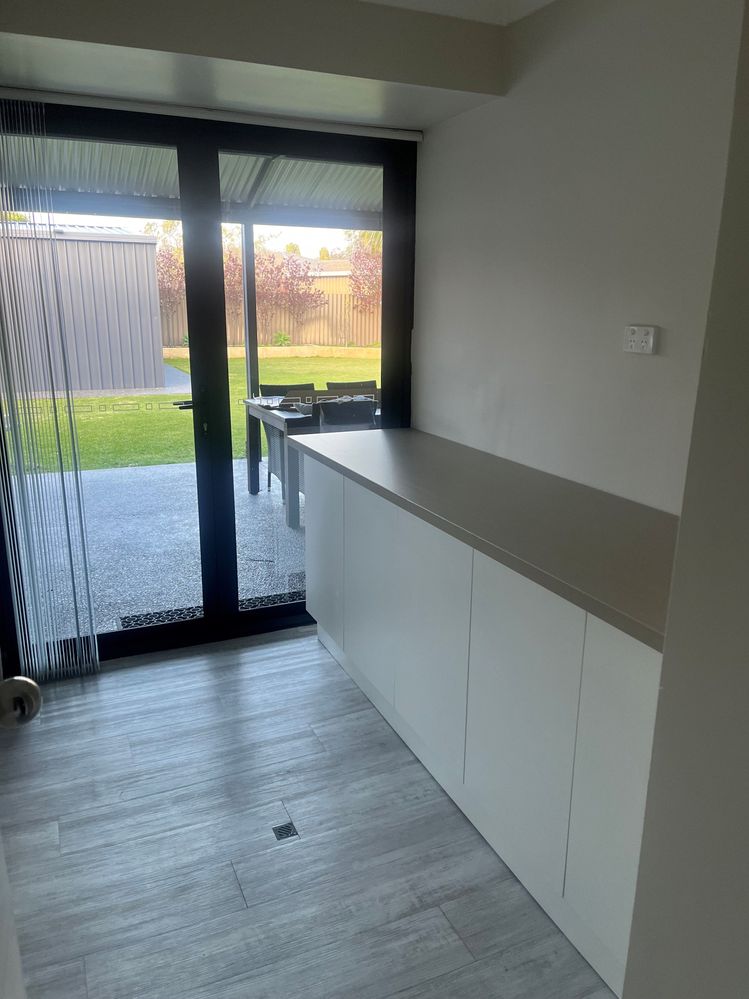

We wanted a laundry where the washing machine was hidden behind cupboard. The space is narrow so we wanted to look bigger, we didn't need a broom cupboard, so we opted for floor and wall cupboards.
All materials used were purchased from Bunnings.

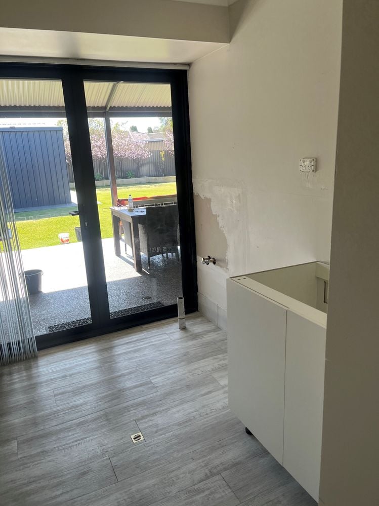

3 we removed the old laundry trough and 2 door utility cupboard and old washing machine
Step 4
4 plumber and electrician did their part and we fixed the wall after plumber was done.

5. we bought 2 x 900 floor cabinets 1x 450 floor cabinet 2 x 900 wall cabinets and 1 x 45 floor cabinet. kaboodle bench top, laundry sink, sink tap and washing machine taps
Step 6

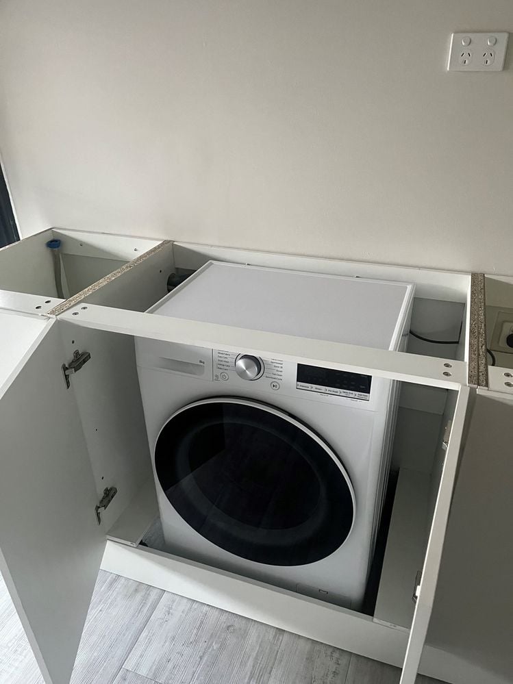

6 assembled all the cupboards together minus the doors. we made adjustments to one 900 floor cupboard

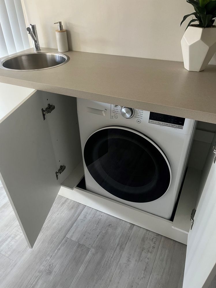

we did not install the shelved and cut the bottom shelf leaving room for cupboard feet and enough space for washing machine. Confirming there is enough space for movement of washing machine. You will see in pic the bottom panel this click to legs so we have access to clen filter or be able to take washing machine out if needed
Step 7
7 placed the floor cabinets in position,used clamps and adjusted legs to make it level, checked to make sure washing machine fits then screwed the cupboard to each other and the wall checking levels at all times. we then placed the washing machine in its position inside the cupboard.
Step 8

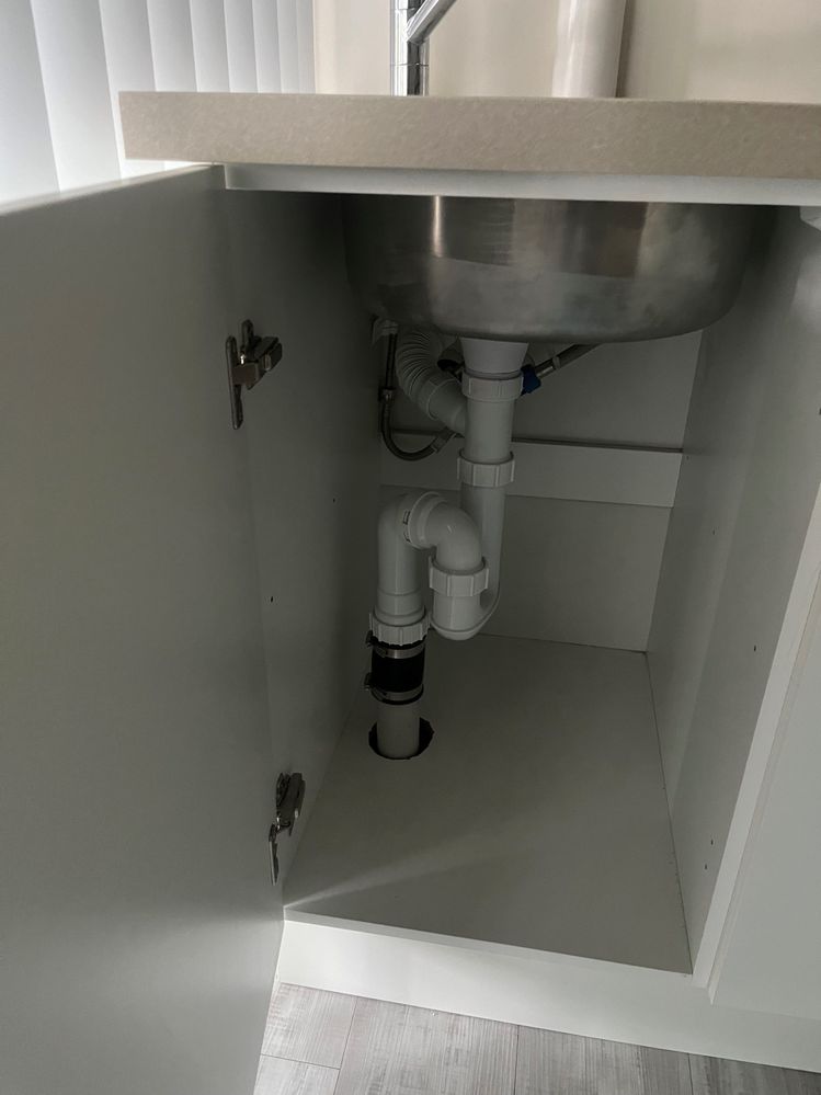

8 we then installed the benchtop cutting the whole for sink before bolting the benchtop. sink was then installed
Step 9

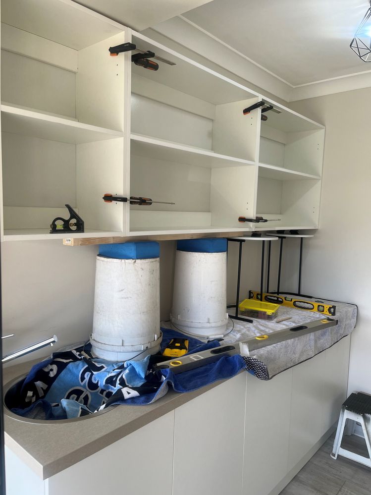

9 we then installed the wall cabinets as you can see we improvised as we did not have stands at the time to hold the cabinets.
Step 10
10 the cupboards door installation was the last step
