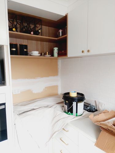

Demo and install
This included removing the old tiles and cabinetry. We had the cabinets and benchtop professionally installed.

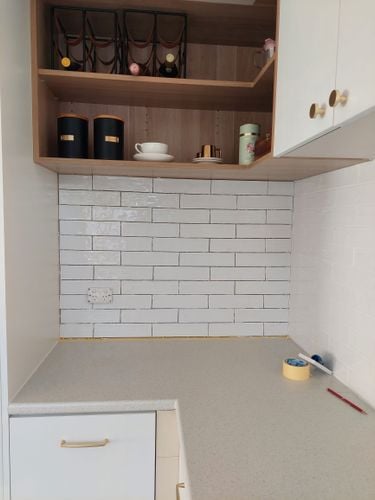

Laying tiles
I prepared the surface with tape, and ensures the benchtop was level. I used spaces to keep the tiles from sitting on the benchtop
I layed the tiles using tile adhesive and a trowel. I used an angle grinder with a tile cutting disk to cut around the PowerPoint

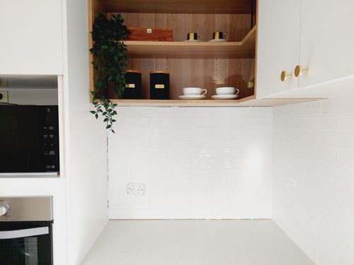

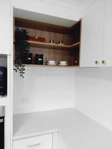

I then applied silicone to all the edges ensuring a nice neat finish.

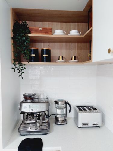

After this I cleaned up the tiles and the job was done.
