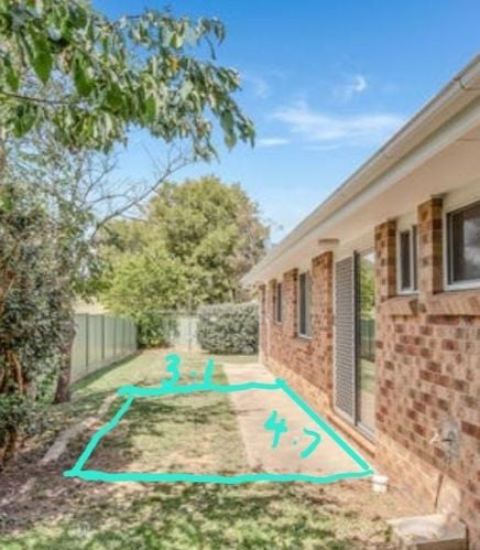

I am building a low level, small deck (approx 15sqm). It will sit on a combo of existing concrete path and grass.

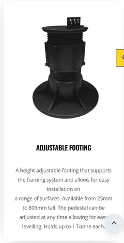

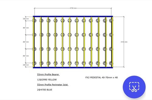

It is 4.1 x 3.1 and I am using an aluminium and adjustable pedestal decking kit. The finished height will be 140mm. I am using 140mm x 19mm merbau boards.
Lastly, I would say soil type would be moderate clay.
I've attached photos of my deck plan, the pedestals and where it will be going.

2. I estimate I will need 24 footings for the pedestals on the grass. I am trying to work out what to use for footings and keep them budget friendly.
