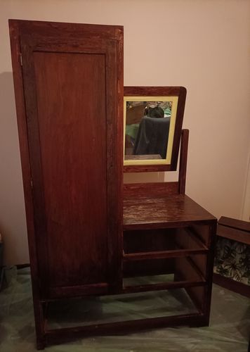

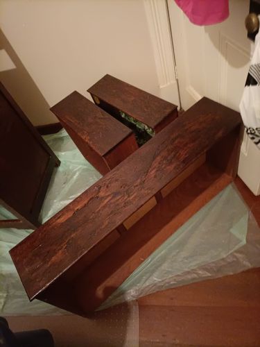

1. Sanded both furniture pieces and washed over to remove dust.

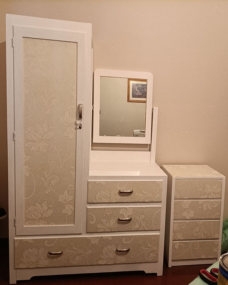

4. Applied the opshop wallpaper using wood glue, to the centre panel and drawers on the wardrobe, and to the top and draw fronts of the small drawer set.
Step 5
5 Sealed all the wallpaper with a 70/30 mix of wood glue to water, applying 2 coats.
