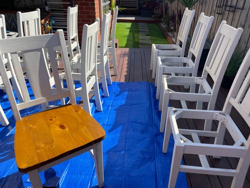

Remove the chair seat from the frames. Lightly sand the frames and using the spray gun, paint the frames cafe cream colour.

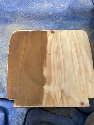

Using the Ortiz sander and 60-80 grit sandpaper, sand the chair base. This process took almost 1 hr per chair base and I have 12 seats.
Step 3
Remove the table top from the legs. Using the same Ortiz sander and several replacement 60-80 grit sanding sheets, sanded back the dark brown table to its natural wood. This took almost 9hrs over a number of days (lots of pressure on your back, arms and legs).

Paint the table legs the same cafe cream colour as the chair frames.

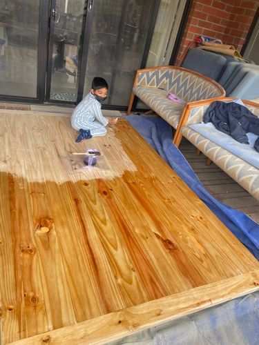

Clean all the sawdust off the table and chair based and wash with a water and sponge. Apply clear varnish to the natural wood, let it dry and lightly sand with 240-260 grit sandpaper, before applying varnish again. I applied three coats (with my little helper)

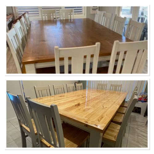

What an amazing transformation in the before and after shots.
