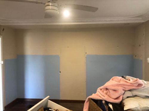

Prepare to dismantle old wardrobe and remove all clothes
Step 2

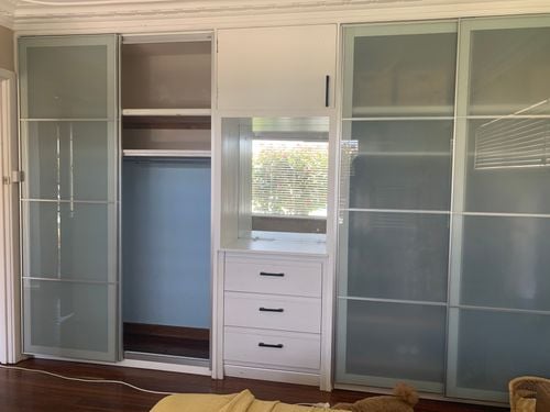

Dismantle and remove existing built in wardrobe

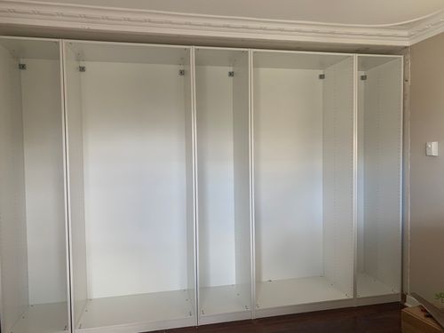

Build flatpack wardrobe bases. Making sure during the design phase to order flatpack sizes that will maximise the space available and fill out as much space as possible.

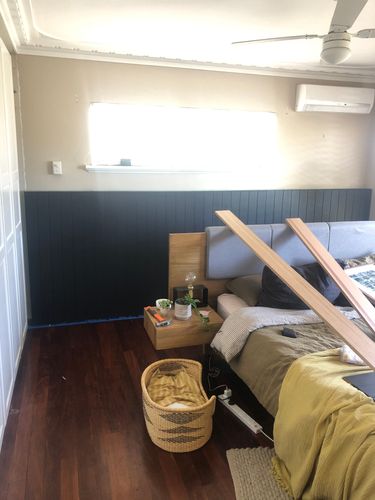

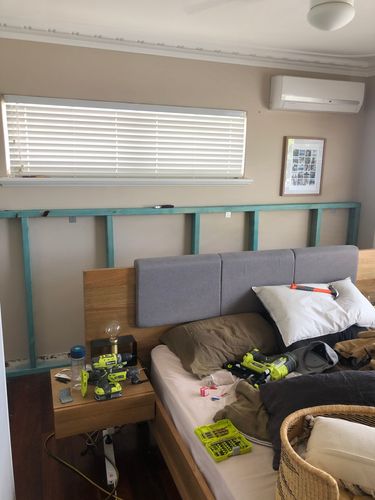

Remove existing skirting and build frame for paneling, attaching to the wall with brackets
Step 5
Attach easycraft panels with nail gun and liquid nails and paint

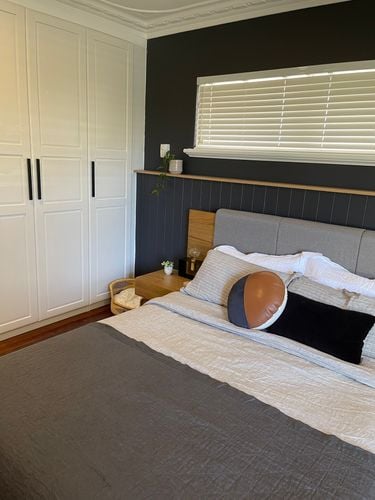

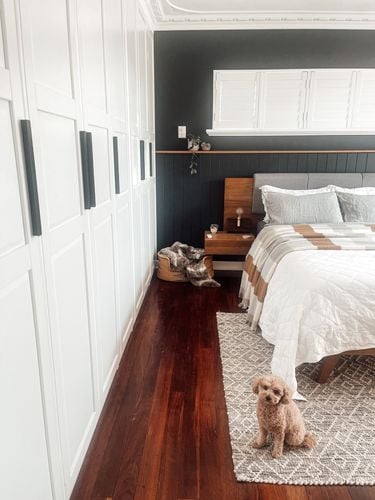

Using a cover panel the same colour as the flatpack, cut to size and attach the side of the wardrobe to give illusion of built in wardrobe. Cut oak ledge to size and complete painting making sure to caulk and fill any gaps around the wardrobe cover panels
Step 7

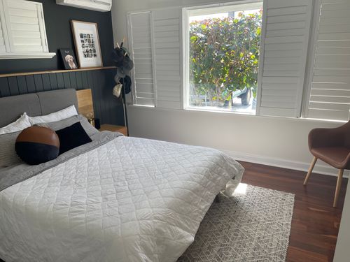

Paint and reinstall skirting in front of paneling. Install custom ordered DIY shutters
Step 8
Enjoy!
