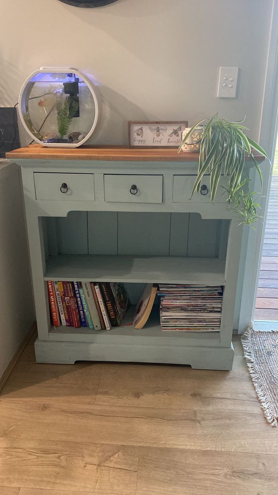

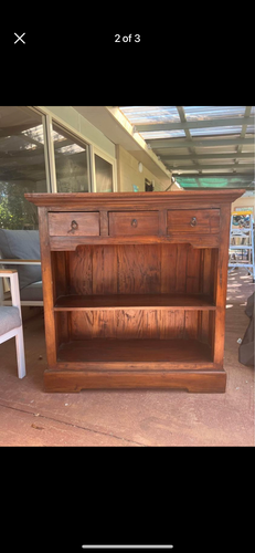

Steps
Step 1
Use the orbital sander to sand off all the dark exterior using a corse sandpaper. Finish off using a fine sandpaper.
Step 2
Wipe the surface clean with a dry cloth.
Step 3
Use the chalk paint paintbrush to roughly paint the bookcase, excluding the top. Allow to dry (follow instructions on tin) then apply a second coat.
Step 4
Use a soft rag to wipe on the soft wax on the bench top.
