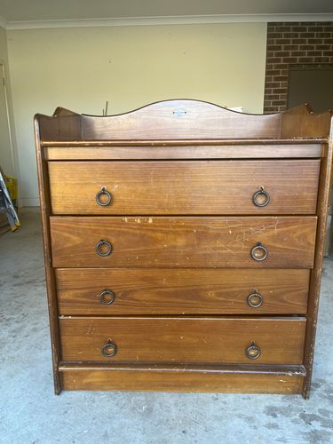

This was an old set of baby drawers with a change table on top brought from a baby shop. My son is now 14 and I wanted something that suits a teenage boy. It is a solid hard wood piece which is extremely hard to buy new. It was cheaper to upcycle and still have a good quality piece of furniture.

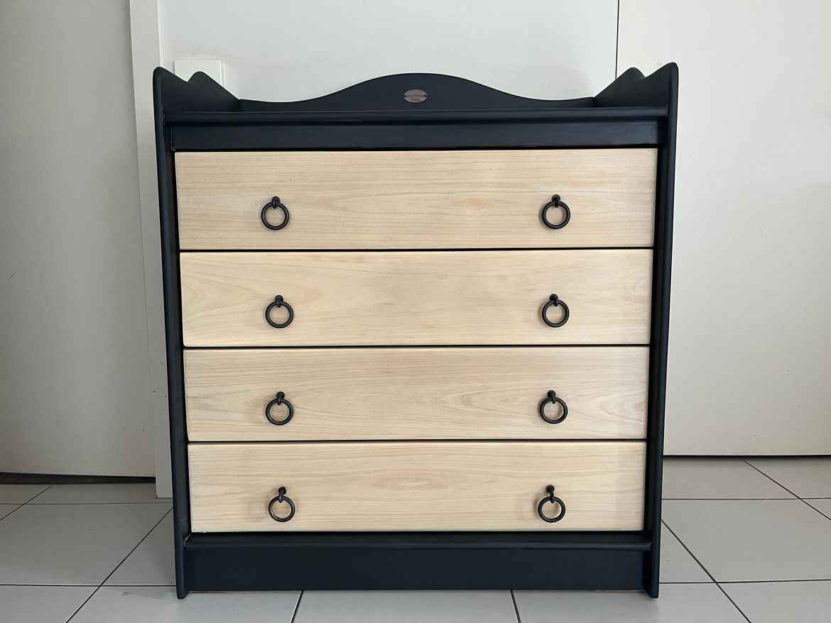

Sanded all the varnish off the furniture using 40 grit sandpaper. Worked my way up sanding using 60 grit, then 120 grit, to 180 grit and finished with an ultra fine grit of 240.
Applied 2 coats of eclipse paint to the frame. Applied liming white to the drawers.
Attached original drawer handles
