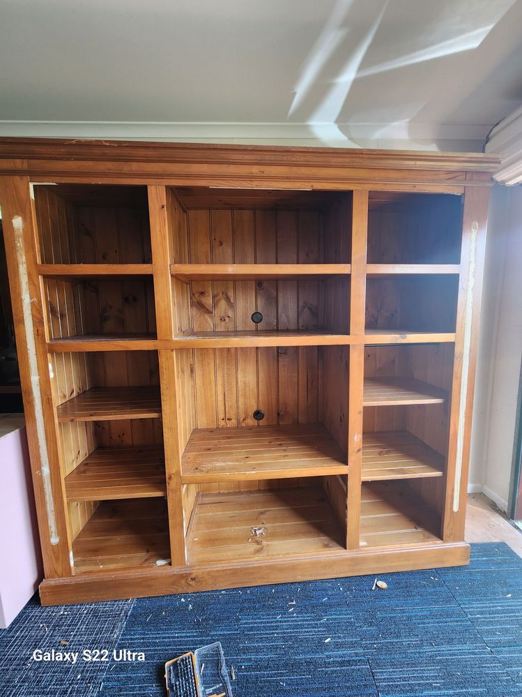

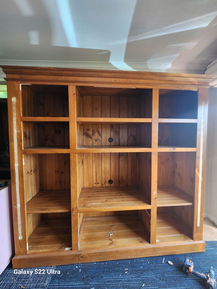

First I removed all doors, hinges and screws. I then removed the decorative detailing from the sides and along the top of the piece and filled in the holes with wood filler
Step 2
Next up was to make the bottom left and right boards level with the center. I measured out the height and used brad nails along the sides and back of the piece to secure them in.
Step 3
Up next was designing the 4 separate lockers. To do this i removed the lower shelving wood and with some spare wooden VJ paneling I created a divider in the middle of the piece and also one down the bottom to create another small cubby. I used spare pieces of wood to cover the gaps in the middle sections, alot of nails and alot of wood filler.

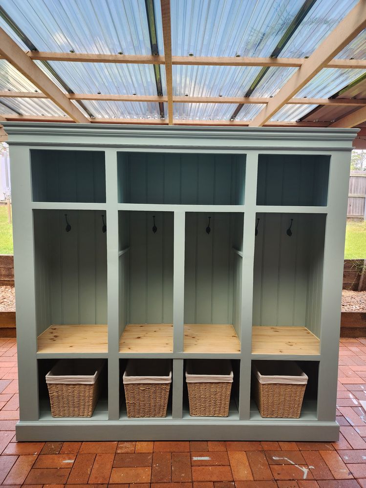

Once all the holes were filled and gaps sealed this piece was given a full scuff sand with the orbital sander. Seats were sanded down to raw timber and the whole piece was given a good wash down ready for primer and paint.
Step 5
Finally 2 coats of primer was added, and 3 coats of dug egg blue Dulux paint, along with 2 coats of Cabots Matt Clear Varnish. Black coat hooks were added, baskets from Kmart and finally the job was complete ready for a family to use.
