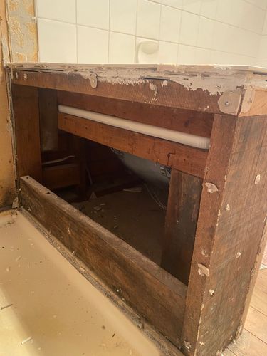

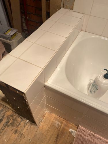

i would like to keep my old bath. There is this ‘ledge’ which I want to remove and tile the back of the bath. Essentially to reframe the back. Is this a major job? I’m 2 minded about buying a new bath as there is nothing wrong with bath.

Looking at the photo you posted, the ledge next to your bath seems to serve as a divider between your bathtub and shower. However, I don't think it functions as anything else other than that. If that's the case, I think it should be ok to remove the ledge without compromising your bath frame.
But just to be on the safe side, I suggest adding a few timber noggins to the front of the existing bathroom frame in order to support it further. Once you've reinforced the frame you can then cover it with wet area plasterboard.
