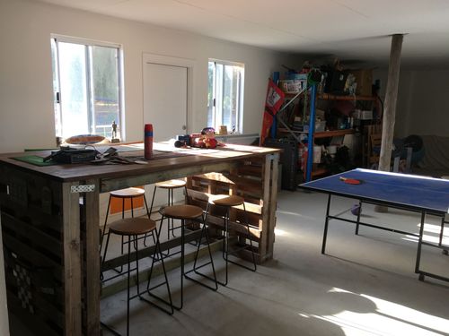

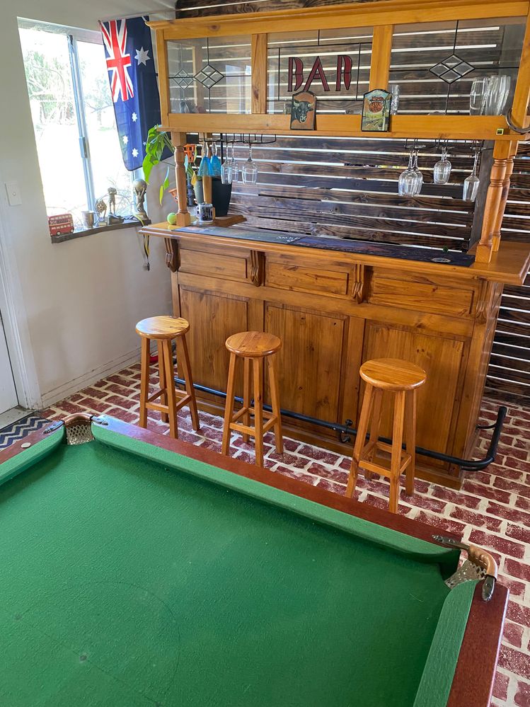

When we built our house we built a quadruple garage, with half of the garage designated to being the man shed/bar. It just had plain concrete floors, and we decided to start there.
I looked up many ideas and settled on faux bricks!

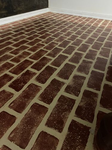

Start with cleaning the concrete floor to prep for painting.
Step 2
Use the roller and paint two coats of the cream paint.

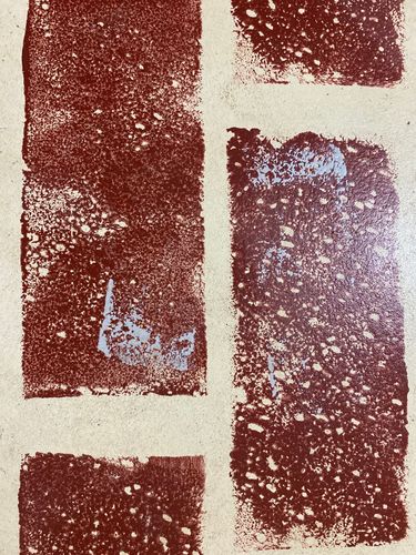

Cut the sponges in the shape of a brick (helpful to use a real one to get the right size).

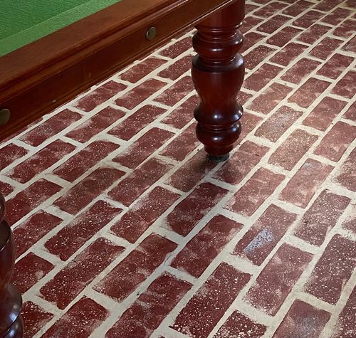

Do a few practice rounds on paper using the sponge in the red paint. You will have to have a few half sponges cut too for when you get to the end of a row and can’t fit in a whole ‘brick’.
Afterwards, use the grey paint on a small sponge to dab random patterns to make it look like old reclaimed bricks.
