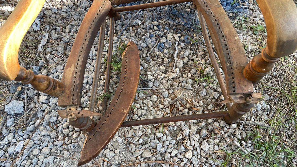

Preparation is so important when it comes to painting. My chair was a little unusual in that it was in pretty bad shape so I had quite a bit of work to do before i started painting.
The first thing we needed to do was glue and nail the chair back together. Thankfully when the chair fell apart we kept all of the smaller pieces so it was literally like a puzzle.
We glued the pieces into place then used a 18ga nailer to secure each corner and strengthen them.

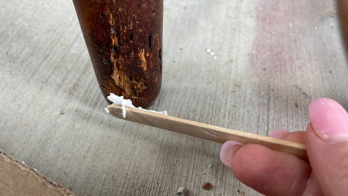

Once I had made the repairs to the seat and arms, I applied wood filler to some of the most damaged sections. I’m not usually too particular with this as I don’t mind a little age shining through, it’s all personal taste.

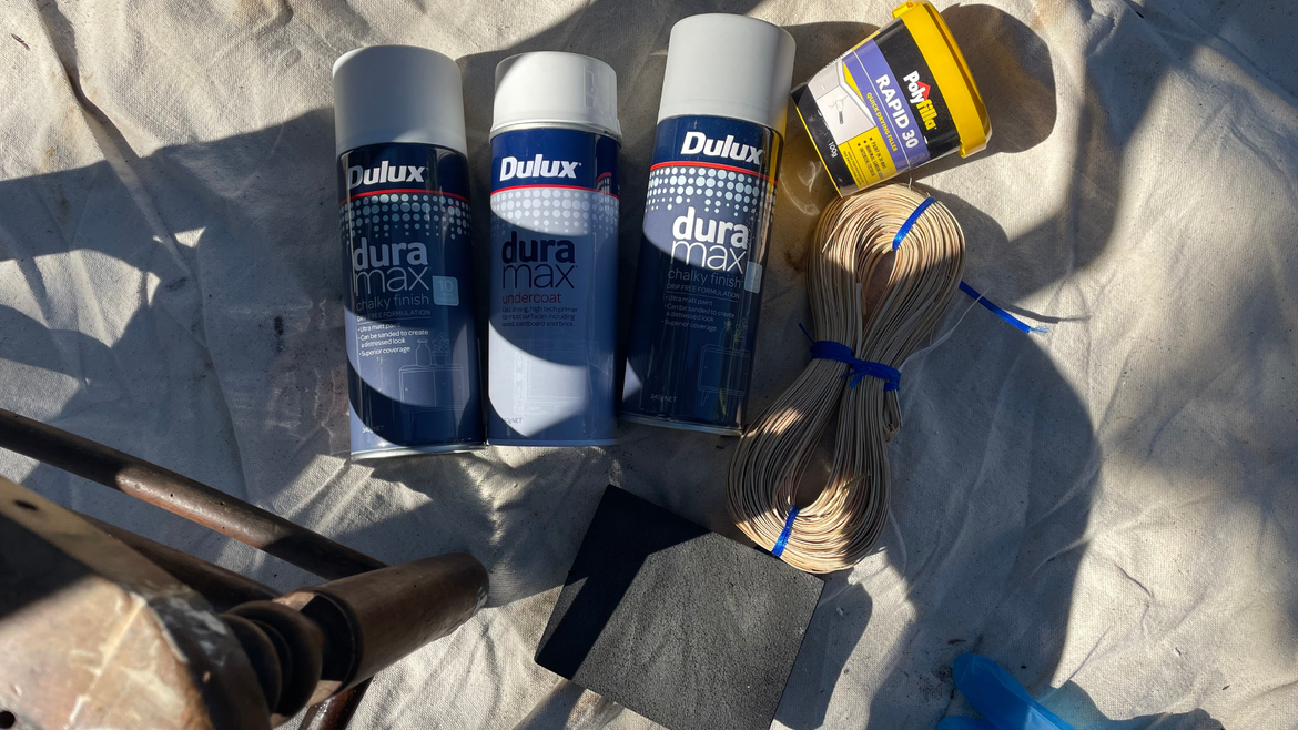

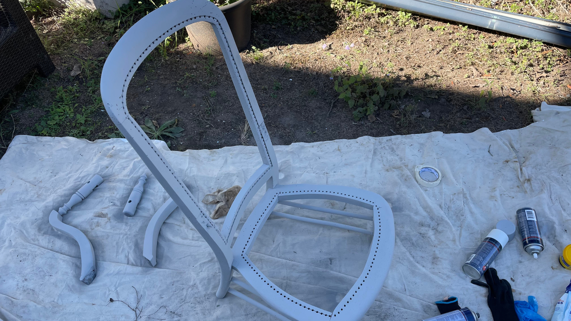

Prime – I used Dulux Duramax® undercoat spray to prime my chair and applied one coat using light strokes.
Paint
First Colour – I applied 2 coats of Dulux Duramax® Riviera Grey Chalk Finish Spray Paint and left for 2 hours to dry between coats.
Second Colour – I applied 2 coats of Dulux Duramax® Parisian White Chalk Finish Spray Paint and left for 2 hours to dry between coats.

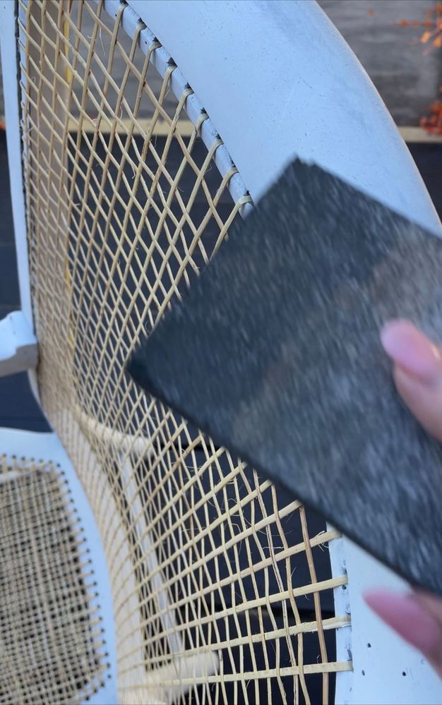

Step Four - Distress
Once the paint was completely dry, I ran a sanding block along the edges of the chair and along the front and back. By applying more pressure you will expose the wood, and less pressure, you will expose the first shade of paint. There’s no right or wrong here, depending on the look you want to you may choose to subtly distress your piece or you could be far more aggressive.

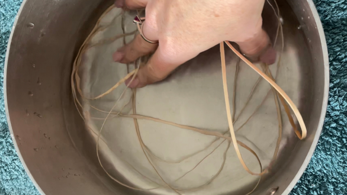

This is the step that was completely new to me. I have never done any type of weaving so this step was a little stressful as I really had no idea what I was doing. But like with every project, I do my youtube research and then just figure it out as I go.
The first step was to soak the cane. This step is really important otherwise the can will snap whilst you weave. You need to soak it in warm water for 2-3 minutes before you start weaving.

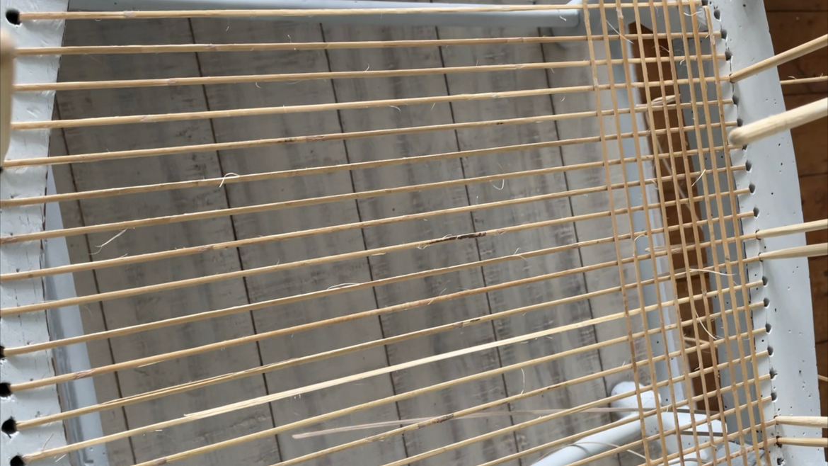

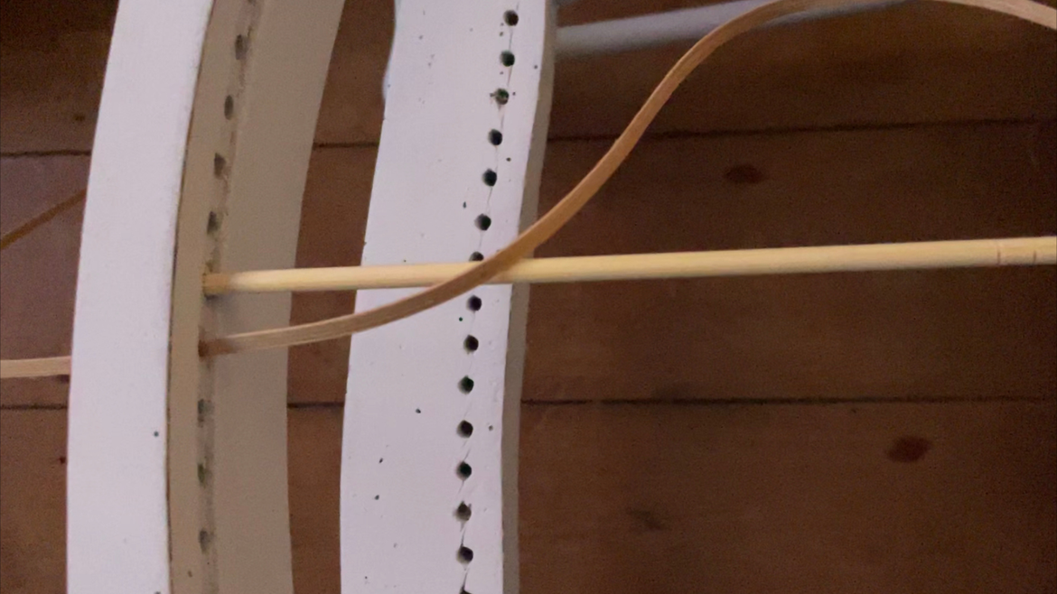

Step Six - Start Weaving
I started from back to front and wrapped the weave then side to side.
TIP:
I found the cane frayed when I was weaving so I rubbed Vaseline on the threads of the cane before I started weaving and it worked a treat. It made the weave much easier to thread and didn’t fray.
