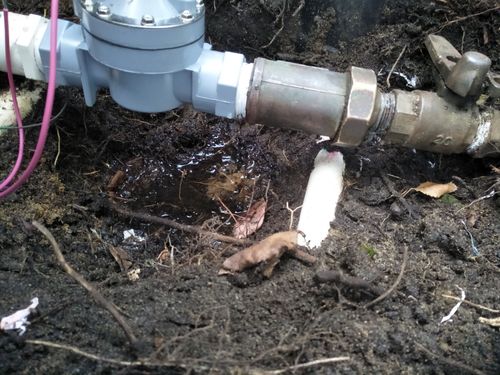

I'm having problems connecting Brass male connection to PVC solenoid. . Have tried all colour plumbers tape and won't work, still leaks. Photo attached. Getting very frustrated. Hope you can help.

Actually, the male threaded connection is brass and it looks pitted, could this be the reason why the tape is not sealing?
Believe it or not I bought the same grey tape you suggested a couple of days ago form Bunnings of course but haven't used it yet. I'll give it a try and see how it goes and will let you know. I don't have much faith somehow. I normally fix these retic problems myself, but this has got me beat.
Cheers

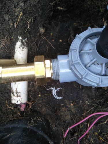

HI Eric, tried the grey tape and it didn't work. Attaching pic of what I'm up against with the brass thread.
Hi @eriswa
Thank you so much for posting that photo of the brass fitting. Having had a good look at it, I'm afraid it will need to be replaced. I don't think even the LA-CO SLIC TITE Thread Sealant will work on this as the brass threads are too deteriorated. My best suggestion is to bring the brass section to the plumbing isle in the store to make sure that you get the correct size and length.
Please note that it might be necessary to combine several pieces together in order to achieve the proper fit.

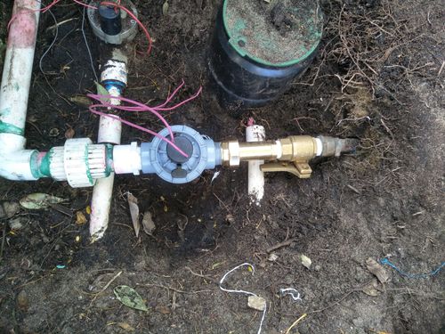

HI Eric, I finally fixed the problem. Got a brass kit from irrigation shop in Greenwood. Had a lot of problems first sealing the brass connection to the solenoid. Had three goes with the white tape but wouldn't seal. Then remembered you suggesting the grey tape for the old brass connection
which didn't work. Tried it on the new one and bingo it worked first go. Attaching pics of the finished product. Cheers Eric
Nice work, @eriswa! Thanks for updating us on your success!
