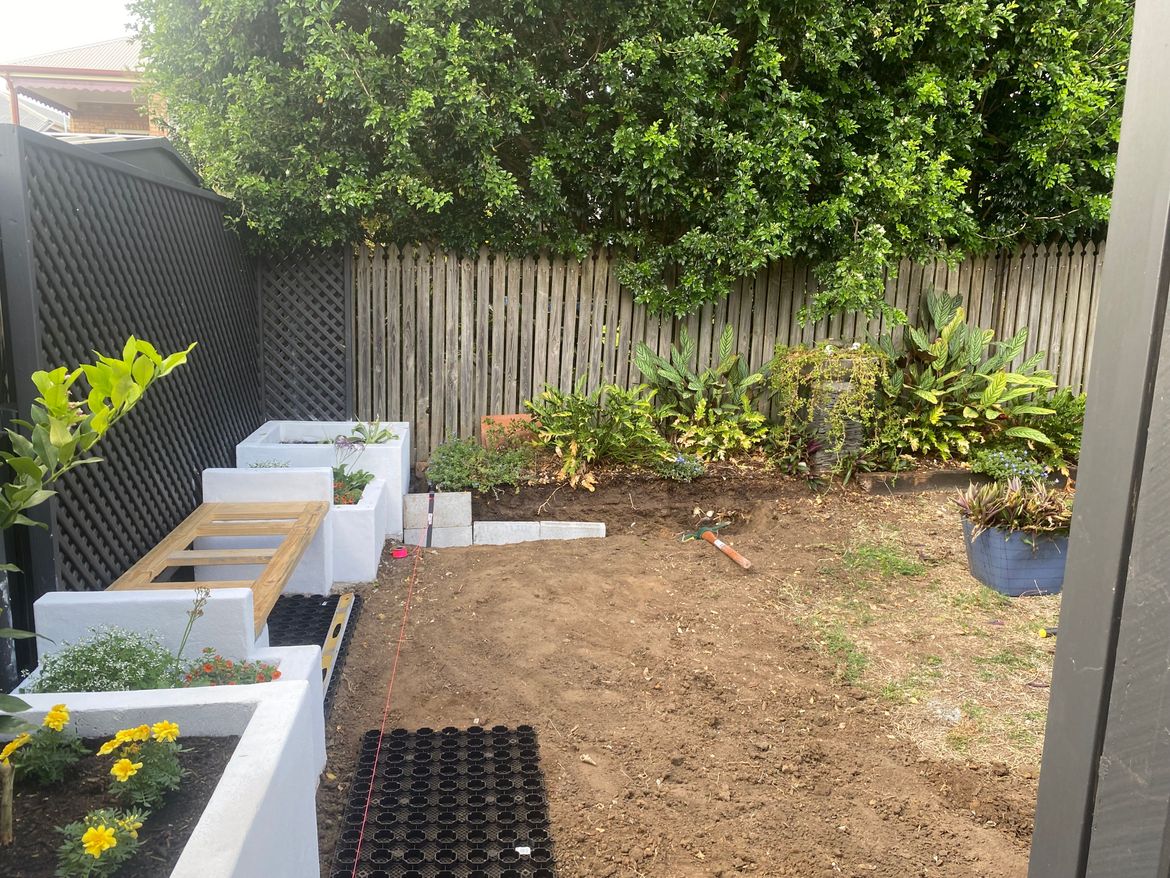

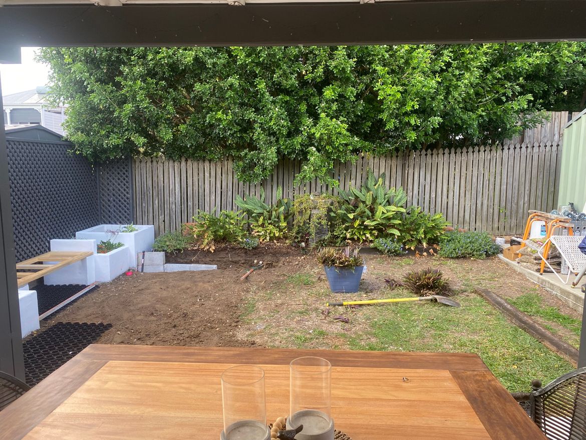

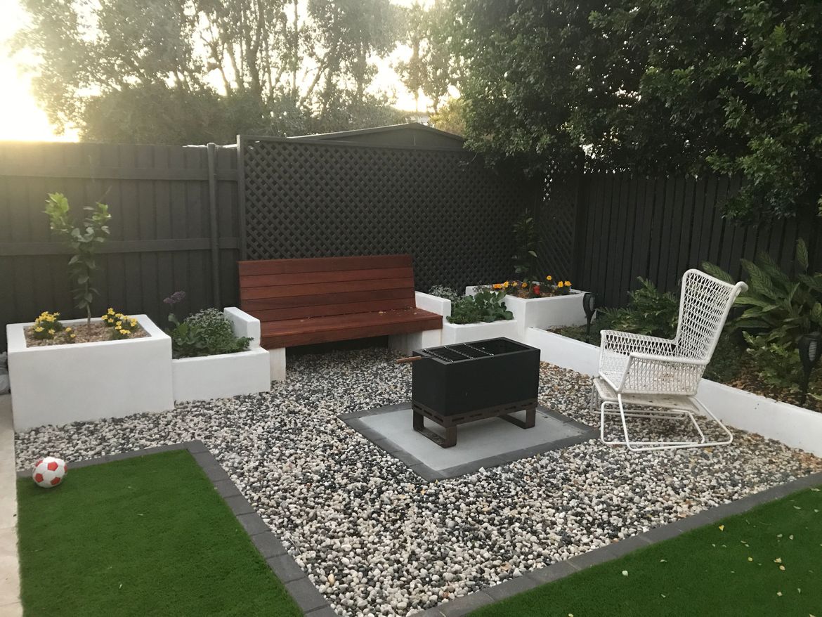

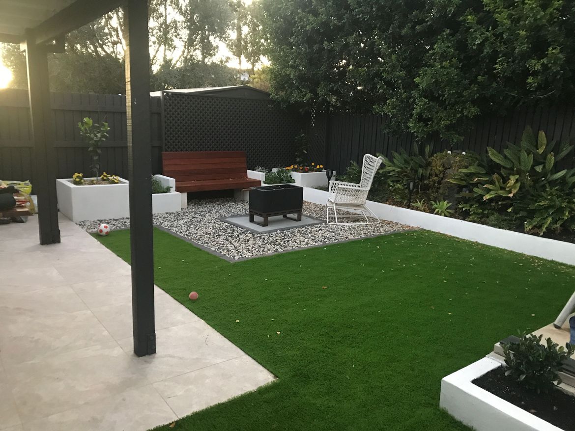

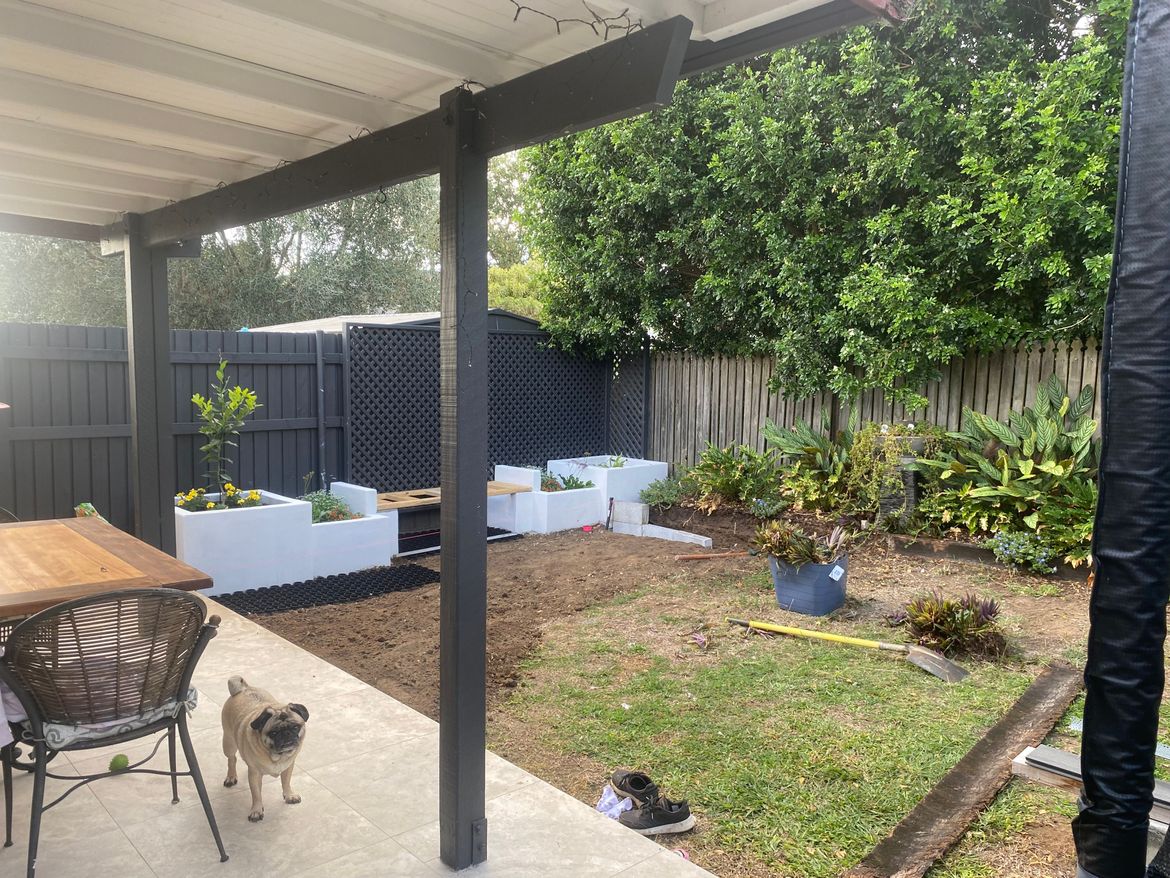

The backyard was ugly and I wanted to create a place where we could entertain and a focus on low maintenance. Using the concrete bricks to make the raised garden beds then used a 2 step render - something I had never done before not 100% smooth but still looked great. I used the textured deluxe paint finish which really made the difference. The bench was made with merbau decking and sealed when it was finished. I used the grate system to hold the pebbles in place and put a brick paver boarder for the synthetic turf to butt up against. The hire shop was great for the compactor to use for the roadbase. I love the grass as it is thick and has a real natural look. Love the end result

Thank you and yes I love this area and we are spending a lot more time with family and friends

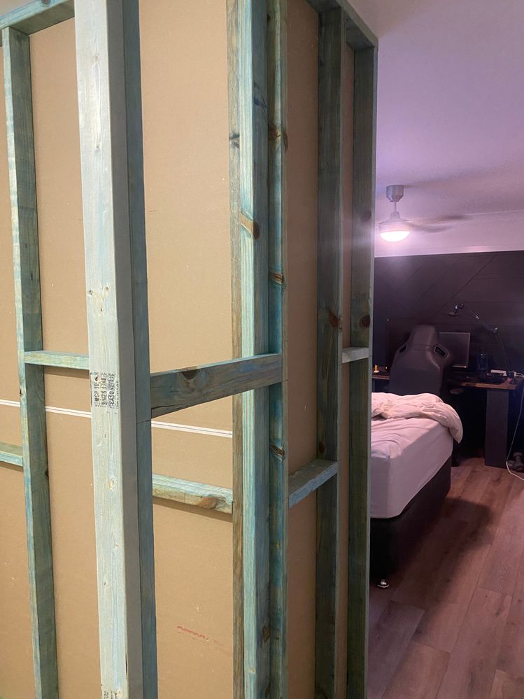

Yes I have plenty of things I want to do - build a she shed out the back I have the slab just need to get going and also looking to do up my son’s room was the old garage so need to raise the floor and then I will put some timber flooring down. He also needs a wardrobe so part of the plan. Question I have to raise the floor 41mm was going to use yellow tongue and red tongue so two layers to get the height would this be okay to do?

I can't see any issues with layering red tongue over yellow tongue. What type of timber flooring will you be using?

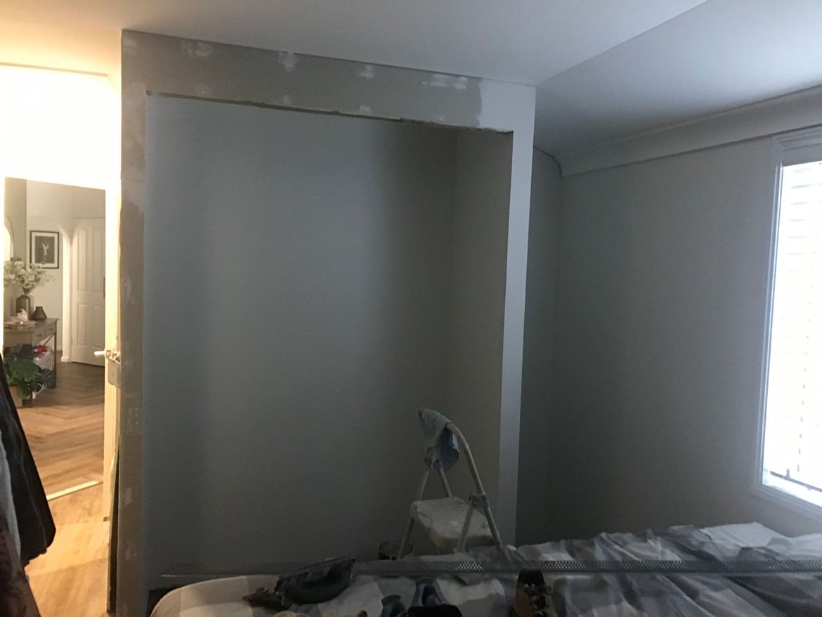

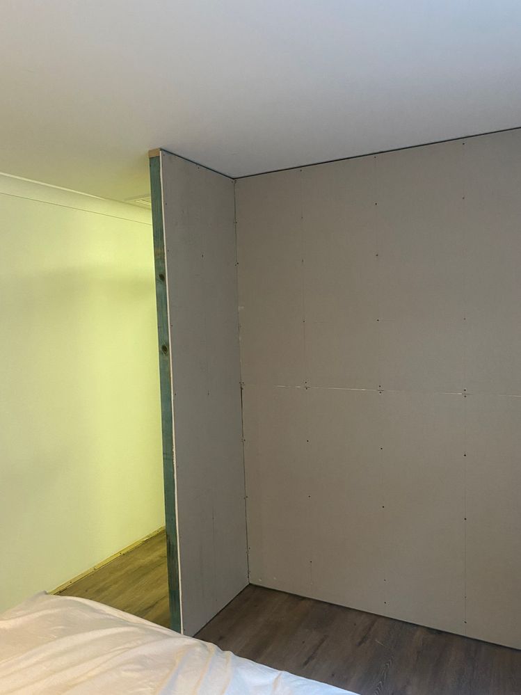

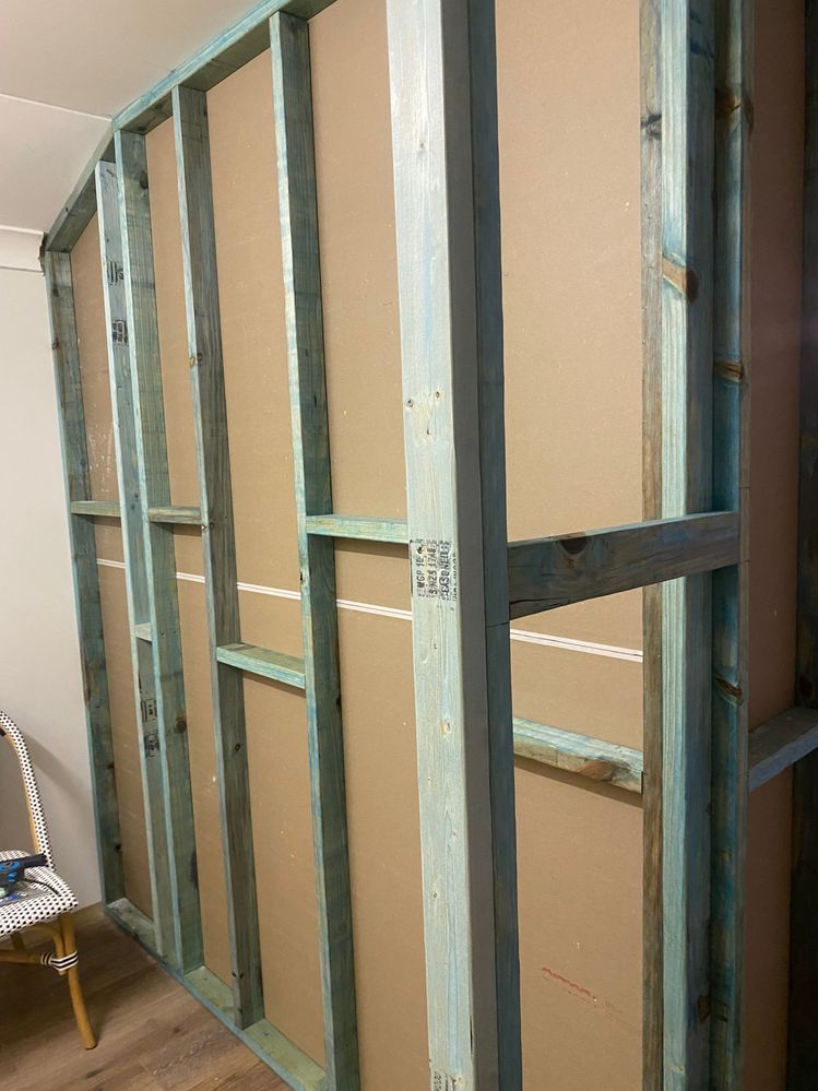

Well the shed is on hold as I am working on my sons room. Coming together stud walls up most of the gyproc just plastering then should be ready to paint. Looking good 😊WardrobeGyprock upStud wall for walk-in linen room
