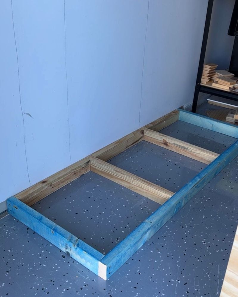

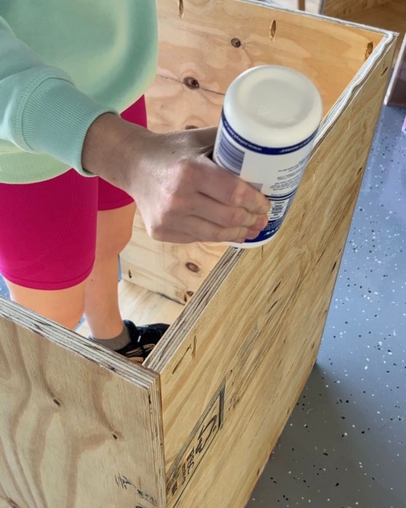

Step 2
Build base frame for the boxes to sit on and secure into the studs.

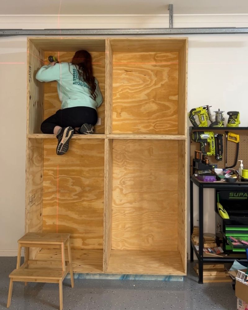

Step 3
Secure boxes to base frame and studs in the wall.

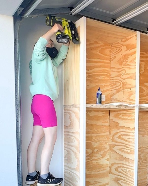

Step 4
Trim out the boxes with the primed pine using wood glue and a braid nailer (or hammer and nails if you do not have one).

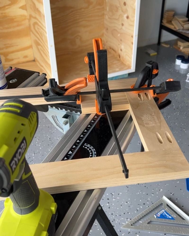

Step 5
Build the frames for the doors out of the 64mm DAR Pine and the Kreg Pocket Hole jig.

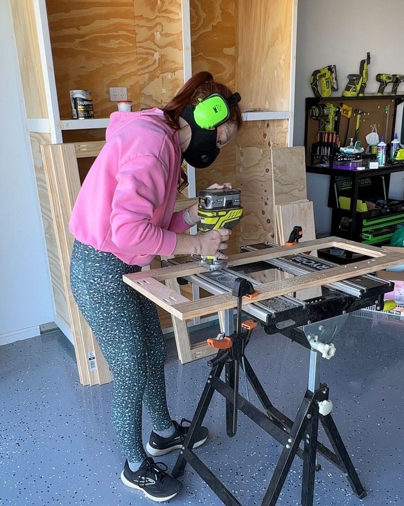

Step 6
Router the inside of the door frames using a rebate bit. Then glue and nail the 7mm ply to the inside of the door frames.

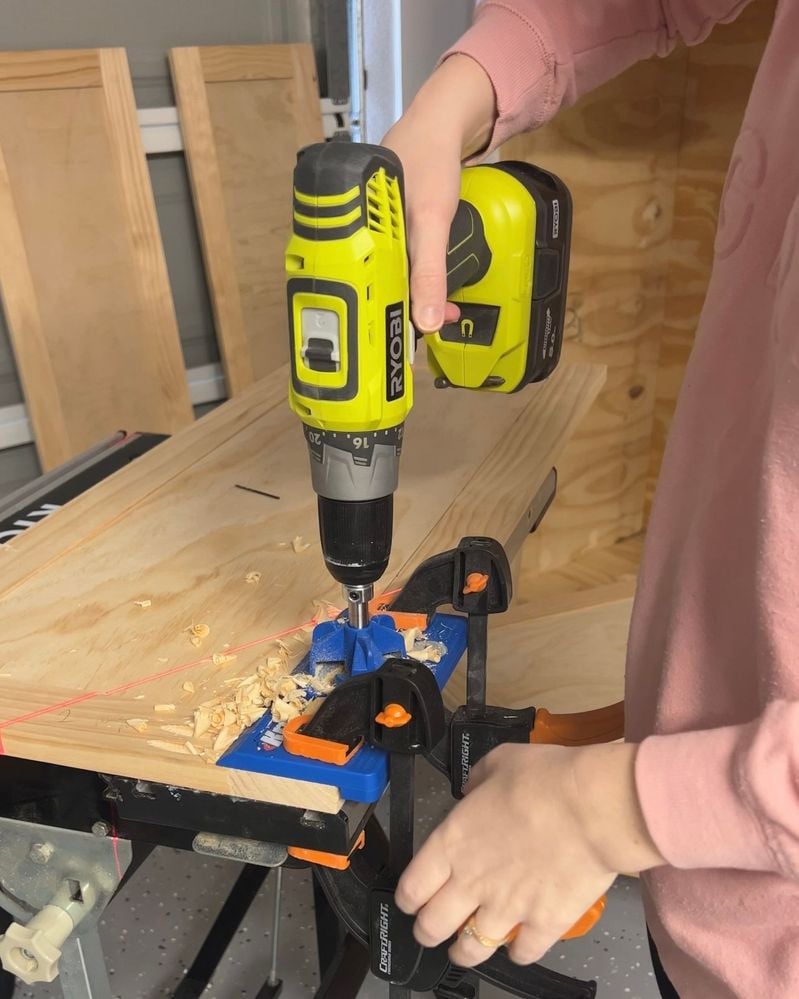

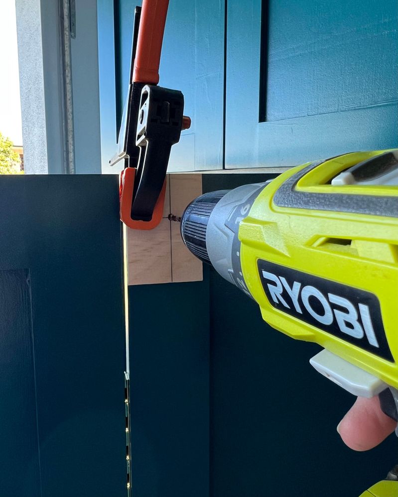

Step 7
Drill out the holes for the hinges using the Kreg Hinge Jig and then attach the hinges to the doors and then to the cupboards. If you are doing bi-fold doors you can attach the piano hinges now or after painting.

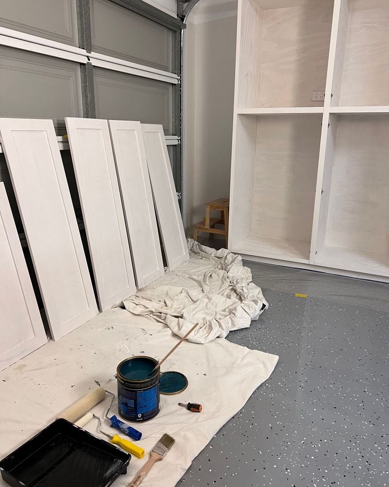

Step 8
Sand, prime and paint everything. I used a dark colour so it required a lot of coats!

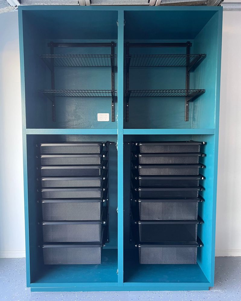

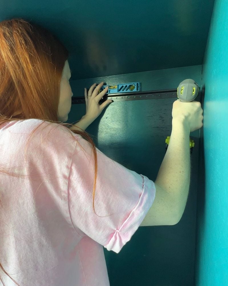

Step 9
Attach the Home Solutions to the insides of the cabinet boxes and load all of your chosen accessories. This was the easiest part!
