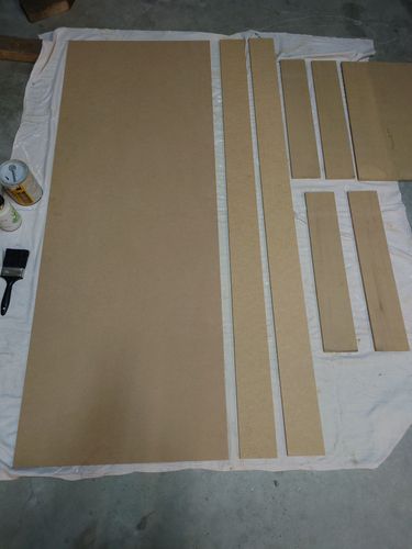

Cut the MDF board the length you wanted or ask Bunnings to cut it.
Prime the MDF boards and paint them.

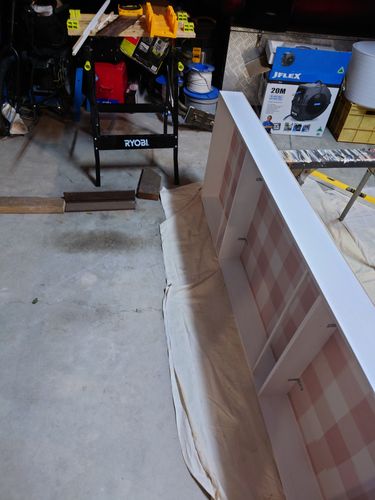

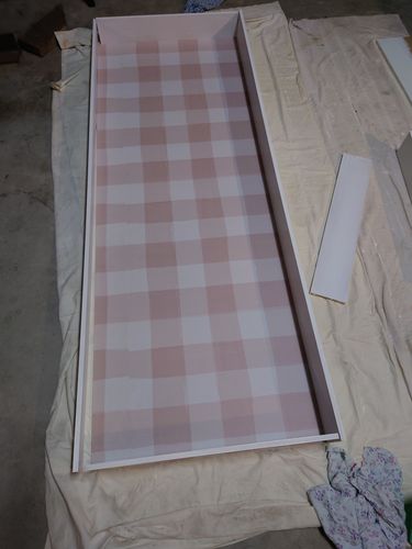

Build the outer edge of the shelf. Make sure the corners are at a 90° angle.
Attach the outer edge to the backsplash. I used liquid nails first to make sure it stays in the right place, and then flat head nails to nail to attached it to the backsplash.
Step 3
I then added the right angle brackets under the shelves and added the shelves to the backsplash. I also added pine trims to the top of the shelves so it would look better, and secure the items so they don't fall down. I added a piece of timber to the bottom to balance the weight.

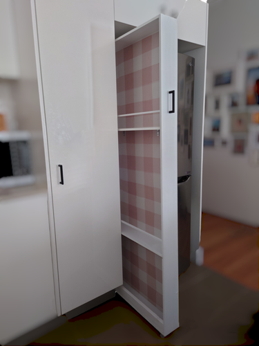

Then I caulked the edges and gave a last touch with the paint. I never caulked before and it really makes the joints look better.
Then it was time to add wheels and lift it up. One final thing was to add a handle and I was ready to carry the rolling pantry to my kitchen.
