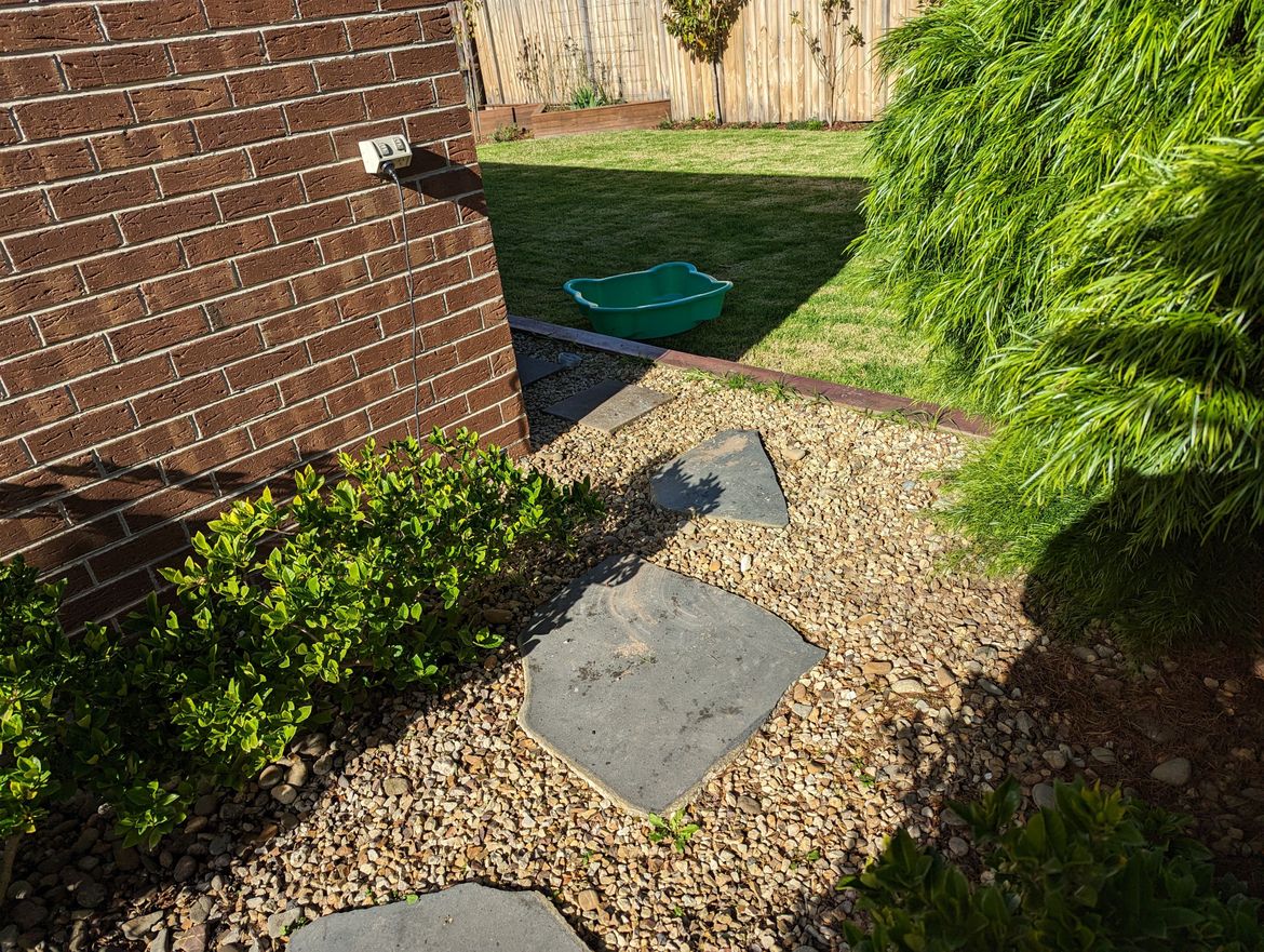

Planning
- Power source:
We had an external powersource attached to the side of the house however we had to add extra extension cables to reach the back fence
- Wifi: We were installing a smart unit so it important that it was in Wifi range to be able to control it
- Cable management: We had to run a long length from the plug to the back fence but also cross a path so we had to conceal the low voltage cable underground somehow

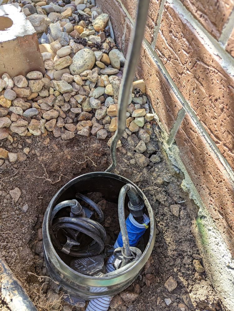

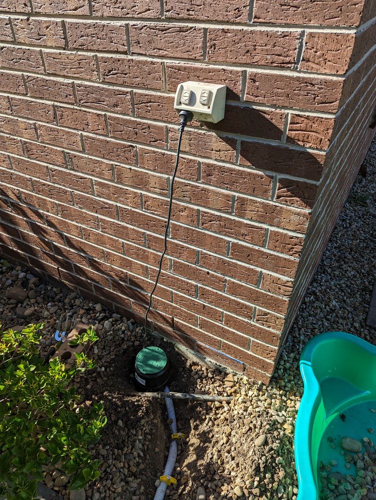

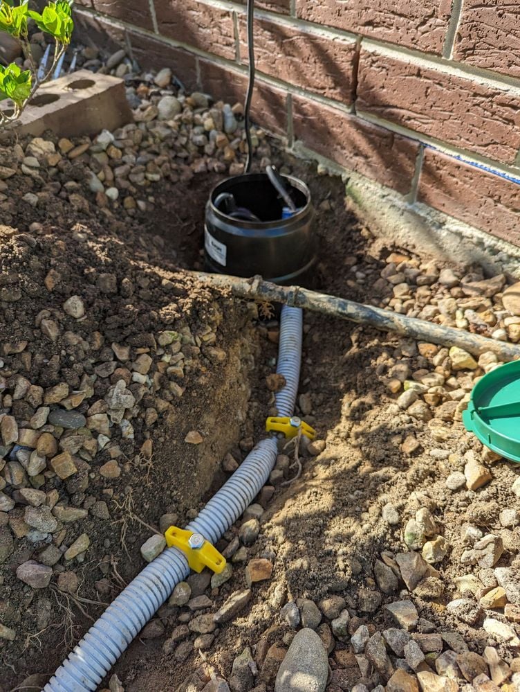

Conceal the controller
- We used valve box to house the controller
- We dug out a 15 cm hole and put the valve box in the ground
Step 3

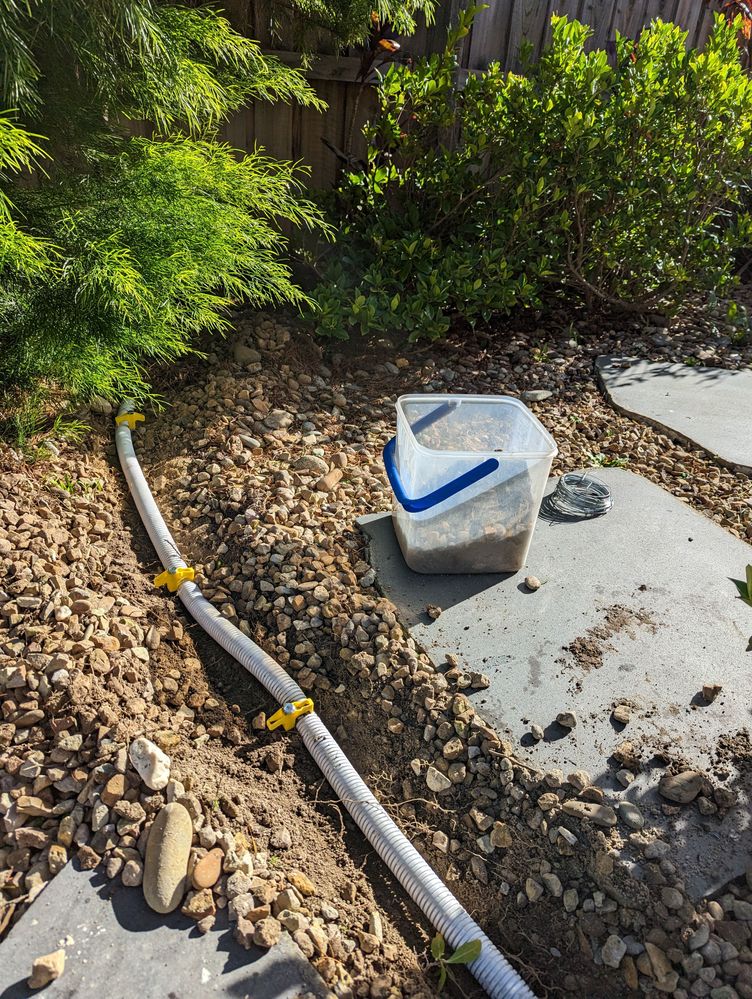

Run the cable across the path
First off be aware this is only approriate for low voltage cabling, do not bury regular power extension cords.

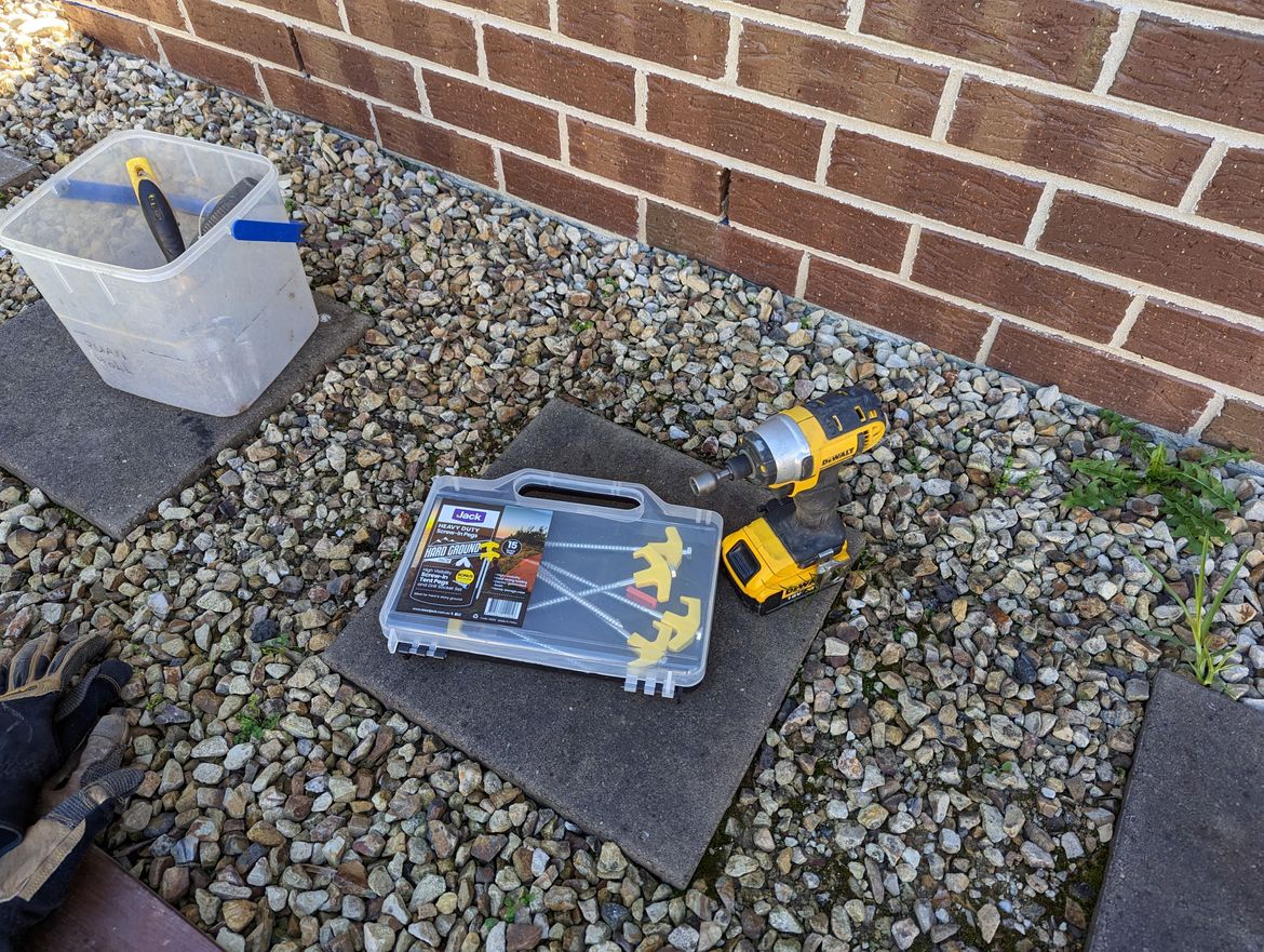

- We thread the low voltage cable through the conduit
- Excevated a shallow trench in the decorative rocks we have
- Used screw in tent pegs to secure the conduit to the ground (We found that if we didnt secure it to the ground it kept surfacing through the rocks)

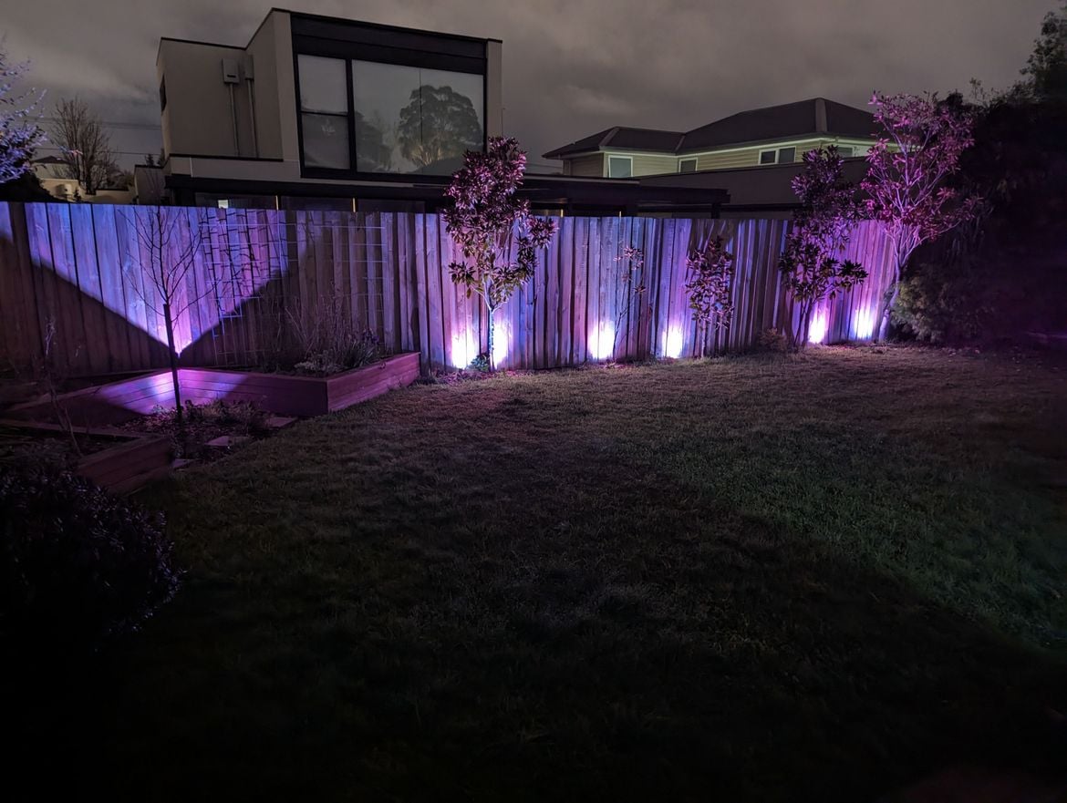

Install the lights and enjoy

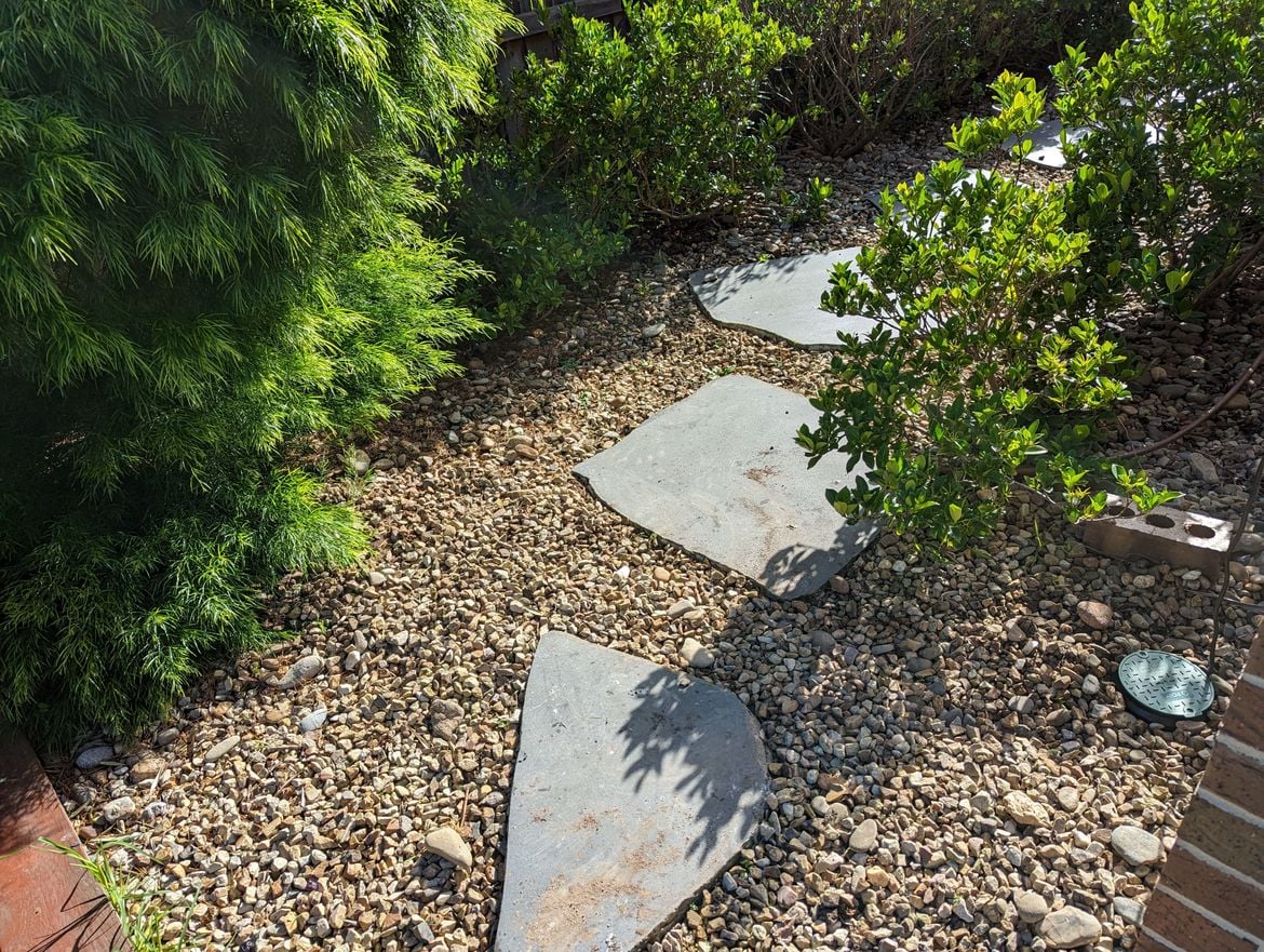

- We then closed the trench with rocks again
- Planted all of the lights along the perimeter
- Enjoy the end results
