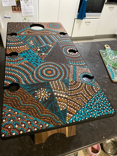

sealers for cheese wine table thats non toxic . over acrylic paint.
Thanks so much for your advice yes I did paint this myself 😊
Hello @danielle3Â
Welcome to the Bunnings Workshop community. It's wonderful to have you join us and thank you for sharing your question about sealing acrylic paint.
What a beautiful cheese board, did you paint it yourself? If you need to seal the surface of the board, I suggest using Cabot's 1L Satin Clear Benchtop Timber Finish. It's heat resistant, food safe and because it is water-based it will not turn yellow. Please note make sure not to use the sealed surface as a cutting board.
I recommend a minimum of two coats and make sure that the sealer is fully cured before you start using it.
Please make sure to wear personal protection such as gloves, goggles and a paint mask when you start painting the Cheeseboard.
