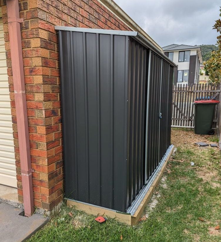

An Absco Ezislider shed assembled on top of a D.I.Y. base made with road base stones and sand topped with pavers.

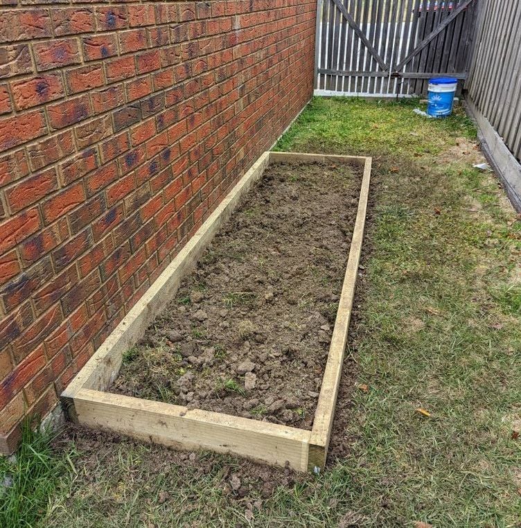

Check the specifications on the garden shed to get the correct measurements for the base and build the frame. The instructions will tell you the size of the concrete base. Place the frame where you want it to be and mark it. I used a spray paint I already had.
Step 2
Dig the area so you can bury the frame enough to make it level. I didn't go for a perfect level. I thought it might be good to have a slight angle, but not too much to a point where you feel it when you walk on it. I didn't want to dig too deep as it is next to the house concrete foundation (the garage to be exact), and I wasn't sure if this can cause any long-term issues. Given this is temporary, I was OK to go ahead with the project. But if this becomes the long-term location for the shed then I'll do a bit more research on this and maybe go with the concrete slab as well.

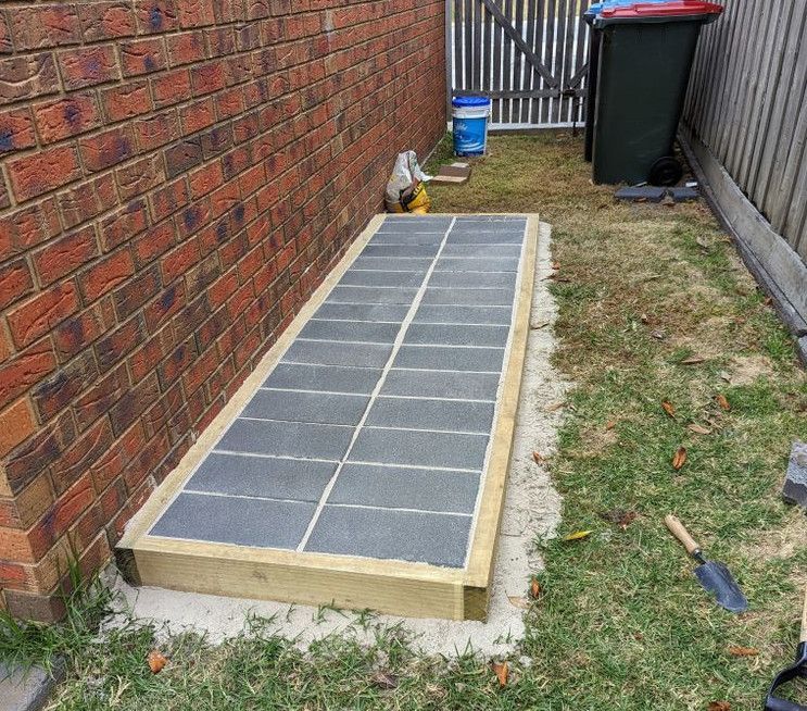

Now fill the frame with the road base. Flatten it a bit, fill in some sand, flatten it again and then lay the weed mat. Top it with a bit more road base and finish the top with the sand. This order worked for me, and I'm not sure if there is a better way to do this. I used a Trojan 205mm tamper as the area was small enough. If it was any bigger, I would rent a machine to do this.

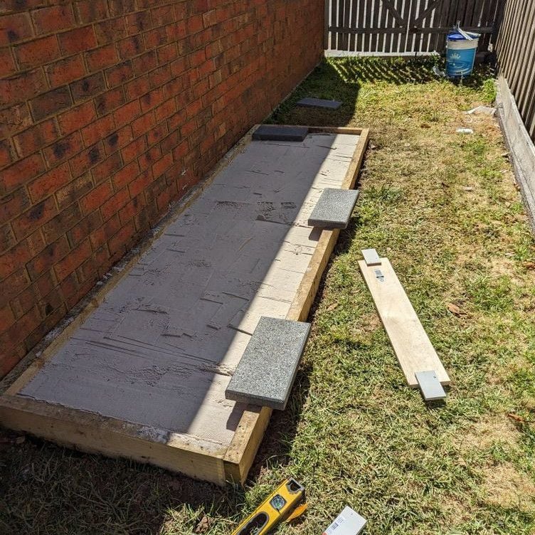

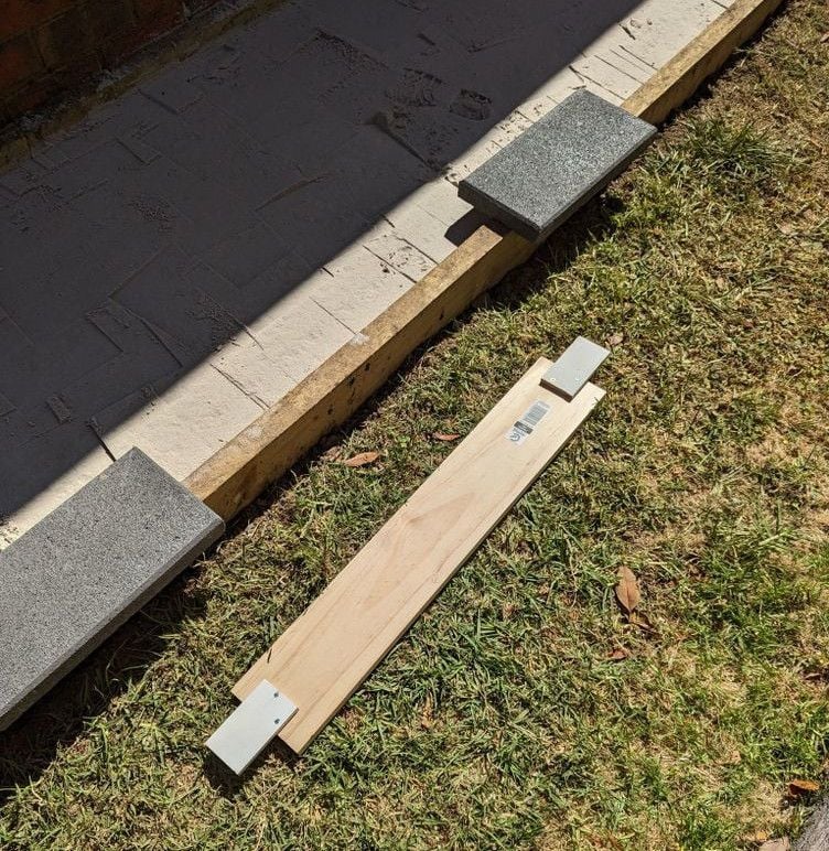

I made a quick jig to level the sand before laying the pavers. I just used three pieces of wood I had. Get a piece of wood wide enough to fit within the frame, measure the height of the paver and attach two guides to the end of the piece of wood to so it stays level with the frame. Use this to make sure you get the sand up to the correct height. I don't have exact pics on how I used it, but hopefully it's easy enough to understand.

Once the sand is filled to the correct height, you can lay the pavers and fill the gaps with sand. You might have to cut or break a few pavers to fill the space. I just used a chisel. I had to roughly mark the line and slowly hammered my way around it. It took me 30 seconds to break the paver.

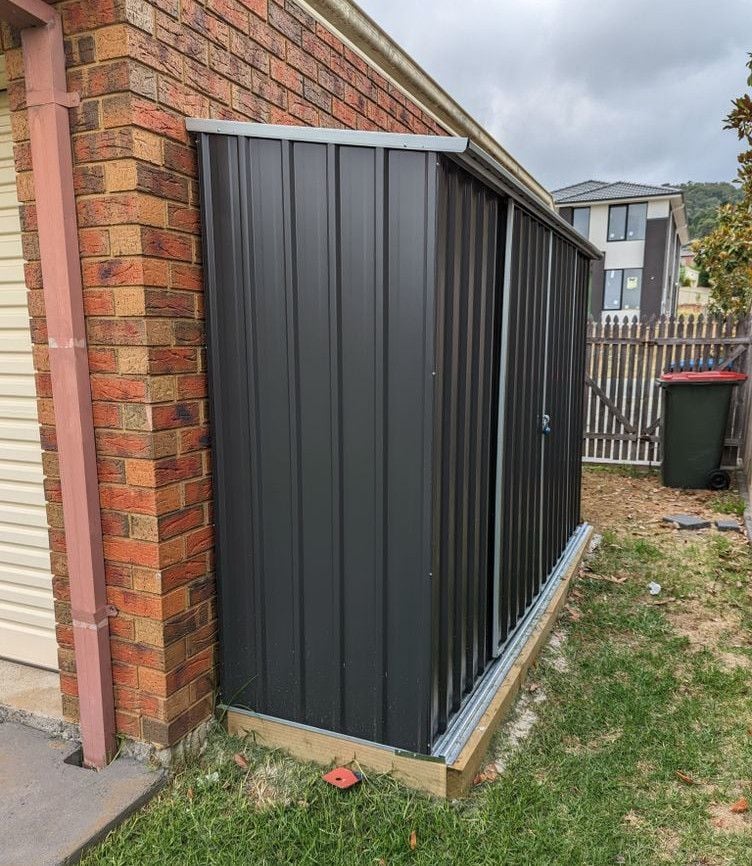

Now build the garden shed by following the guide and video, place it on top of the base and attach it. I was able to attach it directly to the wood frame.
What is left to do? I am yet to fill the gap between the wall and shed as I don't want this to be the perfect place for all the bugs in the world to live. I'm planning on filling the edge of the gap with some foam and maybe caulking. And I might give the frame a paint so it looks a bit better.
Tips
As you might have noticed, my frame has a slight bow to it, which meant the pavers didn't line up well. This is because the wood already had a slight bow, and I filled the inside of the frame before filling the outside. This meant the more I filled and compressed the sand, the worse the bow got, so next time I'll be sure the outside is filled in first, and maybe use some Pine sleeper pegs like this 50mm sleeper peg galvanised steel, before filling it in as well. To be honest, I ordered a few of these as well when I put the online order through at Bunnings, but I just decided to take a shortcut and not use them thinking it should be fine. In hindsight, I should have used them.
