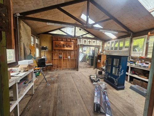

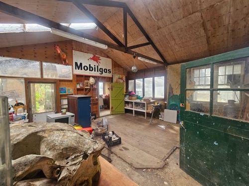

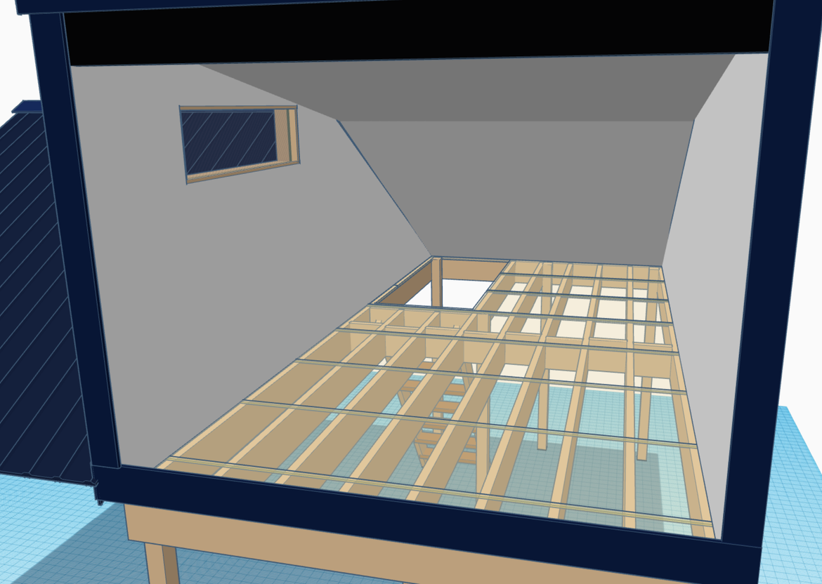

Im looking for advice on which posts to use to support an insteresting structure. I've received the opportunity to turn a 6m w x 6m l x 4.2m h, part mudbrick, part wooden structure into a dwelling. Its north facing windows are blocked by another structure. The roof is an A frame with a north and a south facing side. I want to build a loft for my bedroom, and raise a quarter of the roof up so that I can stand and look out over the structure at the property. I plan on it being slightly smaller than 3m by 3m.

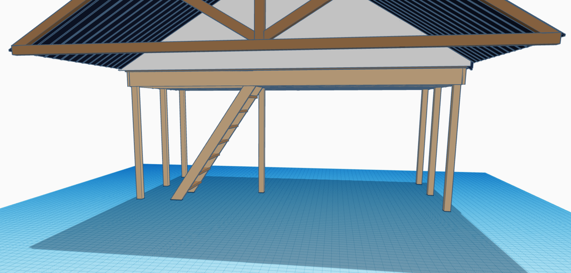

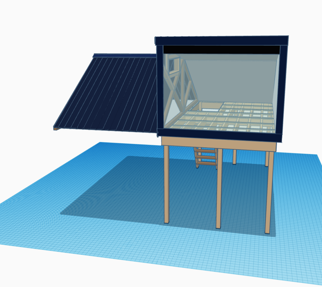

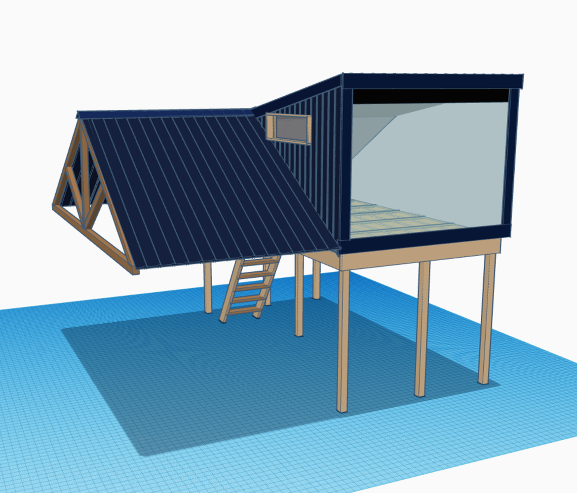

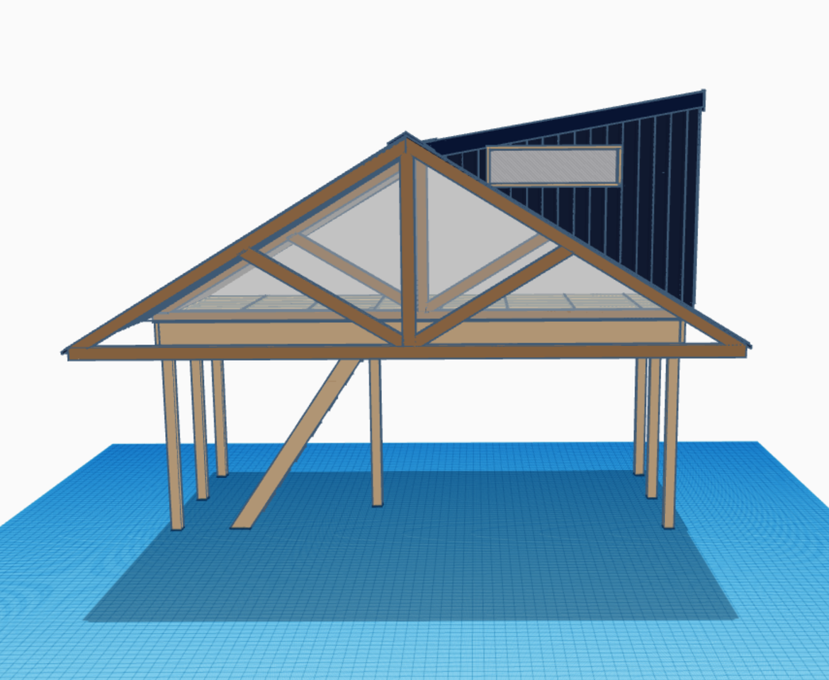

I've been told that it would be easier to just cut a 3x3 hole in the roof and build an entirely new structure including a new roof for that structure, which would sit in that hole and on the same supports that will support the loft, which I'll be connecting to the concrete slab floor (with some sort of footing or bracing?).
I can use one wall maybe as load bearing. The other three sides of the loft/structure would be held up purely by bearers (not sure if that's the right term. The big pieces of wood that I'll connect the joists to) connected to posts. I plan on using 265mm e joists with 300mm spacings. Im also hopefully going to have windows to look out of. If anybody is still with me, I'm wondering what I would need to use as posts to bear all of that load?
Thank you so much to whomever lasted all the way to the end!!! I know it was a lot but it's hard to describe without showing...
