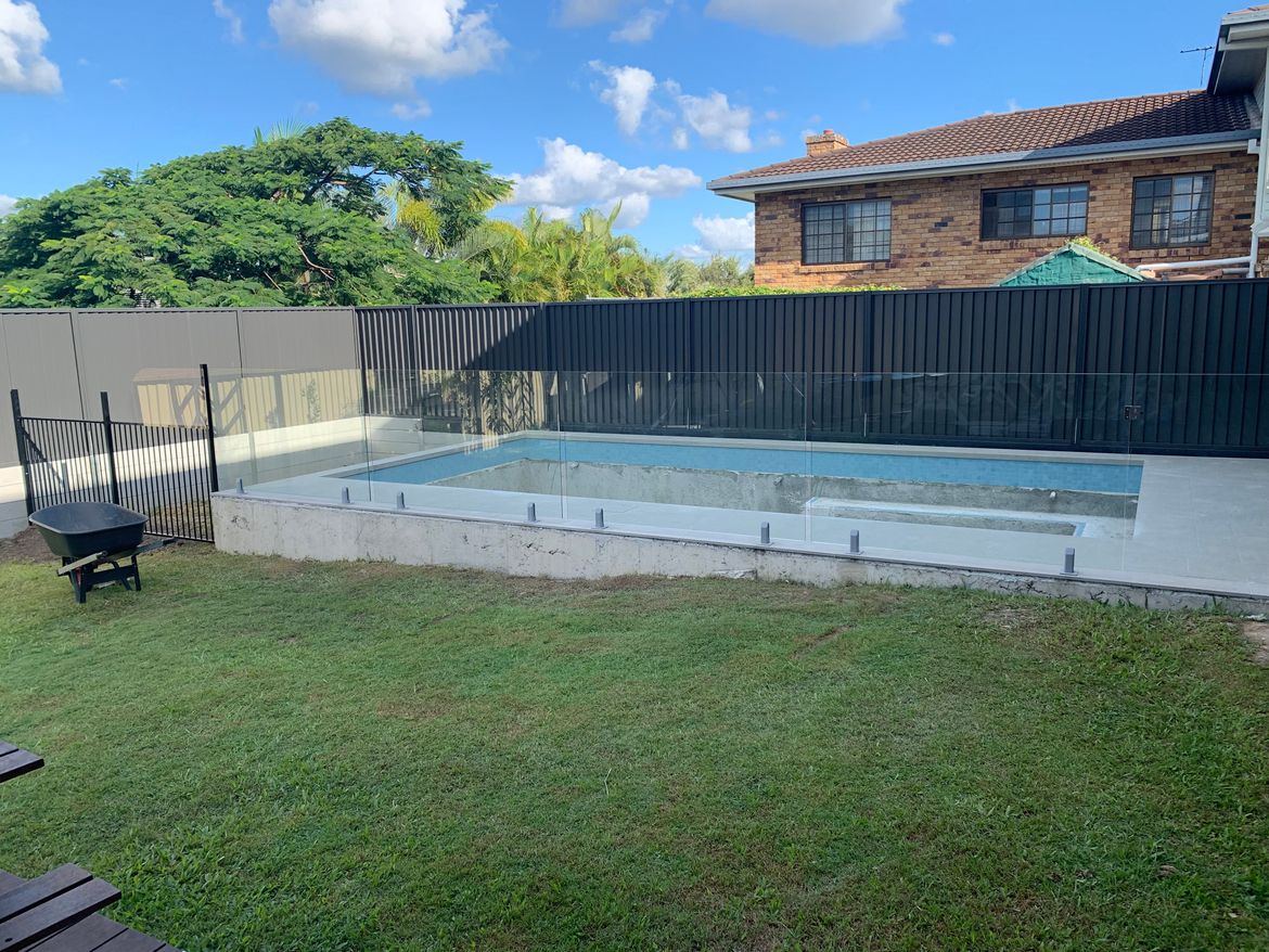

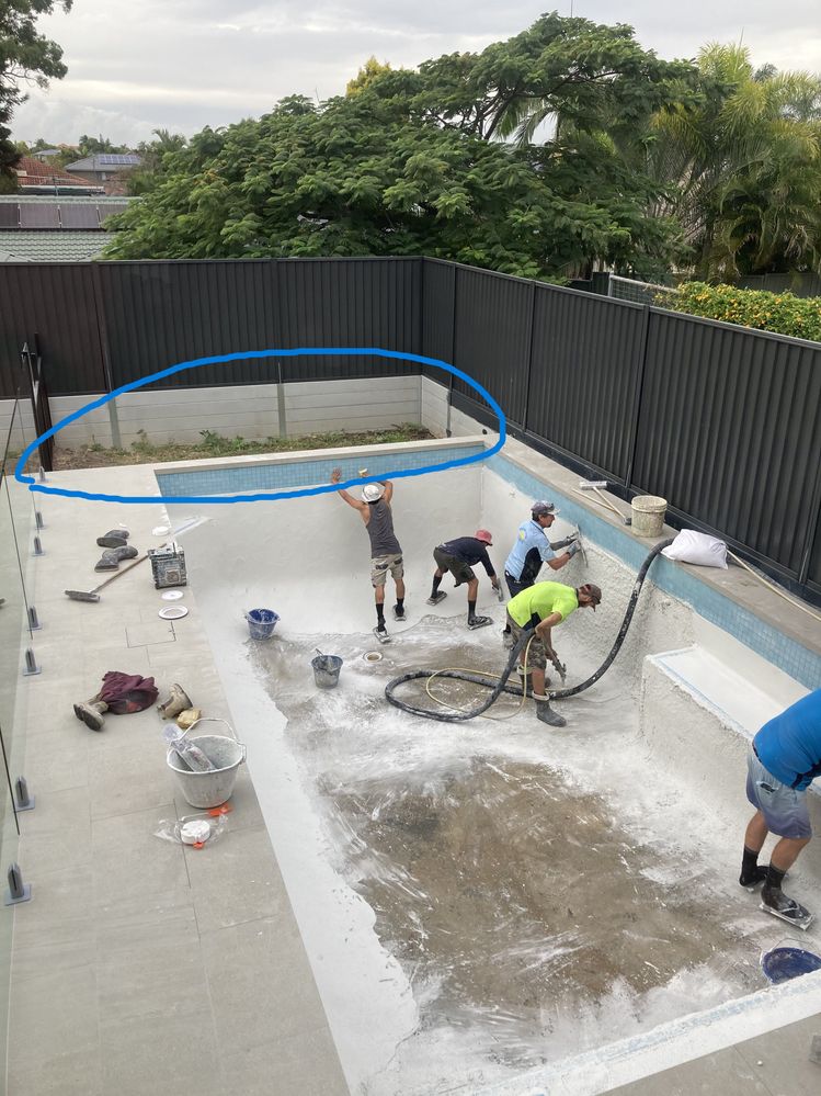

Hi I am going to build a 5m x 3m deck off the back of my pool, the pool sits about 500mm out of the ground, i will be using Ekodeck on top, any ideas on what size bearers, joists and stirrups should use and if I should bolt one of the bearers to the pool.
