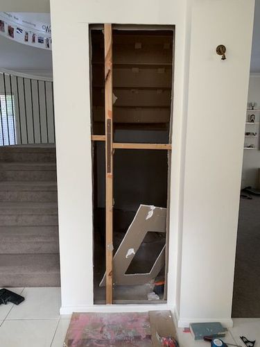

Step 1
First opened a small area of the plasterboard that I was confident to close in case it turned out to be complex one.
Step 2
Once the small area is opened assess load bearing of the studs and create necessary space to place door frame with structural pine. Double and triple do your math to include door opening, door jamb spaces as needed. Plus add 10 mm to be safe.

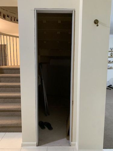

Step 3
Add door frame and door jamb. Cross check measurements to be sure that you have enough space for door plus some offset
Step 4
Add door and finish the inside with plasterboard and MDF

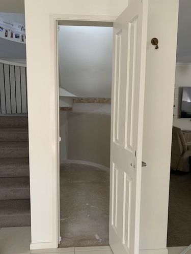

Step 6
Install smooth edge along the perimeter and lay down carpet. Install shelves.
