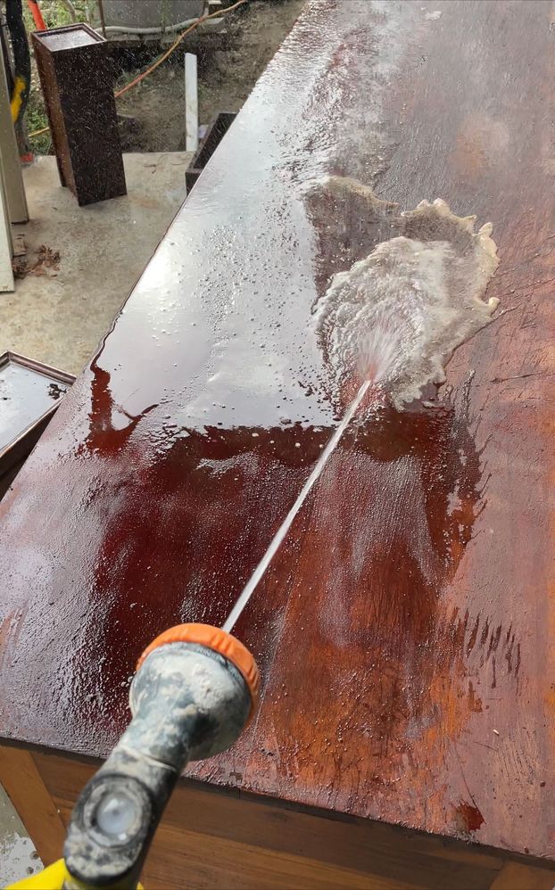

Step 1 - Cleaning
Using warm water and dish soap, wash down the cabinet, removing any dirt and impurities.

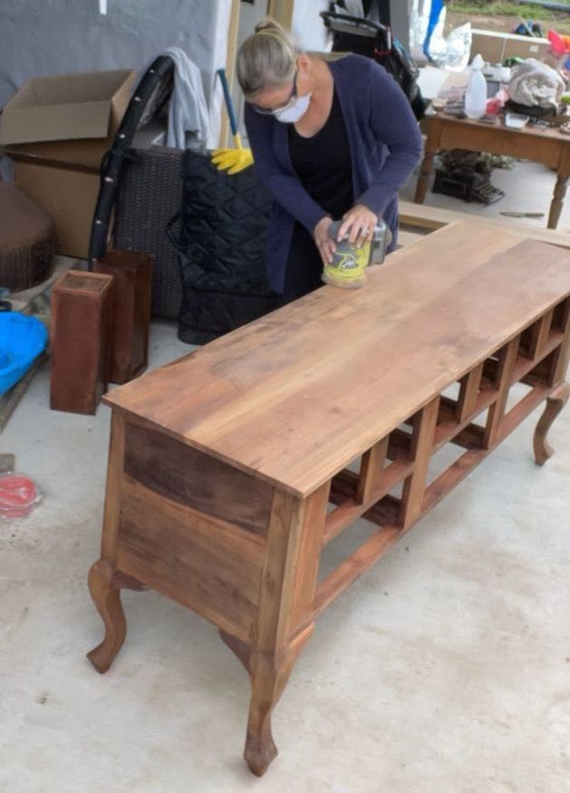

Step 2 - Sanding
For a more even finish, taking the wood raw, I would suggest giving your wood a fine sanding. I used Grit 220, a fine sanding pad. If you’re happy with the finish, you can hand sand if you’d prefer not to use a sander.

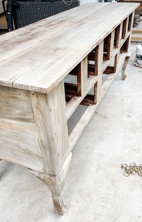

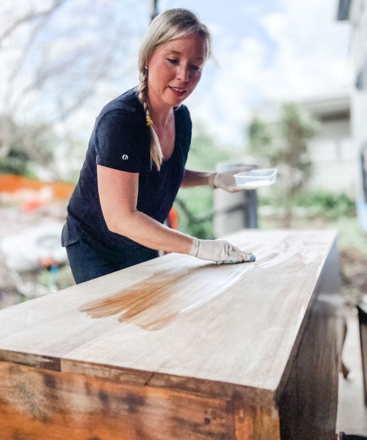

Step 3 - Bleach
I poured some household bleach into a container and using a Chux cloth I wiped down the cabinet and drawers like you would a stain. Once it’s completely dry you can see the impact of the bleach, to get the look I desired I repeated this step.
Tip: Don’t do the inside of the drawers. I did and couldn’t get a nice even finish so I ended up staining the inside a darker brown.
