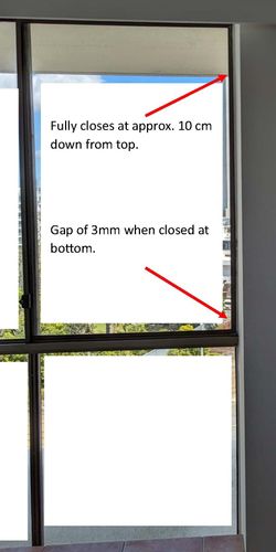

The issue I am trying to resolve is the windows whistle. For the specific window I am currently looking at, it closes fully at the top. Then at approx 10cm down a gap between the window and the frame starts to appear. At the bottom of the window that gap is 3mm wide. I would like to fill the gap, but still be able to open the window if possible.
An idea I have is to use No more Gaps. I thought I could put masking tape on the window and fill the frame part with no more gaps. I would close the window to get the correct shape of the gap filled. When it is nearly set, I will be able to open the window as the masking tape will not stick to the no more gaps. I would then clean up the edges etc and paint.
Does that make sense? I have no building experience and just try to brainstorm ideas with my basic knowledge of available products. I would love any advice on any more appropriate solutions that I can diy without removing the windows please.
View of full window.
Top of the window where it fully closes. You can see the gap starting to appear.
Bottom of window where gap is 3mm wide. You can see light through the gap.
