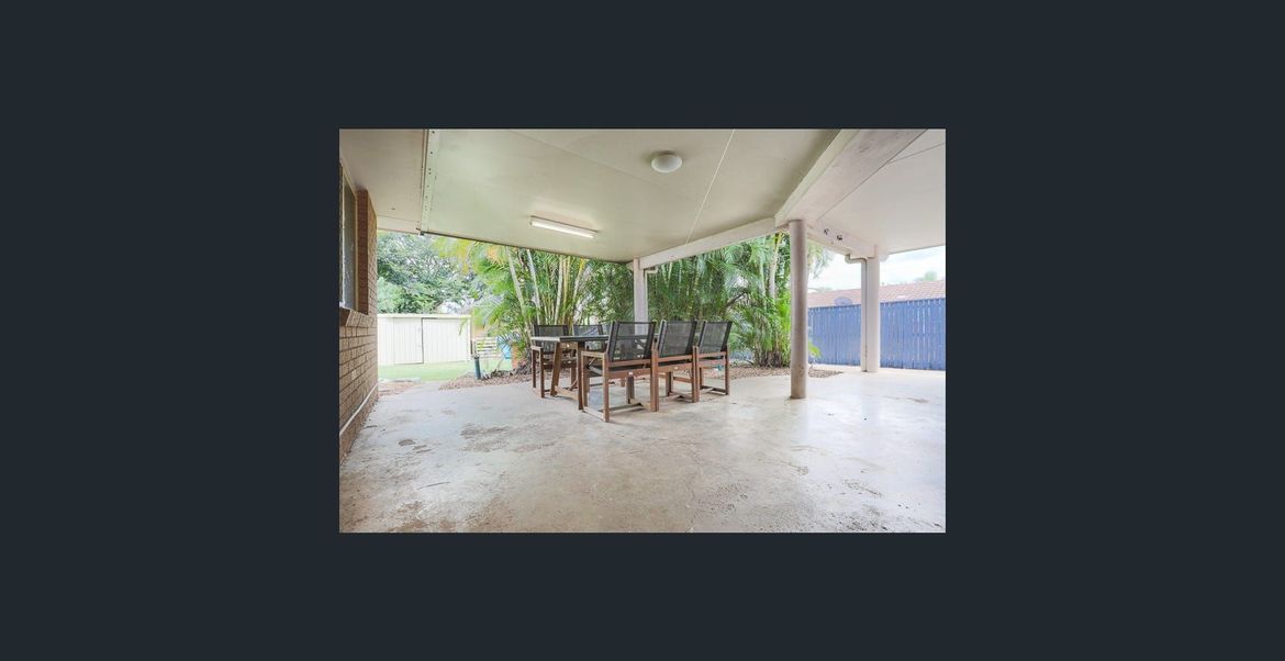

I have an old concrete slab for my outdoor patio that I want to renovate. The slab is level but cracked in a few places. I was thinking of Travertine but then thought maybe this would look ok https://www.bunnings.com.au/brighton-masonry-300-x-300-x-40mm-sand-mypave-paver_p3451558 with the advantage of easily fixable if I mess up because I can just pop in to Bunnings for more. My questions are:
Do you think it will look ok? I had in mind this colour scheme https://www.berger.com.au/inspiration/a-modern-patio-that-shines/?fbclid=IwAR1hfZrxWpG-xLVdlLMh8DO0JGw5l4RIe_VVAkKefBv6YF5jW4UocbaGutw (my patio is very old fashioned with round columns everywhere)
What would I use to lay the pavers?
What would I use as edging

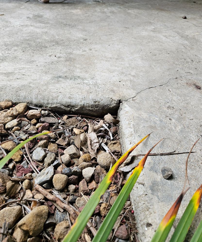

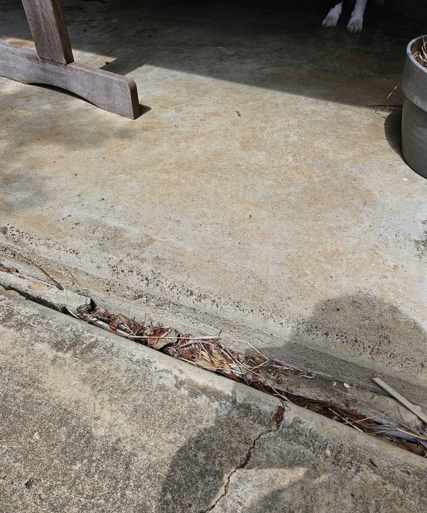

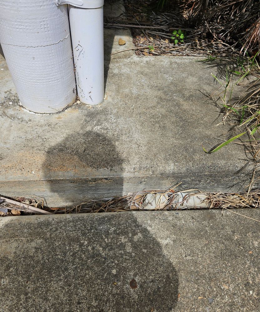

Is this an elevated slab, and how high are the edges? Perhaps you could show us an image of them.
I think in the tutorial they mortared the edging pavers in place
My slab isn't elevated it's about 120mm lower than my house floor and it's approx 200mm thick (I think) I thought maybe I'd mortar the final row of tiles but not sure how to finish it. Not sure if the pics will help - excuse my messy floor
Lower than floorEdgeEdge of slabMore views of edge
Sounds like fixing the final row in position would be a good option and should help contain the internal pavers @lakiita. The face edges of the slab could be covered with timber or painted in a similar colour to the pavers.

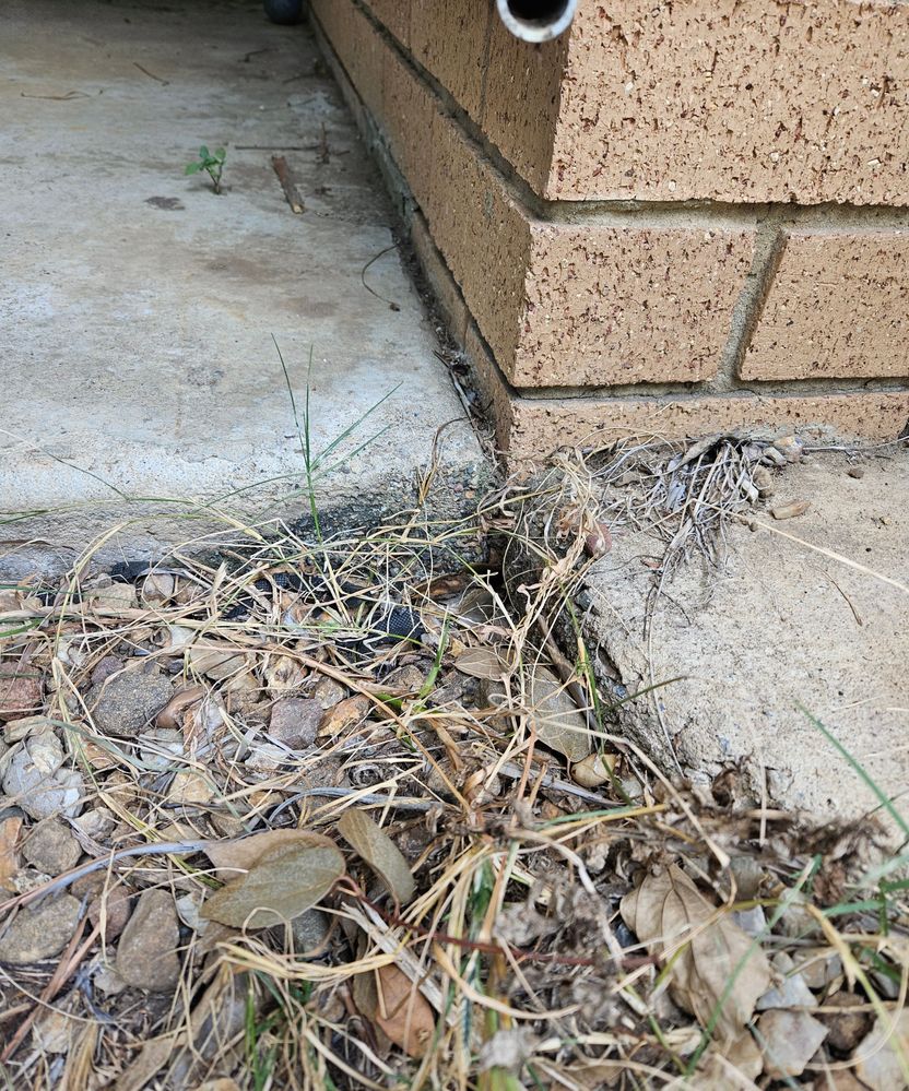

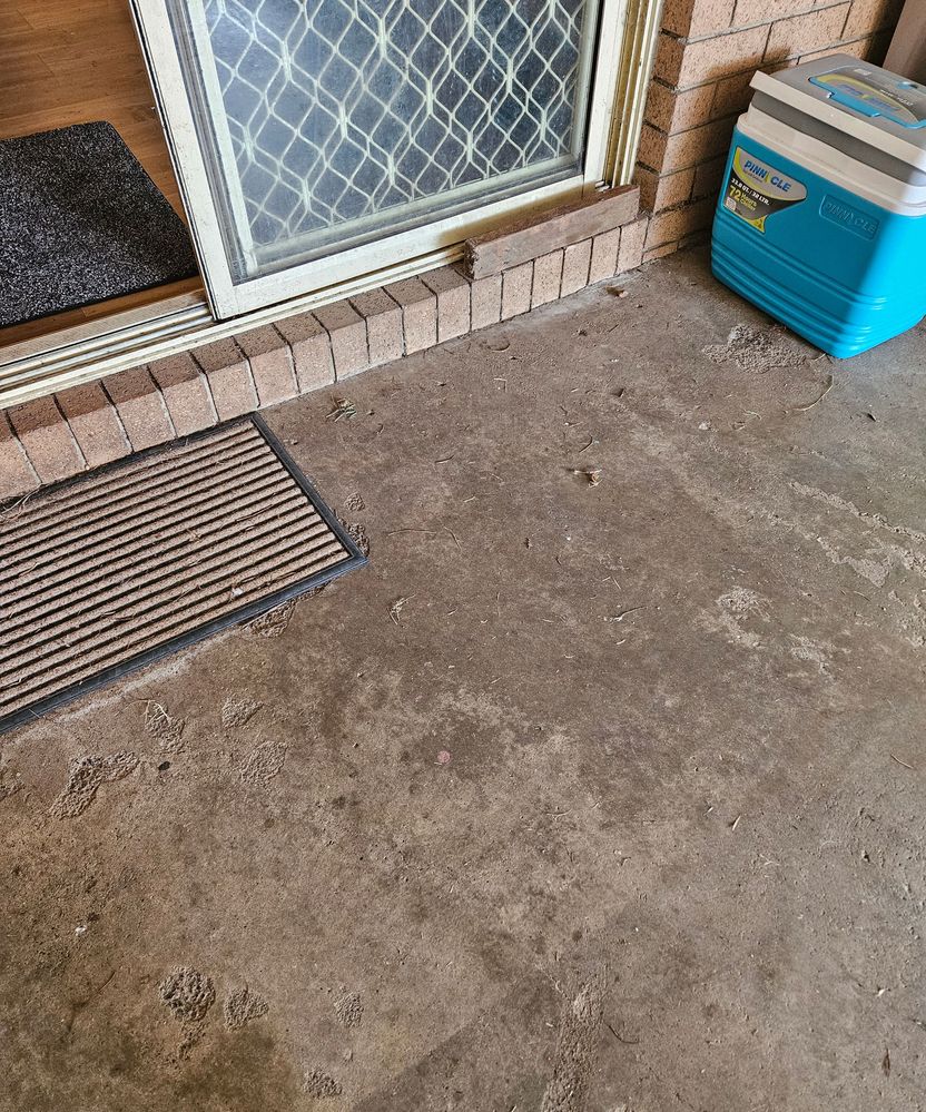

Going through looking at the photos I was wondering where your air vents for the back of the house/brickwork are? If they are above your concrete patio will they be blocked by the added height of pavers/tiles you want to use?
What the hell are air vents in brickwork???? Going to go have a look now. As it turns out went to bunnings to get some samples and I don't think my edging idea will work so now I have no idea. There's two concrete slabs one is the patio one which is kinda nice the other I'm just ignoring as it's a lost cause but also it's too close to the patio slab for me to fit in the edging that I wanted
I've placed an image below to give you an idea what the brick air vents/weep holes are and where they might possibly be located. Typically, builders place weep holes at the bottom of brick exterior walls. They look like vertical gaps in the mortar joints between bricks. As gravity pulls water down to the bottom of the wall, the weep holes allow water to exit just above the foundation.
Have you considered perhaps tiling the surface instead? If you are thinking about changing the look of the surface, tiling it would be the straightforward solution. But if you're after a more natural material, I recommend thinking about installing a low-level deck. It's comfy to walk on and keeps a nice even temperature even when the seasons change.
🙂lol they are nothing usually to think of twice. Some houses have air vents in teh brick work to allow ventilation of the underneath of the house. These are just vertical slots usually around the last course of bricks near the floor level. Think normal space of briscks next to each other and then a gap of 1cm then brick and another gap of 1cm. These are spaced around the house for ventilation. If you dont have them then no worries.
You can see the airvents on the walls in these photos. They are just below the floor level.

I'm still confused on how to edge the area
4 major issues:
1. there is not much space between the slab I'm paving/ tiling and the slab I'm ignoring so now i have no idea how to edge it. I kinda think now I should just use some kind of aluminium edging just to cover over the edge? I don't know
