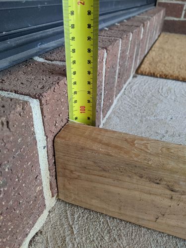

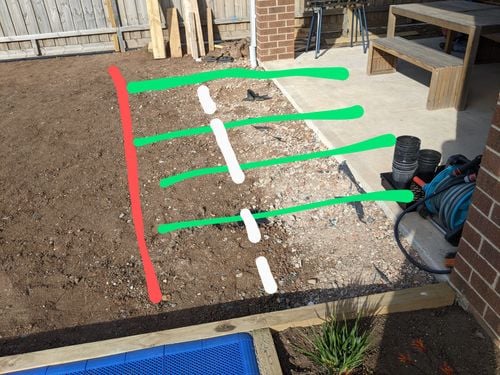

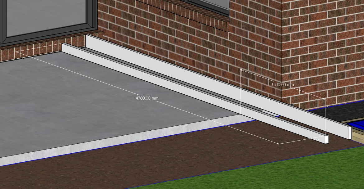

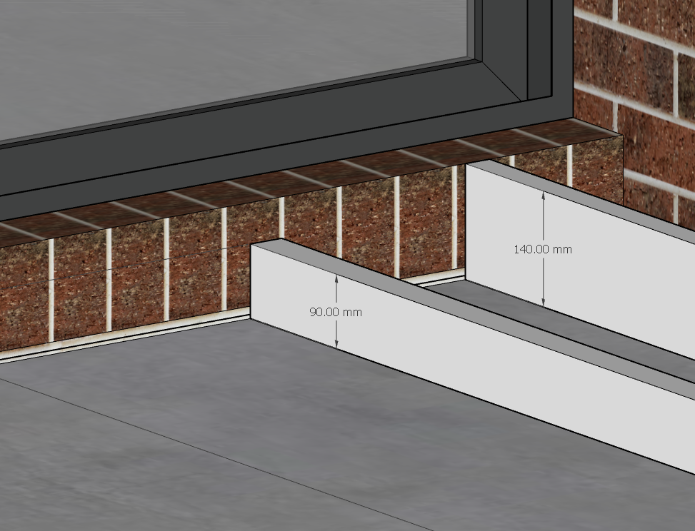

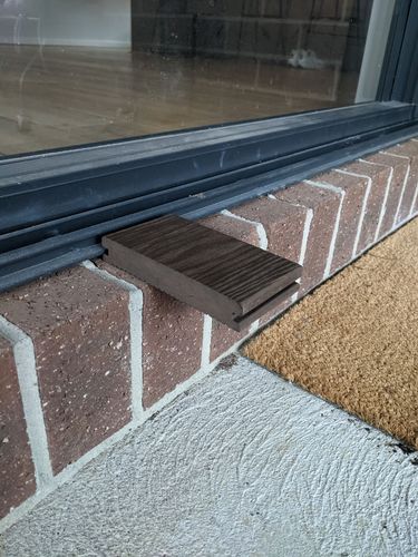

I have an alfresco area which I'd like to deck. The joists (Green lines) will most probably fix straight into the concrete and ideally, I'd like to go 1500mm beyond the concrete (Red line). I have a storm water pipe (White line) about 800mm out from the concrete. 800mm out from the concrete, the ground is at its lowest point, which is about 200mm lower than the alfresco. With regards to the footings and bearers, what are my options?
