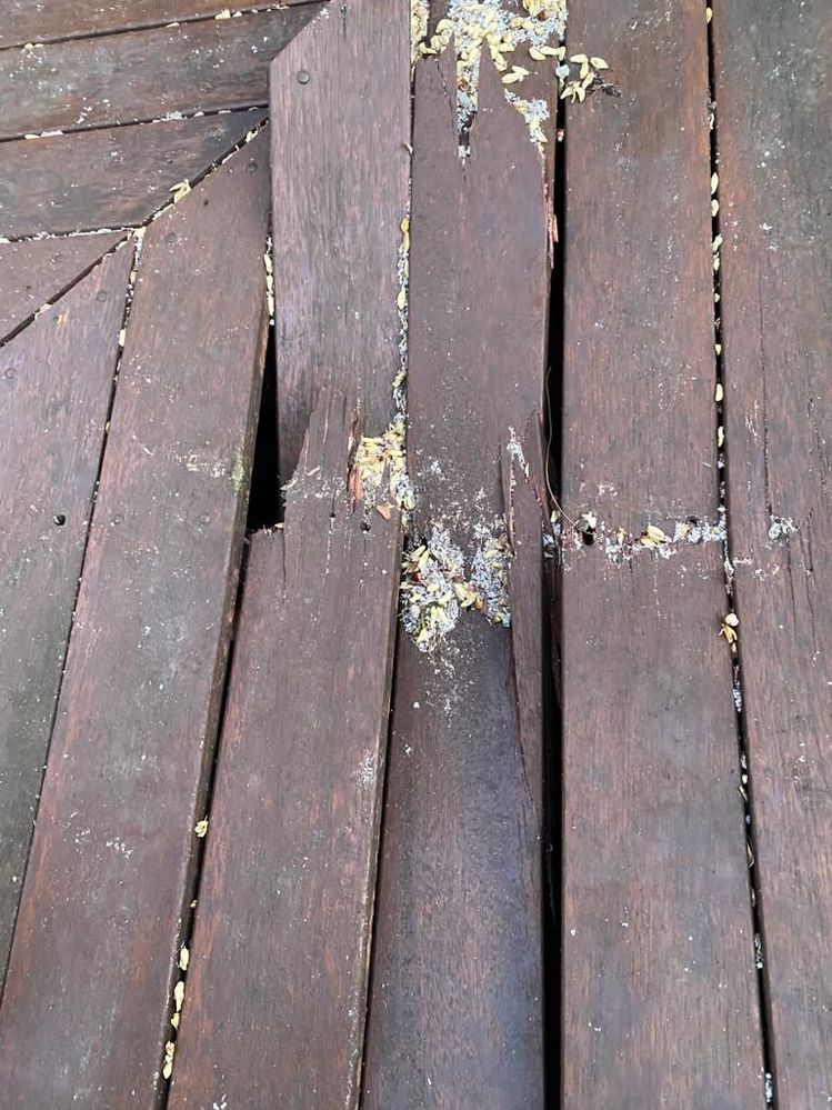

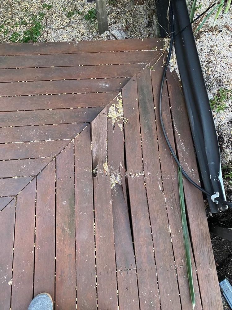

I'm trying to fix this broken decking. New to this work but keen to get it done myself. Can someone suggests details on how I could get this done or resources.
Thanks you!
Hi @pes,
Good on you for giving this project a go. Unfortunately, I suspect there will be some damaged structural elements to the deck, and the repair will be significantly more than just replacing decking boards, which can be done by just about anyone. See how the boards have snapped right where they are nailed? They would have been fixed into a joist that runs perpendicular to them. Since they snapped at that point and not in between joists, it indicates to me that the joist has likely decayed, requiring all the boards to be pulled off in this area and the joist replaced. At the same time, you'll need to assess the rest of the deck for similar issues.
It's a bit hard to tell from the images, but how high off the ground is this deck? I presume it's relatively low-level, but be careful, as if the deck joists have failed, the entire area could collapse. It's best to call in the professionals if it is an elevated deck.
If it's a low-level deck, you can start by removing those broken boards so we can have a better look at what's going on underneath. Post some pictures when you do. A wrecking bar will come in handy when pulling the boards up.
