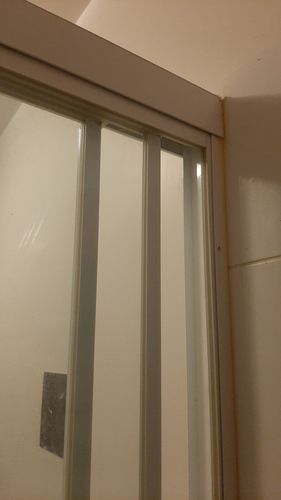

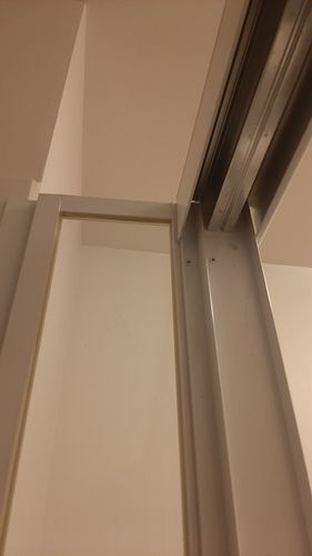

Wanting to change/upgrade the door to something that's easier to clean/more fictional, there is also a toilet on the right. Current one slides to the left.
Hello @LoupAbs
Welcome to the Bunnings Workshop community. It's marvellous to have you join us, and thank you for sharing your question about changing your shower door.
I can only recommend a shower door such as the Estilo 900 x 1830mm Chrome Adjustable Framed Shower Screen - Front Only. As for the return, I suggest engaging the services of an aluminium and glazing specialist who can build you that small return in the corner of your shower.
The other options that come to mind are building a small false wall so that it is in line with your shower tray. This will allow you to install an ordinary shower door without having to have a small aluminium return built. You can also recess the shower door to the shorter wall. However, this will have the effect of making your shower smaller and misalign with your tray.
Let me call on our experienced members @redbournreno and @homeinmelbourne for their recommendations.
