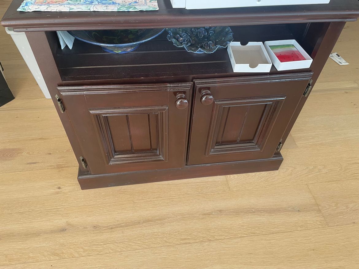

What paint could I use to paint this cabinet white or make it look a lighter brown (like the colour of the floor)?

Good afternoon @achandra100
I am actually looking forward to what you do with the unit. I am completly amazed at peoples projects for upcycling an older piece of furniture in here.
I'd probarly start with painting an undercoat of white and then go from there.

Hello @achandra100
Thank you for sharing your question about how to paint your cabinet. What a fantastic opportunity to stretch your upcycling skills! Your floor looks very close to a natural finish. I suggest sanding down the furniture and removing the paint that's currently on it. You'll then be able to see the type of timber you're dealing with. I suggest using an electric sander to expedite the sanding process.
If it is dark coloured, it might be possible whitewashing it with Liming White. But if it is light coloured, I propose using Cabothane Clear water-based timber varnish.
