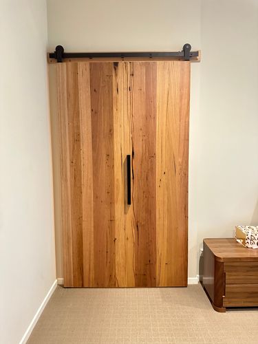

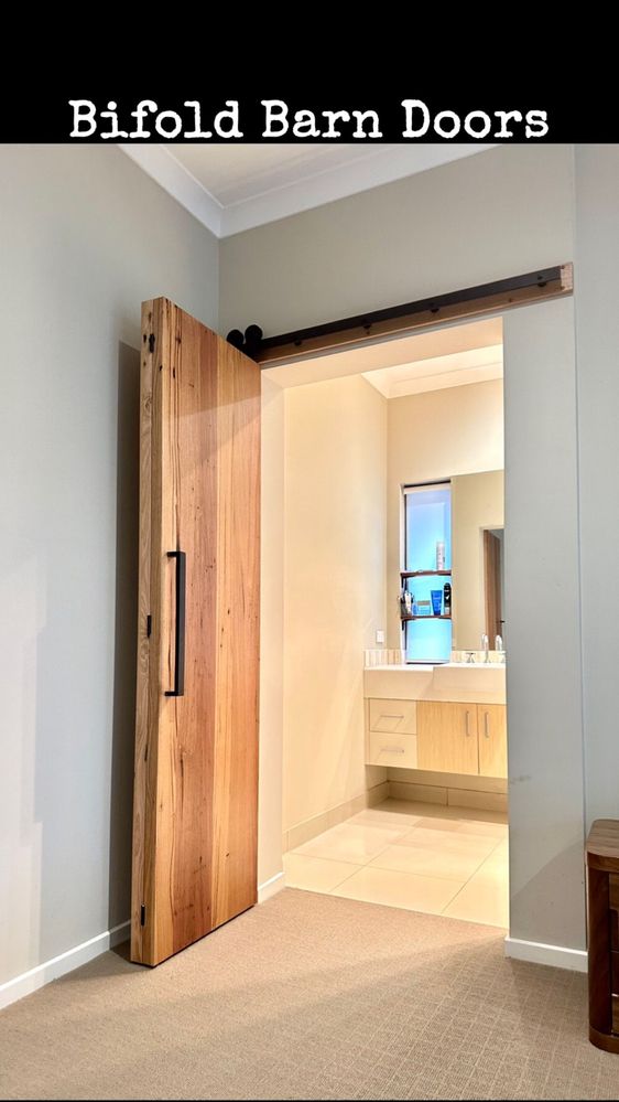

I custom built these beautiful recycled hardwood bifold barn doors to make this small space functional. The two doors are have hinges in the middle and have one barndoor roller on each end at the top which all work together for the doors to open up and slide across.

Wow! That is a nice door you have built 🙂 How do you stop it wanting to pivit at the top? I was trying to figure it out and the only thing I could come up with is another rail at the bottom to lock the doors in. I think I must be missing something.
Any chance you have some more photos of the installing side of it?
thanks @Dave-1
there is a Pivot Pin which is secured to the ground on the bottom left door.
I do have a video of it opening up which is really cool, but it didn't let me download it. I will try again and see how it goes

Now that makes sense! I was staring at it, trying to nut it out and my brain was just a bunch of ??? lol

Thanks for sharing your question about the bi-fold barn doors. Let me tag @LePallet to make them aware of your questions. It is a very interesting assembly as he mentioned that there is a pivoting pin on the bottom of the left door. The more I think about it the more impressed I am as I can't picture how the pin was installed in the door itself. Perhaps they'll have more assembly pictures to share.

I love this look @LePallet. I didn’t know that you could do a bi-fold brand door like that! Do the rollers swivel to be rolled like that? I wish you were in WA to build me some too!
