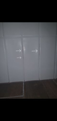

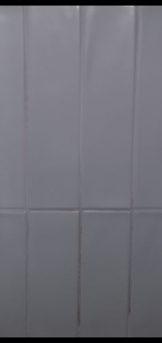

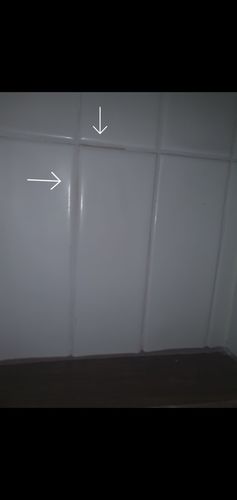

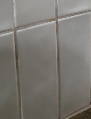

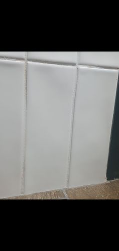

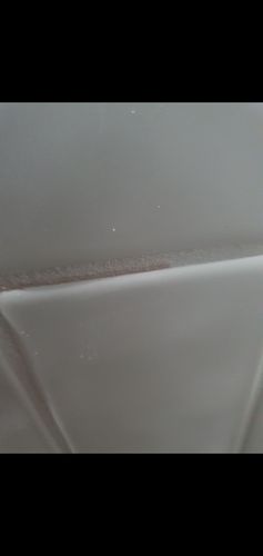

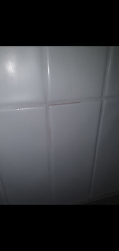

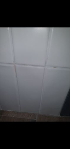

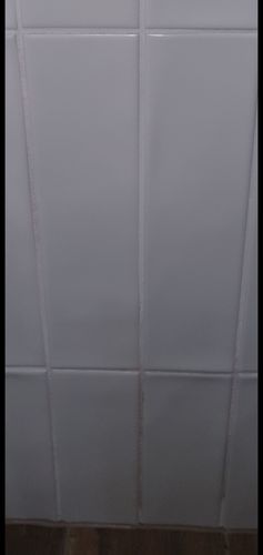

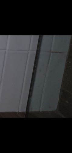

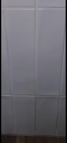

Anyone ever experienced ink from a tile cut mark seeping through grout? Issue started within days of bathroom being retiled 2 years ago. Within a few days we noticed red/pink spots appearing in grout. Tiler came back a couple of times to fix the issue. He claimed it was from his Red Pen that he had used to mark the tile cuts! Fast forward to now and the issue got to the point we could no longer ignore. Today he regrouted...5hours later and some of the red ink has began to seep through...AGAIN! I'm assuming the wet grout has absorbed the ink the remained on the back/side of the tile (ceramic). He did say that some of it was possibly from certain shower products etc...? HOWEVER, we haven't used the shower yet due to the wet grout and its already starting to appear again😭 He mentioned today that IF the regrouting didn't solve the issue we would have to rip down the tile and start again!!! Anyone have any other possible solutions? He tried a white paint permanent marker when the issue first began but it didn't last. Anyone ever experience an issue like this? Any tilers know of this issue? Since its already starting to reappear I'm assuming it's not from any products we use etc. I'm unsure if I'd be up for the retiling costs?
Last 6 photos are from today AFTER regrouting....
