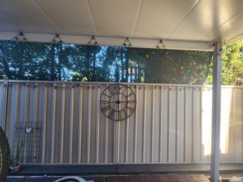

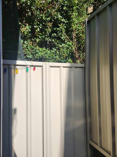

I think I understand what you mean now. I was planning to place the panel sitting on top of the fence railing but with your suggestion to screw it direclty on the fence, that means the panel needs to be placed beside the top railing.
I've uploaded a photo to the fence I'm planning to attach it to. My problem is there is an extra 610mm fence on the right which will not be covered. I can probably use 3x1800 panels but that means a panel will only be attached to one leg. Would that be recommended?
I suggest thinking about other mounting possibilities for the right-hand side of the fence. Would it be possible to anchor the extension post to the taller fence post on the right so that the panel will be secure. Can the panel be installed off centre so that it will still be supported by two posts? You'll see in the installation video that there is an offset installation technique so that the panels are supporting one another even if the extension posts are not centred to the installation.
My other suggestion is to use angle brackets if possible so that you can anchor the end of the extension to the taller post. I propose drawing up a plan on paper so that you'll see where the panels connect and where the extension posts will be positioned. This will also allow you to explore the possibilities of how to anchor the end of the panel to the taller post. This will also let you know if you'll need an extra panel and if it needs to be cut down to cover any gaps.
It's important that the panels be supported by two posts. A single post will not be enough on a single panel.
