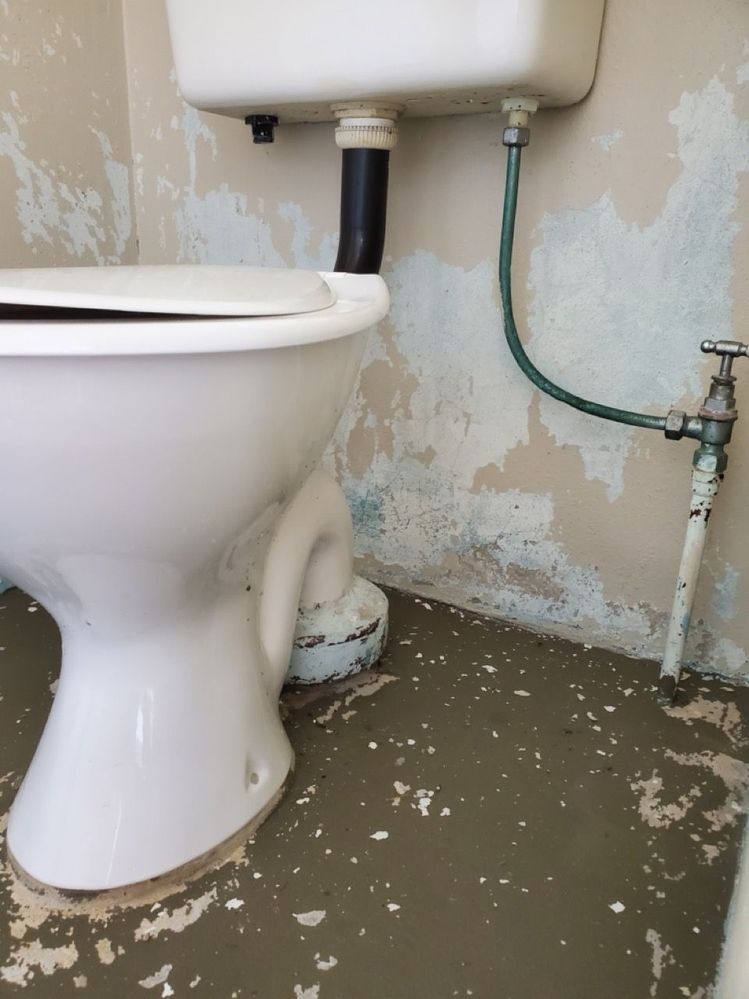

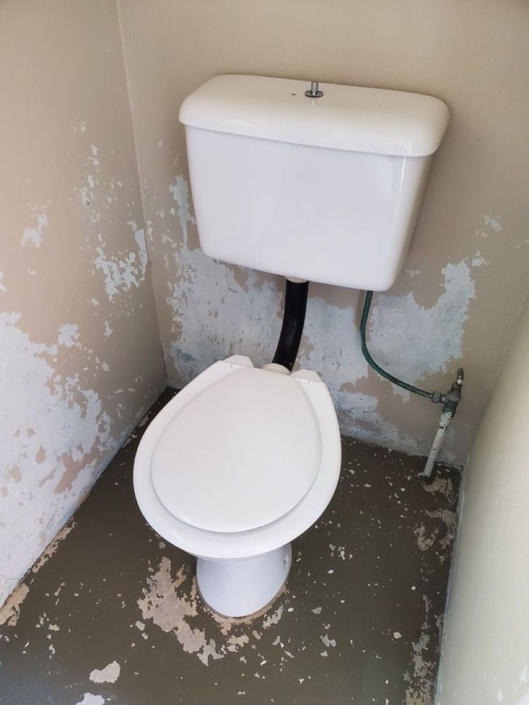

We are replacing an existing toilet with a Caroma Profile 5 with integrated washbasin.
The existing outlet position means the Caroma will have to be 40mm out from the existing wall.

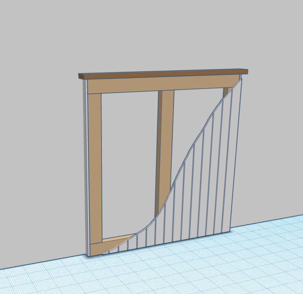

So I'd like to support it with a 40mm deep false wall, about as high as the toilet, topped with a narrow shelf level with the washbasin.
Because of the washbasin, everything will have to be waterproof.
I'm thinking of wet area VJ board, but not committed to that idea.

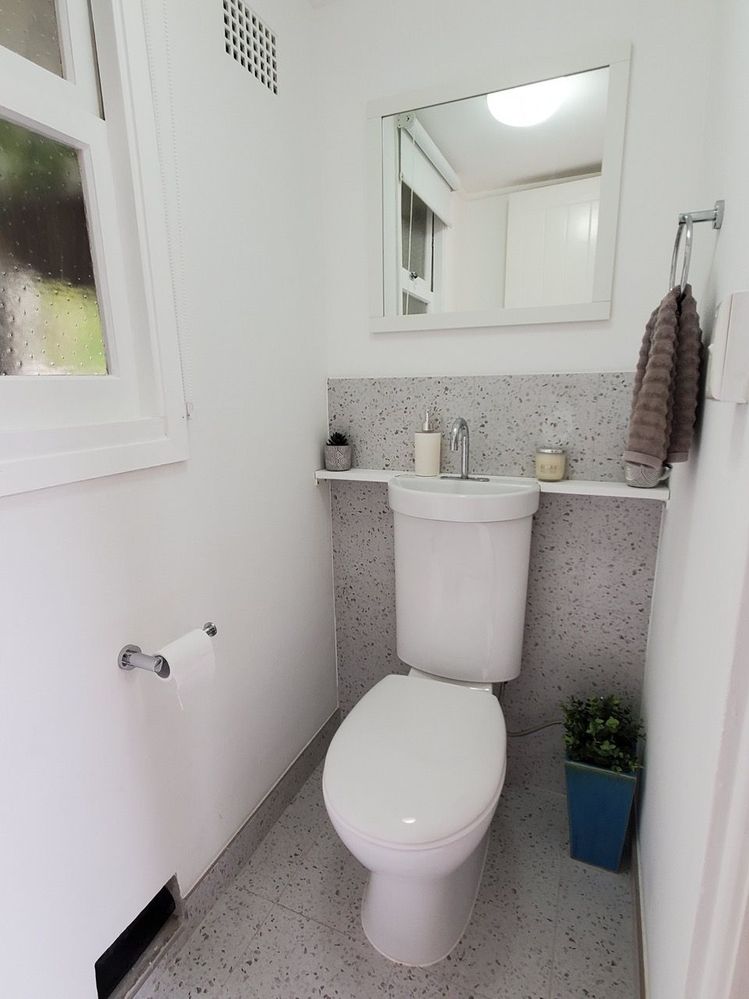

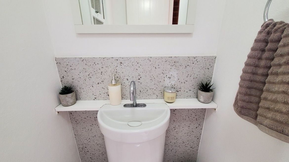

I imagine it looking a bit like this project.
The dimensions are 40 deep, 900 wide, ~935 high (the approximate height of the toilet).
