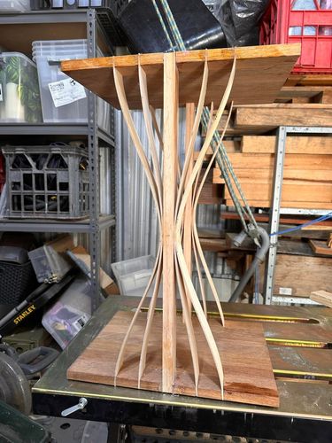

I just made this little side table, from 3mm Plywood Pine Premium and 42X19 DAR Pine and a Merbau panel.
It was a nice little project and it is all just glued together.

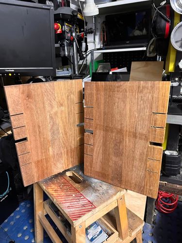

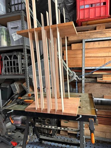

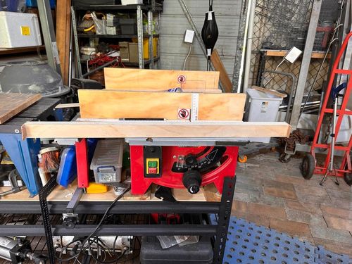

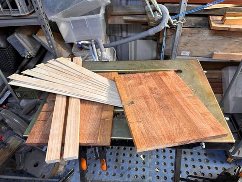

I use my table saw for the strips I just glued a block on the end so I could sand them
all together as one piece so that they would be all the same.

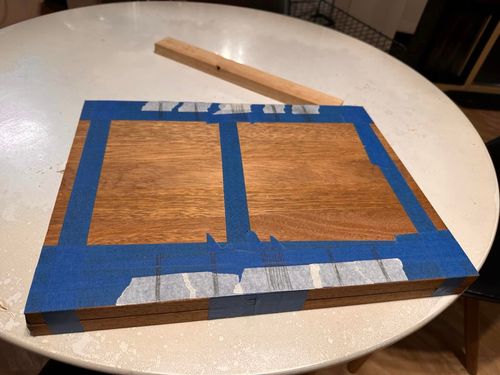

I also use the table saw to cut the top and the bottom Merbau panel together so they would match up.

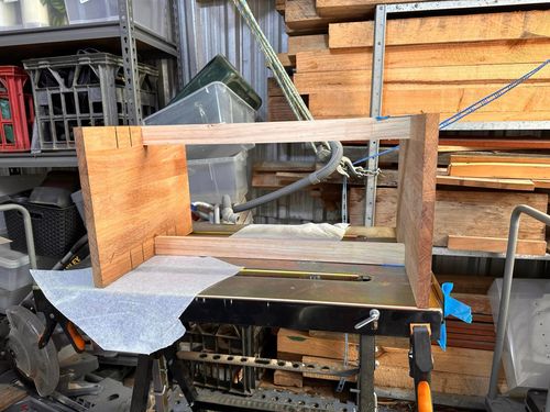

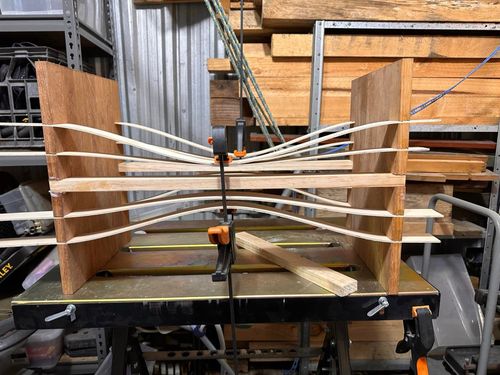

I just used a clamp to bend the ply wood and use a router to finish the top and bottom and add 4 little feet underneath
