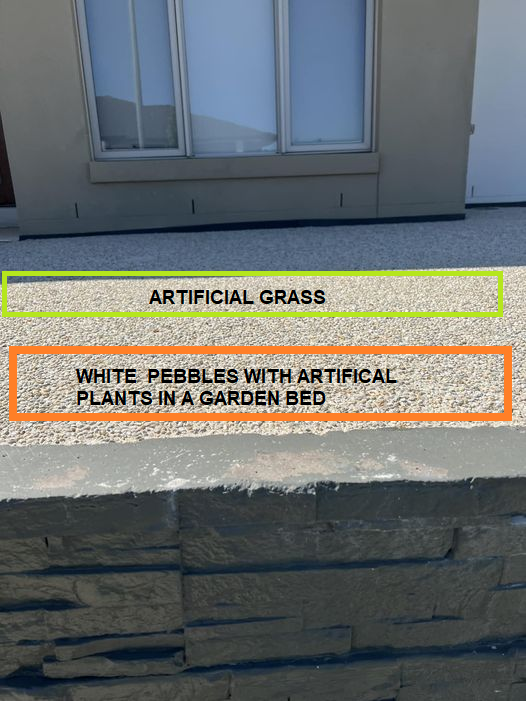

Welcome to the Bunnings Workshop community @srinivasindra. It's great to have you join us, and many thanks for your question about installing artificial turf.The short answer is that yes, you could install artificial turf over the aggregate if you wanted to. However, artificial turf is designed to be laid over permeable ground, like sand or soil. Here's the installation guide. Things to consider with laying the turf over a non-permeable surface would be that you might have water drainage issues, the turf will be hard underfoot, and you won't be able to use the turf pegs to hold it in position.Please let me know if you have any questions.Mitchell
Hi MitchellMC
Thanks for responding to my query, cant we use any specific adhesive to stick the atrifical grass on the aggregate instead of pegs
You can certainly use a sythetic turf adhesive @Ceva. Please be aware that if you were to ever remove the turf, the adhesive would be extremely difficult to remove from the surface.
Thanks for your valuable inputs , certainly will think about it
