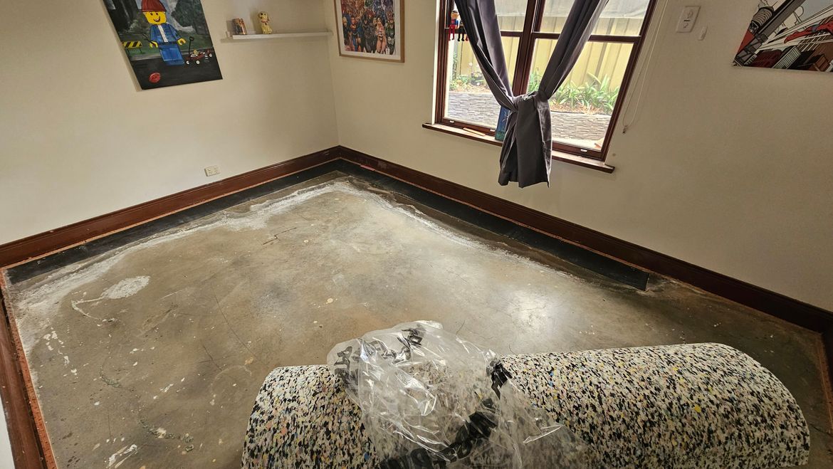

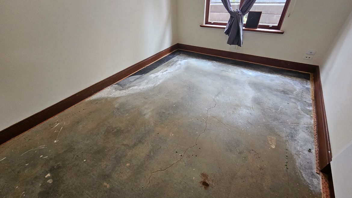

I had some new carpet installed the other week and the installer found water has gotten into my property (see images). The cause looks to be that the previous owner installed pavers at the damp course level outside the bedrooms.

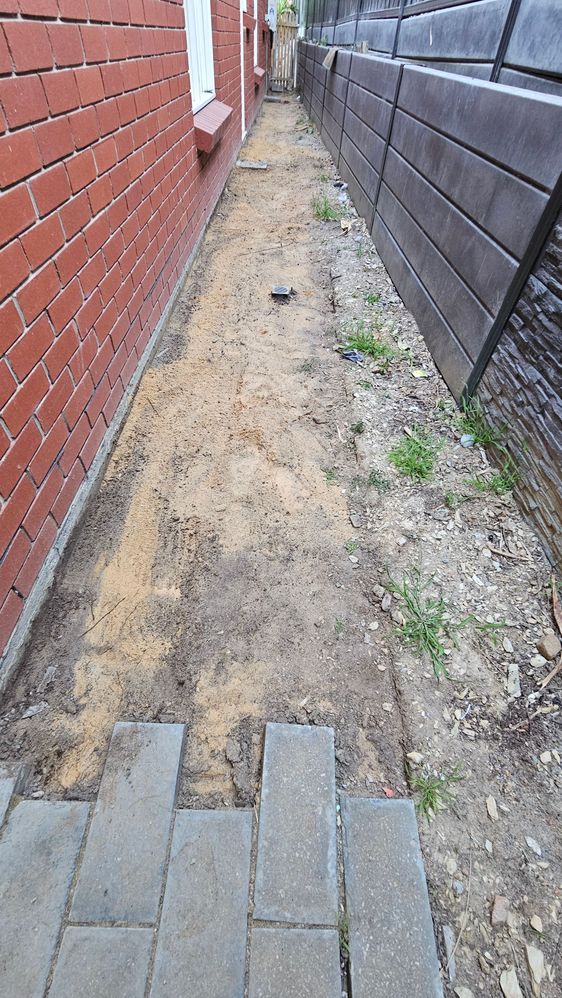

I have removed the pavers (see image) which a can already see should fix my water ingress issue. I still intend to dig down/reduce the level another 20-30mm, then lay 10cm or so of quarry gravel.
The question I have is what should I do for drainage? The soil has a lot of clay and doesn't absorb water well. There is already 90mm stormwater running along the path (as you can see in the image). Should I add more drains along the stormwater length or install some other drainage system (french drain, etc)? Should the drains be under the gravel or level with the top of it?
