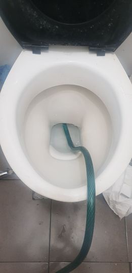

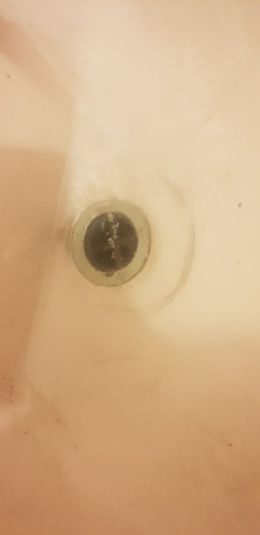

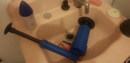

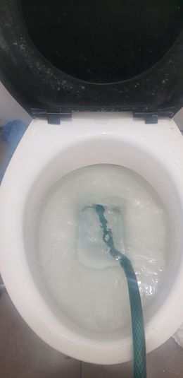

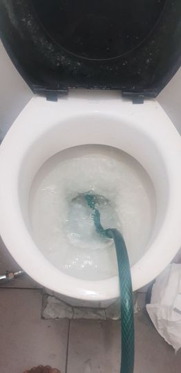

Recently, I've been dealing with a nightmare of a blocked toilet. Last night, I inserted a hose about 1.5 to 2 meters into the pipe and let it run for about 30 minutes. During this process, there was no sign of a blocked pipe as the water flowed smoothly without any overflow. However, as soon as I flushed, the water drained very slowly, filling all the way to the top of the toilet bowl. I'm also experiencing a similar issue with the bathroom sink. I can hear air popping out from the other whenever I use either the toilet or the bathroom sink. I've included more details in the images and video, as well as the products I've used so far from Bunnings. I am confused and don't know how to fix this anymore. Any suggestions?

Will a drain auger do the job when high-pressured hot water from a hose doesn't seem to help? I'm puzzled because the blockage only occurs when flushing, not when running water through the pipes with a hose. Any insights or suggestions?
The water from the hose won't break up stubborn blockages, whereas the auger might @MrConfused. It won't get through tree roots, unless they are very fine, though.
A toilet cistern dumps 4/6 litres of water into the bowl relatively quickly. Even with the hose of full blast, it's not delivering close to that. The drain might be allowing the water from the hose to get through, but when the higher volumn from the cistern enters it backfills.
I forgot to mention that when I fill up the toilet bowl with water from the hose, it still fills up all the way to the top, only running smoothly when the hose is inside the pipe.

The Gerni attachment would likely work on most blockages that weren't tree roots @MrConfused. The limiting factor is whether you'll reach the blockage with the 15m length. The plunger would probably be a bit better than the pump-style one you're currently using.
