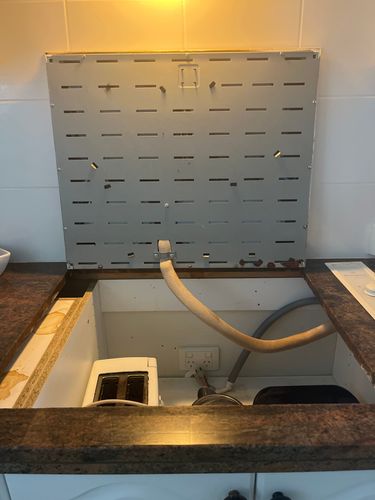

Is it possible to fill in a stone bench top cut out, to change the stove top?

I wanted to place a gas stove top in its place. The existing electric stove is old. The control knobs are also a problem, as you can see in the pic, they are in a separate cut out of the stone. I wanted to cut out that piece between the control knobs & stove top with an angle grinder & diamond blade, to make the cut out as one. As I have researched the naked flame regulations, the new gas stove top needs to be 30mm from the splash back, is that correct? My project is becoming complex. I am also unable to find a suitable gas cook top to fit the space. Can I fill it with a piece of metal or something that can surround the outer edges of the cut out to accommodate a new cooktop that could have different dimensions? I would also be able to abide by the 30mm regulation of the naked flame.

I'd recommend you enlist a professional's services for the adjustment of the cutout and the stovetop installation. Given the control knobs off to the side, it would be best to go with a wider unit that would cover that area, too. There is a possibility of using a similar-sized or smaller unit and infilling around the edge, but it's a much simpler process if you can find a larger unit and increase the cutout size.
You might like to look at our range of gas cooktops for something larger. If you can provide some measurements of the current cutout and the overall size required encompassing the knobs as well, we can assist it in trying to locate a suitable replacement unit.
