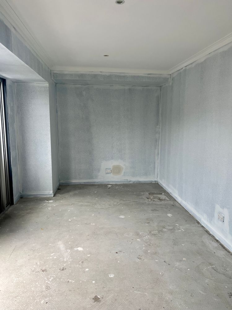

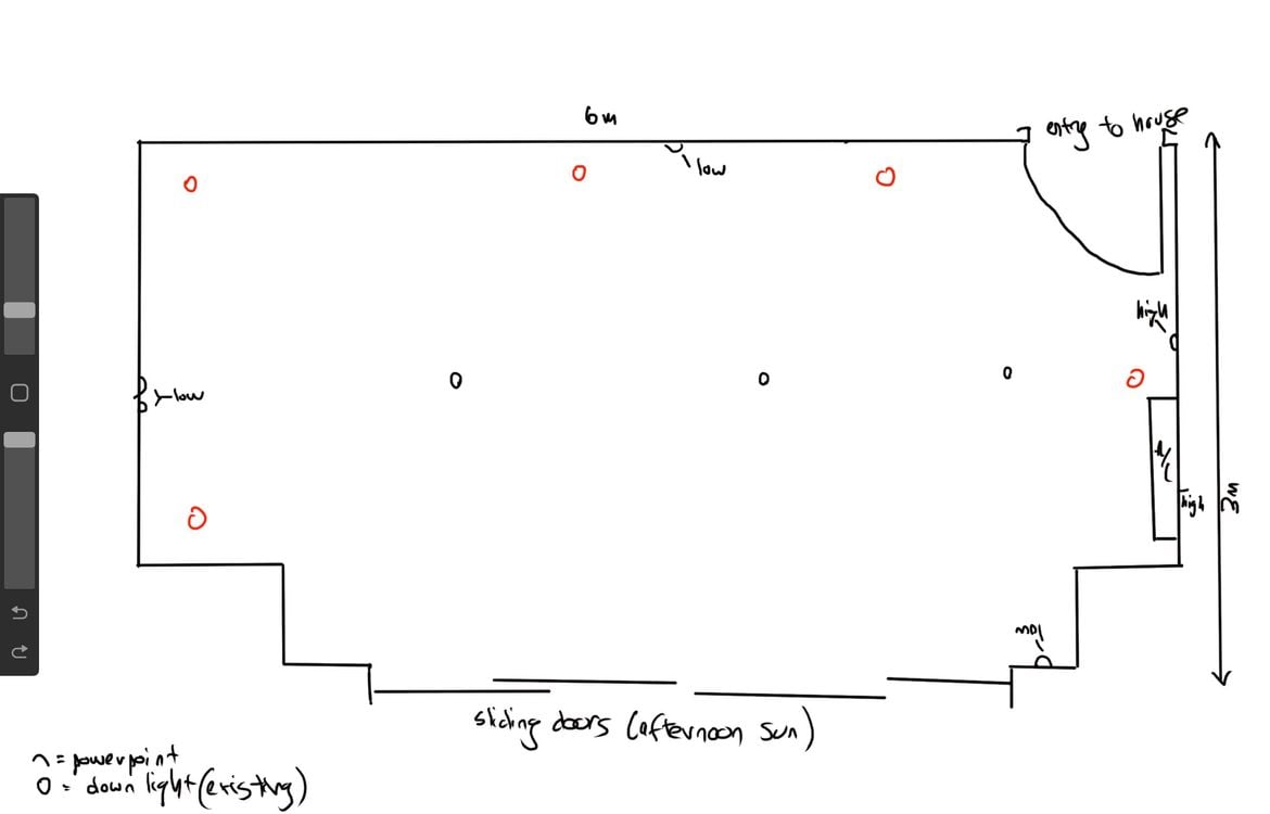

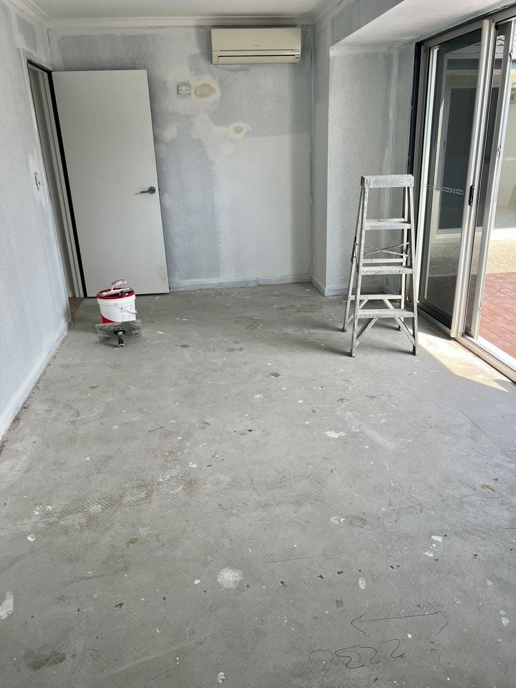

Currently, we have a concrete slab (we just ripped up the high pile carpet and riser that was previously there), so I think some kind of underlay is needed beneath whatever option I go for, over the top. The carpet that was there was so high pile that the room door couldn't close over it, hence deciding to remove. I attach some pics - painting currently in progress, and lighting is to come! I also attach a floor layout I drew - the space is 6m x 3m, with two corner indented and a glass sliding door on that same side.
