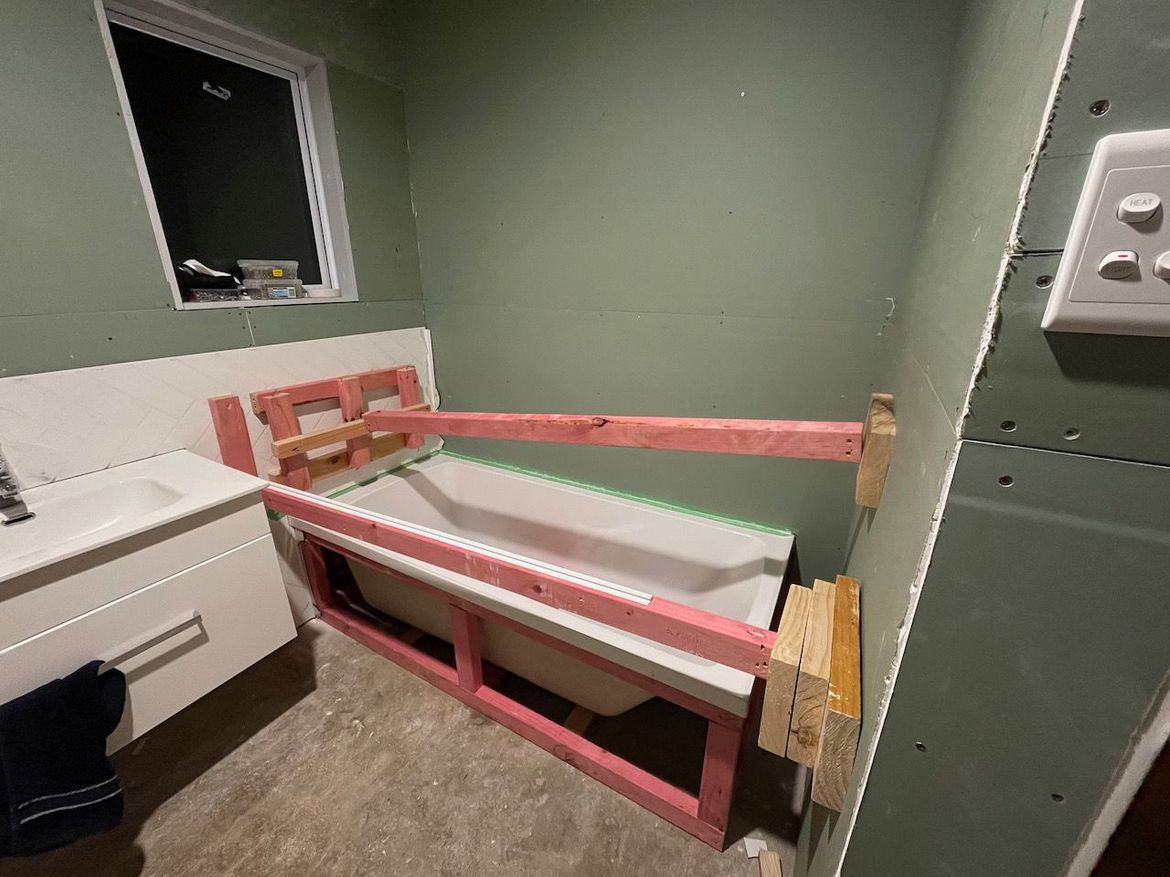

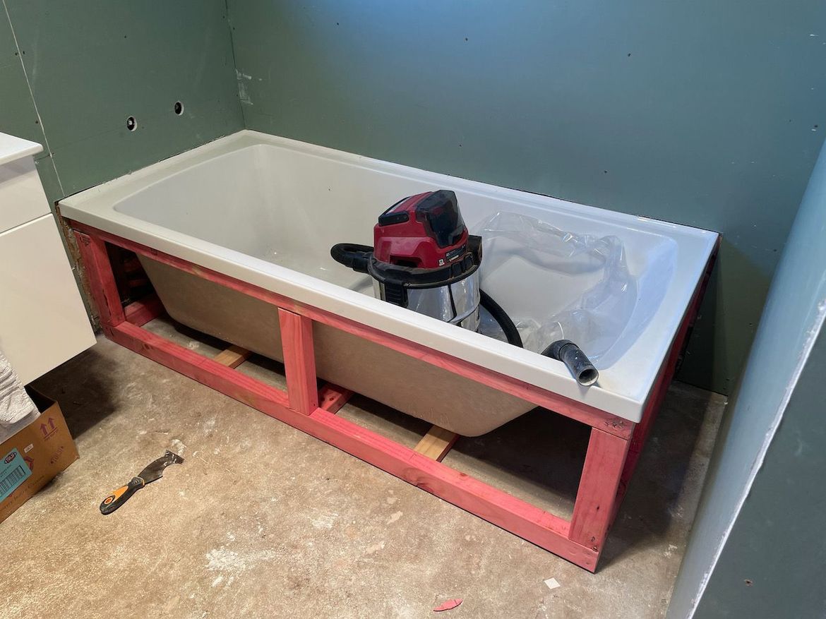

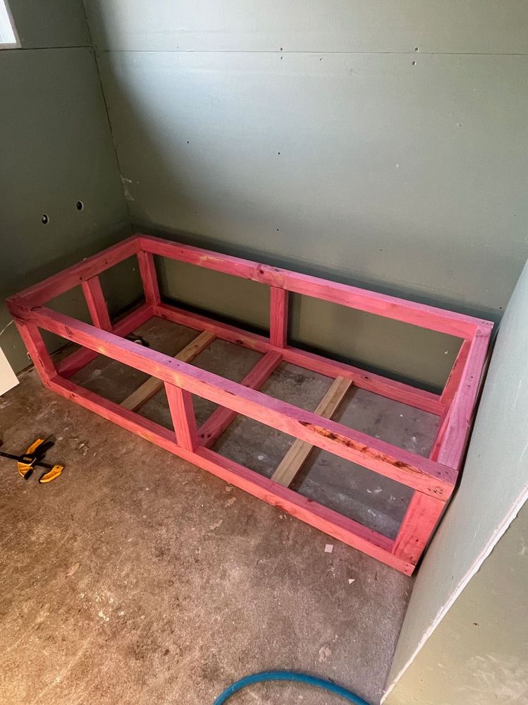

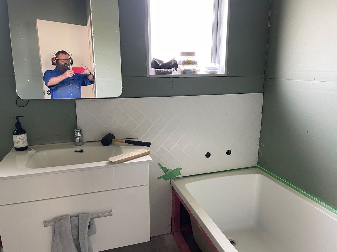

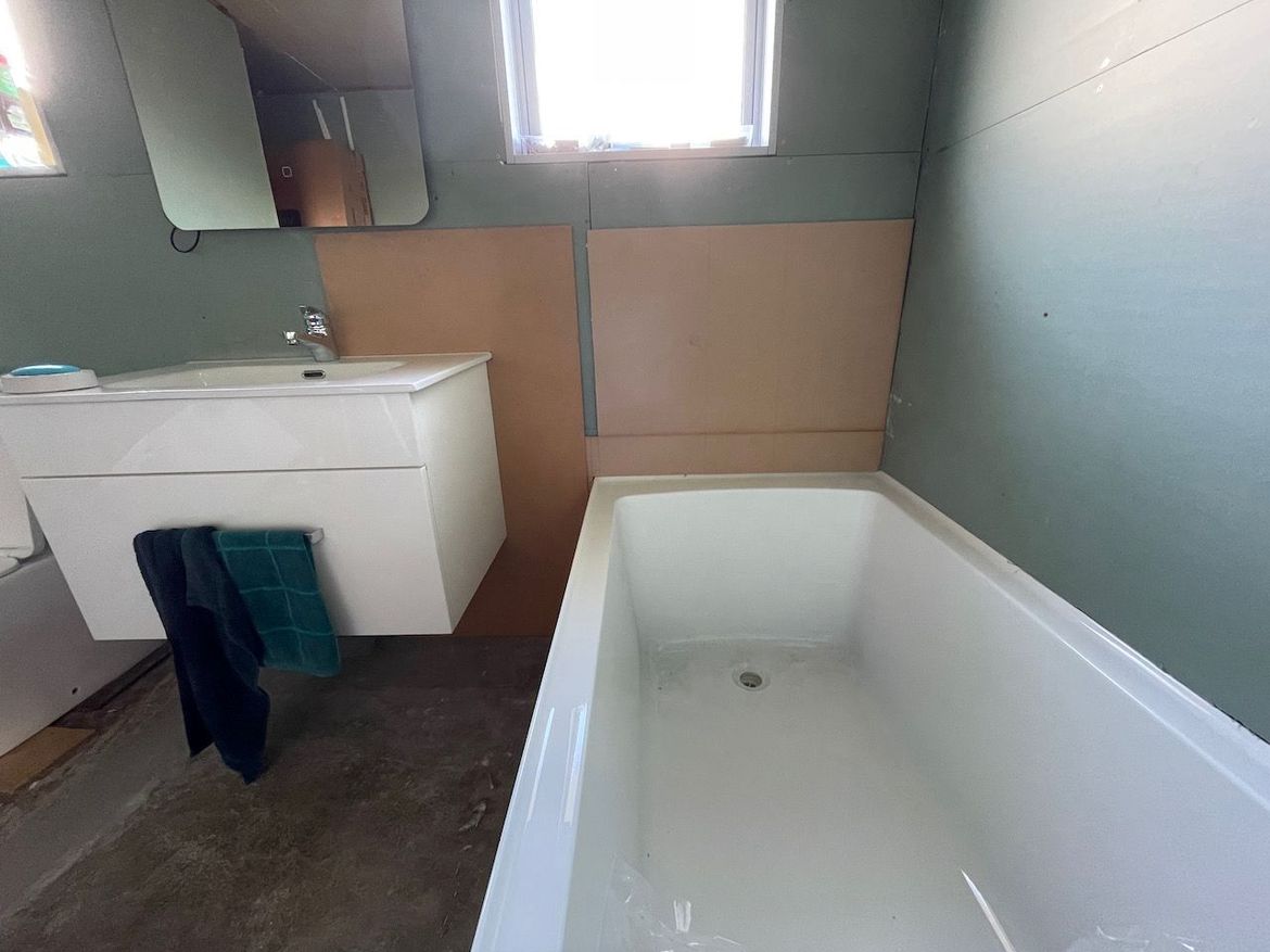

The bath frame was pretty simple. Just a box with supports for the base. Once built and bath inserted we were able to get area cut to cut out in order to recess bath. This allows the water to flow into the side of the bath rather than into the wall.
Once the bath was in place we needed to get the Seratone installed along one wall in order to progress. The plan was to get the bath up and running so we had something to use while we pushed on with the shower.

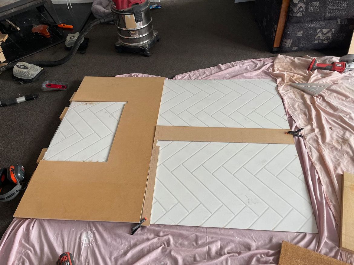

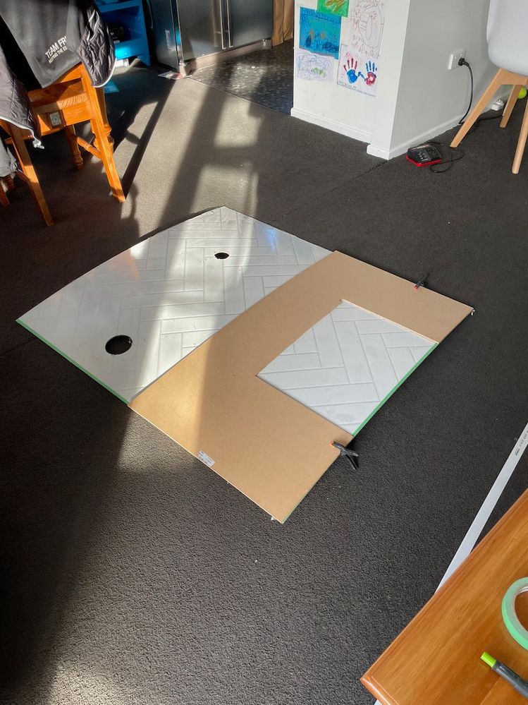

I made templates using scrap MDF in order to see if the fit was right. I regret using those templates to mark out the Seratone though. I should have just measured everything directly to the board because I had a miserable time marking, cutting, marking, trimming, blah blah blah. Luckily it was trimming because it was not enough cut off. Would have sucked if it was the other way around. 🤣

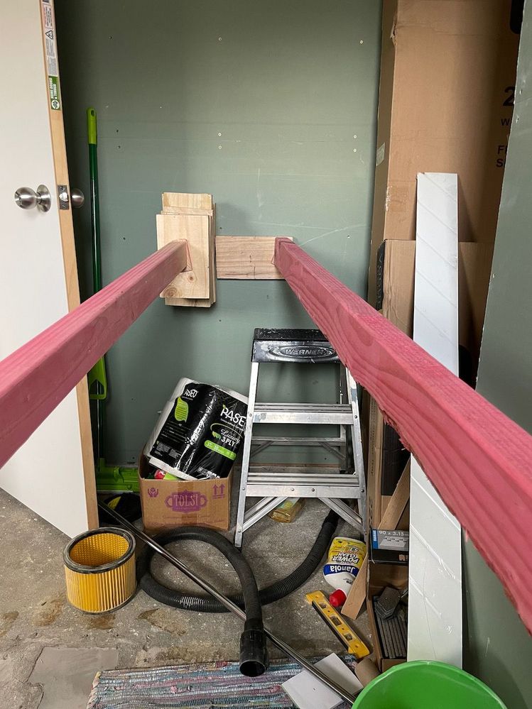

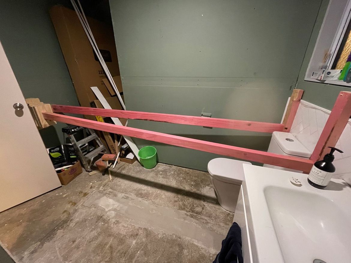

I started to use a GIB lifter to hold the sheets up while I waited for the glue to dry. The problem with this is the need for the compressor to be running all night. So I ended up using framing timber and packing it out with blocks that we use in the fire place.

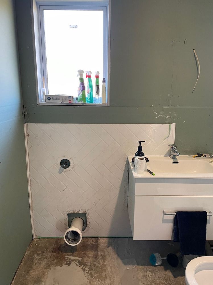

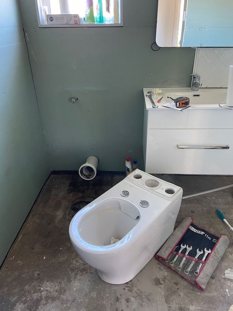

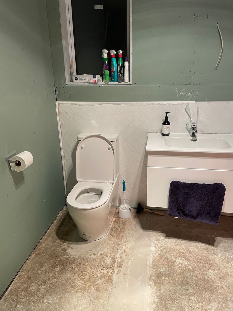

I was tempted to cut up to the toilet but it was a pain in the butt doing around the bath so I figured it would be easier to just remove the toilet and cut around the pipe. I was right. 😈

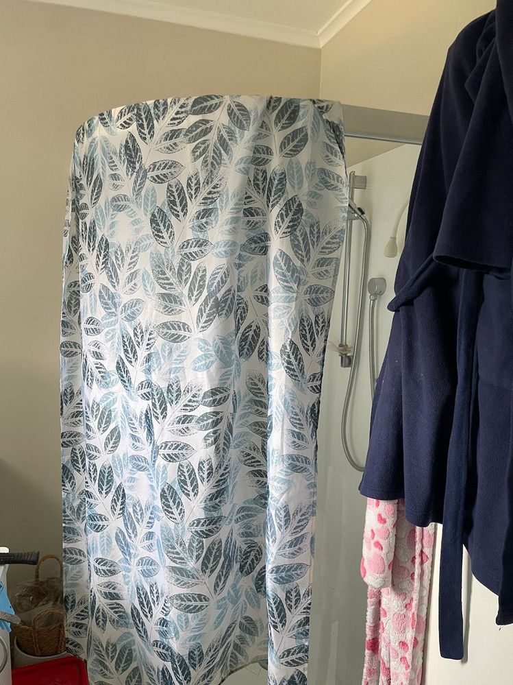

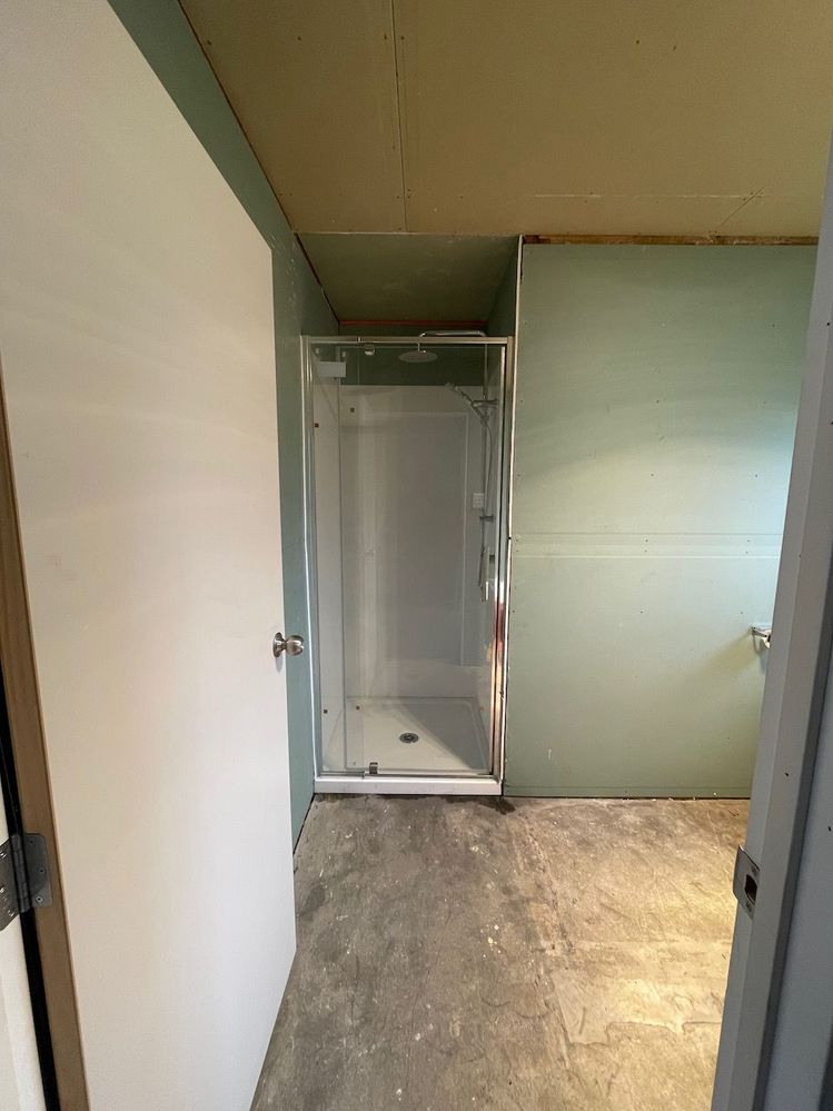

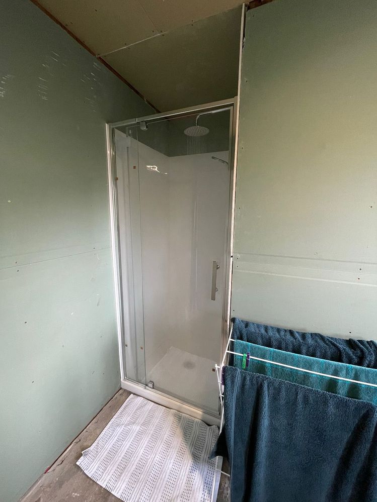

With the bath in it just needed the plumber to come in and install the shower. First we had to remove the old shower which is why the bath needed to be up and running first.
The plumber needed to get access to the back of the shower so removing the old shower had to be done. So more demolishing was needed. I like this stage a lot.
Once again I needed to make a cutout in the GIB to allow for drainage into the tray rather than the wall.
