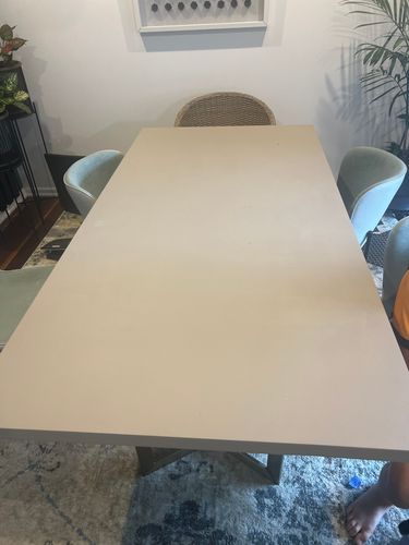

Hi, I’ve painted my concrete dining table top with a paint and was wondering which sealer should I use.. any suggestions please?

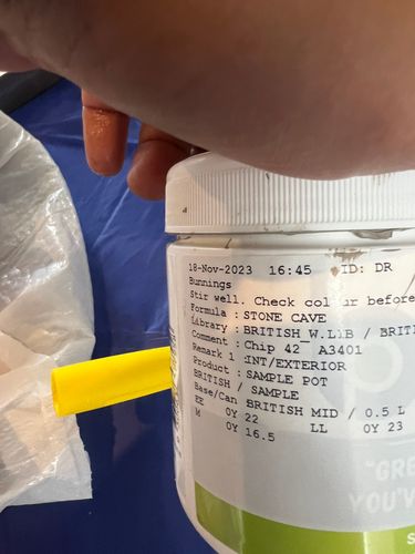

Thanks Mitchell for response. I’m attaching a pic of the paint I have used. Hope it helps otherwise let me know pls.
Many thanks for those details, @sash12.
That's a sample pot of wall paint that, by nature, is extremely soft and unsuitable for your project. In regards to clear protectant coats, there's nothing specifically designed to go over it for protection. However, Cabot's Cabothane Clear Waterbased can be used over a previously coated surface. Their definition of "previously coated surface" is likely not wall paint over concrete, but it would be worth a go when the alternative is to live for the soft coating on a working surface.
