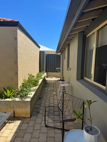

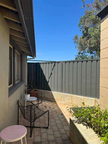

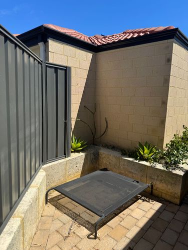

My partner and I are looking to enclose this outdoor area so our cat has access from the window. I’m wondering how we might go about this?

Anchoring methods is something that you'll need to think about. You want it easy to repair and maintain. Just make sure to use treated timber so that it is rated for use outside. I recommend drawing it on paper so that you'll have a very good idea of how big the frame will be, and how far you want it to go. It will put everything in perspective and give you a better idea of how much the project will cost.

that sounds like a really wise idea. would you recommend fixing the frame to the wall and house directly?

There have been quite a few discussions regarding cat enclosures and cat runs. But I think it's important to take into consideration if you are covering the whole area or if you are just making a mid-size cage that allows your cat outside.
I propose thinking about building a lightweight timber frame that can cover the gap between your roof, fence and wall. You can then cover the frame with bird netting or pet mesh. This will save you from having to create or build elaborate anti-escape cat fencing.
