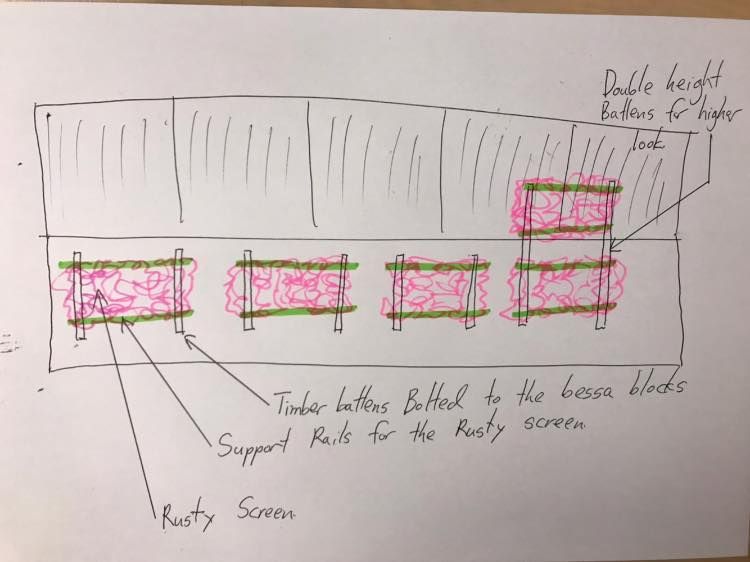

hahahah If you think you you have a filthy poor fence thendont look at my photos!
Here is an idea.
Timber battens mounted verticaly with the battens either extnding further then the edge of the rusty display piece or to be hidden. (Black verticla rectangles)
Support rails in green to screw the rusty displays to (In green)
Pink is for the rusty display panels. You could als make the display higher or bolt to the wall and have the rails set high to give the illusion of space?

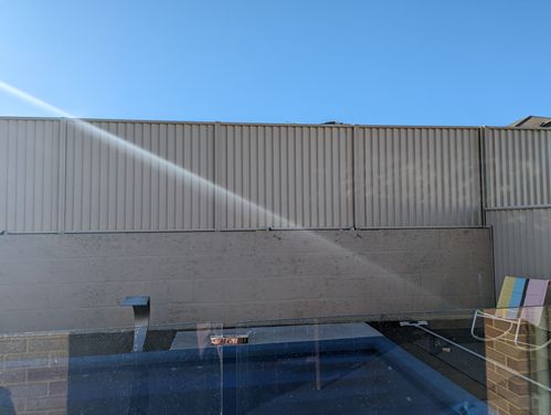

Thanks all for the replies so far. Here are a couple more wider shots, excuse the filthy pool fence and general garden mess 😄.
Height wise, the wall is 1460, length wise it's around 10800. The panels we are looking at are 1800 high, but we really like the idea of having around 4 of them (with a gap between) horizontal across the wall.

Thanks for the photo @daisydog82. When you are doing the measurements, perhaps take a few more wider shots so members get a better idea of the whole space and what you are working with.

Thanks @EricL , here is a zoomed in picture. We were actually thinking of mounting the panels horizontally, rather than the typical vertical - as I think the panels will be slightly too high. Just not had chance to go out to take measurements etc. will be doing so tomorrow.

Before I make any recommendations, would it be possible for you to post a few pictures of your retaining wall? This will give our members a chance to assess the area and find out if there are any good anchoring points. We can then make recommendations on how to mount your decor panels.
