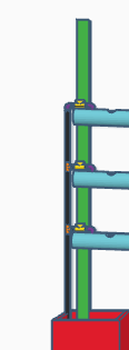

On one of the lengths of pine mark a line that is at least 90 mm more than the height of one of the containers, including the lid.
Then make a mark 400mm and 800mm above that line.
On another of the lengths of pine make the same marks plus 20mm.
Attach the ends of other 3 lengths to these original 2, using the marks to line up the top edge of the timbers.
Place the first timber on the right if you want the water to run to the right side, as I have done in my setup.
Cut the 6 M length of stormwater pipe into 3 even lengths minus the bell end.

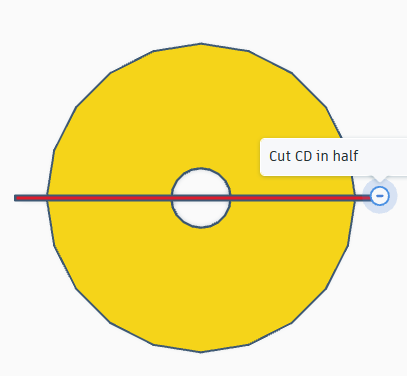

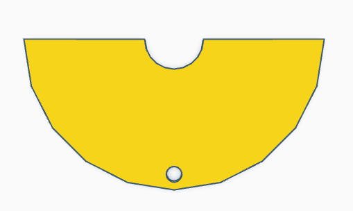

Next cut a CD in half.

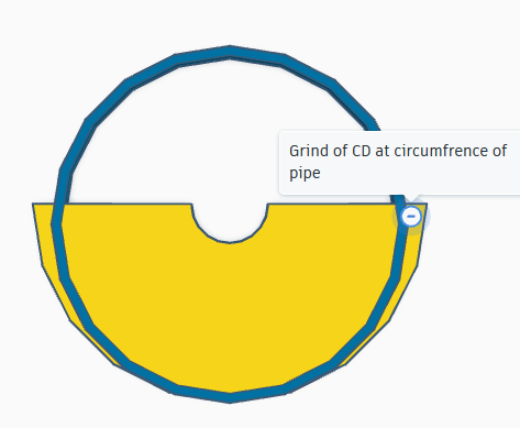

Use the small end of the bell end that you have already cut off to mark the CD and grind off to fit the outside of the pipe.
Next drill a 5mm hole near the what will be the bottom of the CD
Repeat for a total of 3 CD halves.
Next attach a CD to the each of the currently vacant ends of the 2M pipes using either the silicone or some tape, with the small hole furthest from the 75mm holes in the pipe. The hole in the CD will be the drain that will encourage the roots in your plants to grow as the water between each cycle drains away.

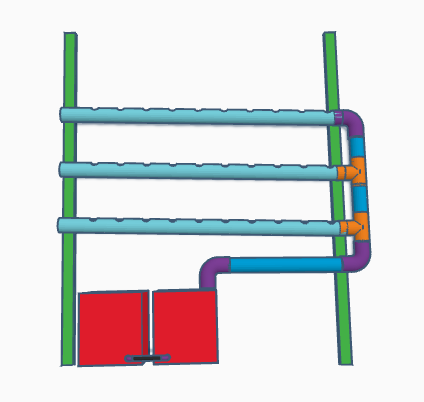

Step 3
Next place one of the elbows with the opening facing away from the 75mm hole on the same end as the CD. This will be your top pipe.
Place the two T-junctions on the other two pipes in a the same orientation.
Now lay the frame down and place the pipes in order on top of them, lining the top of the pipe with the top edge of the timber.
Now cut the other pipe to fit between the elbow and the first T-junction and another piece to fit between the 2 T-junctions.
Finally cut another to join the bottom junction to another elbow, this will divert the water to your reservoir.
After this is done use the metal strapping or cable ties to attach the pipes to the frame. then stand the structure up, leaning it against a wall in a sunny position.

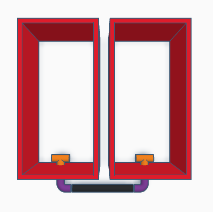

Drill a 14mm hole on the short side of both of the reservoirs.
Insert a small piece of irrigation pipe into the hole and place a T-piece into the pipe on the inside of the container.
Then place an elbow into the pipe on the outside
Next apply some silicone around the pipe next to the T-piece and pull the pipe through to the outside, creating a seal.
Then join the two elbows. This will create one reservoir out of the two containers.
Now join the remaining stormwater pipe to the bottom elbow and lay it across the reservoirs. Cut it to length so that when the final elbow is placed it will drain into the right tank.
Then, after fitting the elbow, mark where to cut a hole in the lid.
After cutting the 90mm hole place a short length of the pipe into the hole for the elbow to join to.
Step 5
Next cut the irrigation tubing to fit as per this diagram.
Make sure to allow enough tubing so that when your water pump is fixed at the bottom it is sitting on the base of the reservoir.

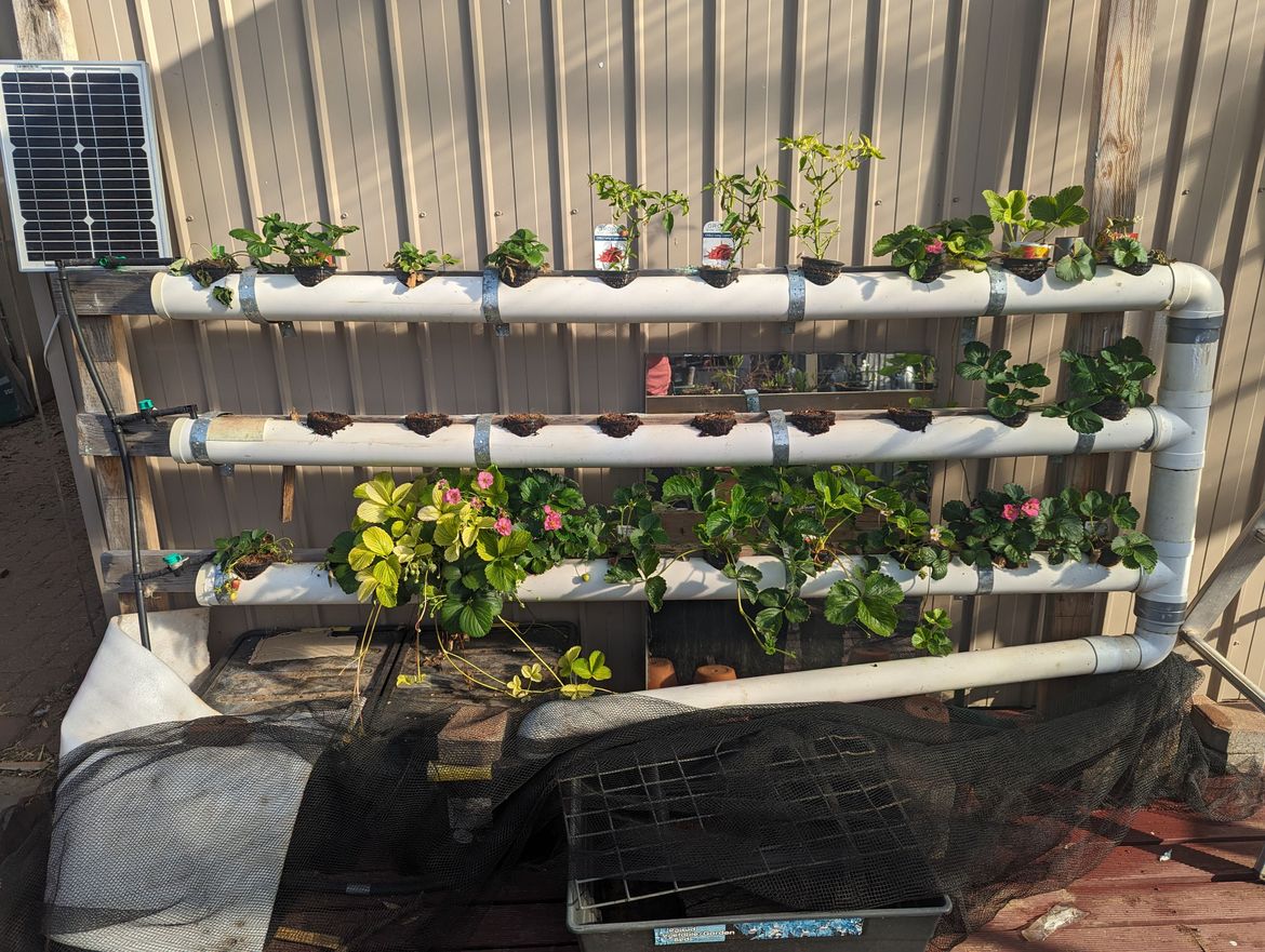

The rest of the setup including the wiring of the solar panel, controller and battery will be explained in the instructions for these devices included in their packaging.
My setup is programmed to deliver 5 minutes of water every hour from 8AM to 6PM. You will need to keep an eye on the water level to make sure it doesn't run dry. It's also a good idea to drain the system and replace the water on a regular basis to prevent the build up of toxins.
A little research on hydroponics will go a long way to ensuring your system gives you plenty of fruit. I hope you found this guide helpful.
