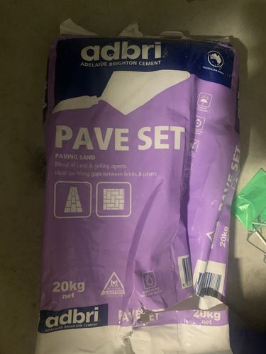

Hey I need a good brand of paving lock or paving set this it the brand that we got from Frio-stone they say it’s white, but it’s not I followed the instructions correctly but it keeps washing out
Hello @ethan18
Thanks for sharing your question about filling in between pavers. I'm sorry but I'm not familiar with that particular product from Adbri. I suggest having a look at the Easy Mix 20kg Paver Bond Polymeric Sand. It is a blend of kiln-dried fine sand and a gelling agent formulated to create a cohesive joint between pavers. Once activated with water, the gelling agent causes the sand to clump together which makes it more difficult for ants to burrow and for weeds to take root.
However, if you are a stronger filler, I suggest using the sand and cement mix which is 5:1. That would be 5 parts sand and one part of cement. Once brushed into the gaps brush off any excess material off the pavers. Use the mist function on your garden gun to wet the mixture and it will harden in place. Your goal is to get it wet and not wash it away.
Here is a handy step-by-step guide: How to pave a pathway. (at the three-minute mark you'll see how the gaps are filled)
