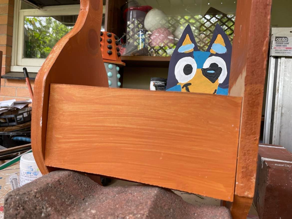

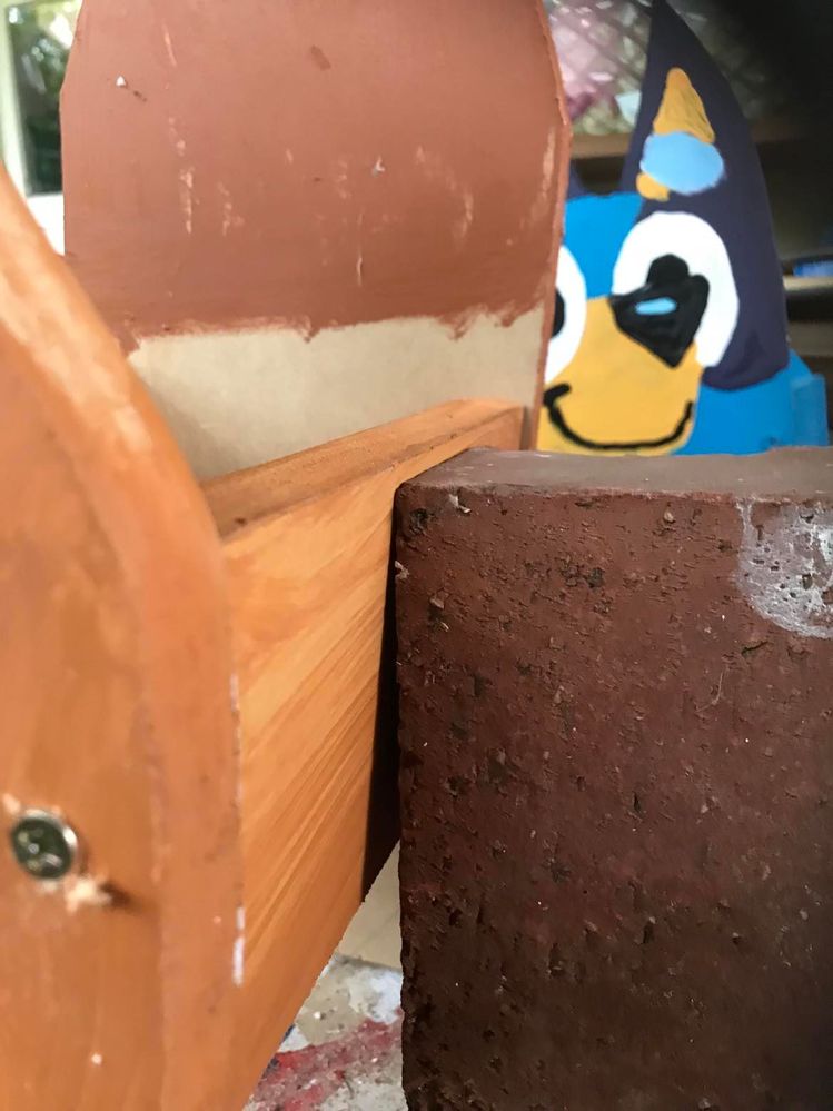

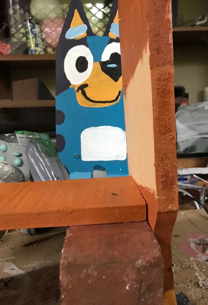

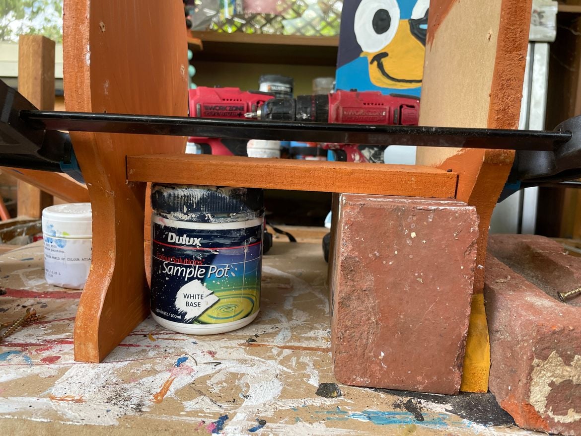

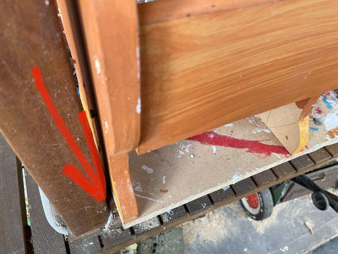

The house bricks are used to do the floor first. The paint containers are handy as well. Sash clamps are good if just gluing. Next, a higher brick for each side one at the time. A single screw at each end at the top. To get the side vertical, a tri square of a house brick to align. The feet were drawn up to be along a side, so the should easily square up. The work bench needs to be flat for the model not to wobble.

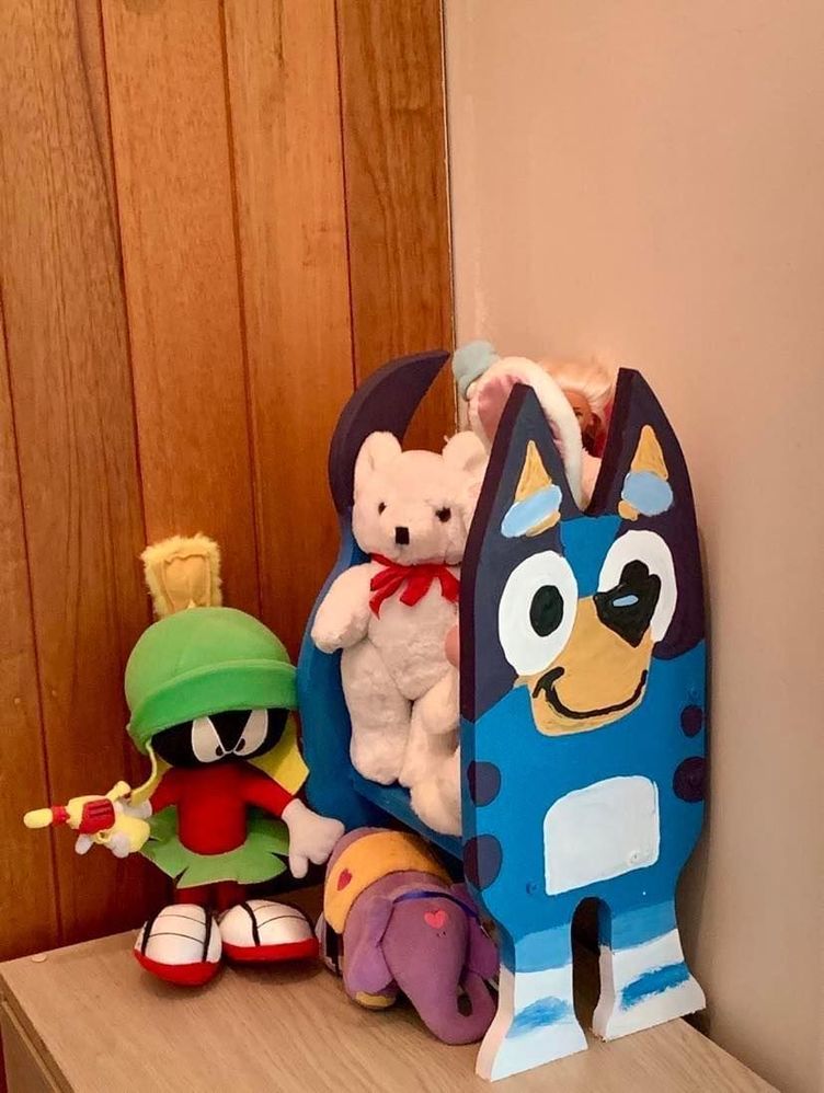

Toy Shelf
Going for a ride.

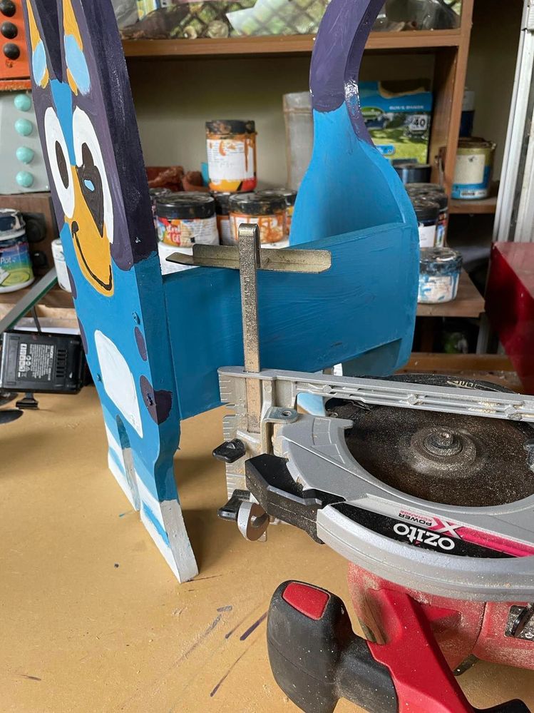

The saw used, althought I'm sure the cost of sawing the bits up, wouldn't be much.
Using house house bricks to get as alignment jigs.

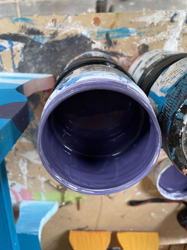

The colours. The blue dog, Taumans Fiji waters. The dark purple, was some red and some of this blue mixed. The black was night sky, the white was vivid white. The tan dog, Black, night sky, the darker brown, Natural Parprika, the lighter brown, Bronze Eucalyptus, the yellow was Curry Sauce, the white, vivid white.

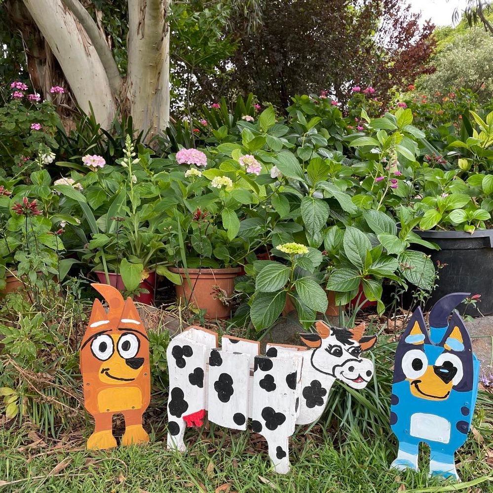

Out in the garden.

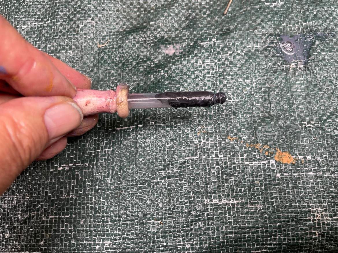

Using an eye dropper on another model for fine lines.

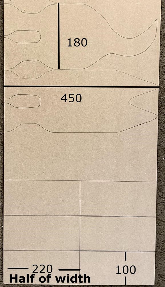

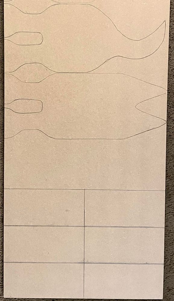

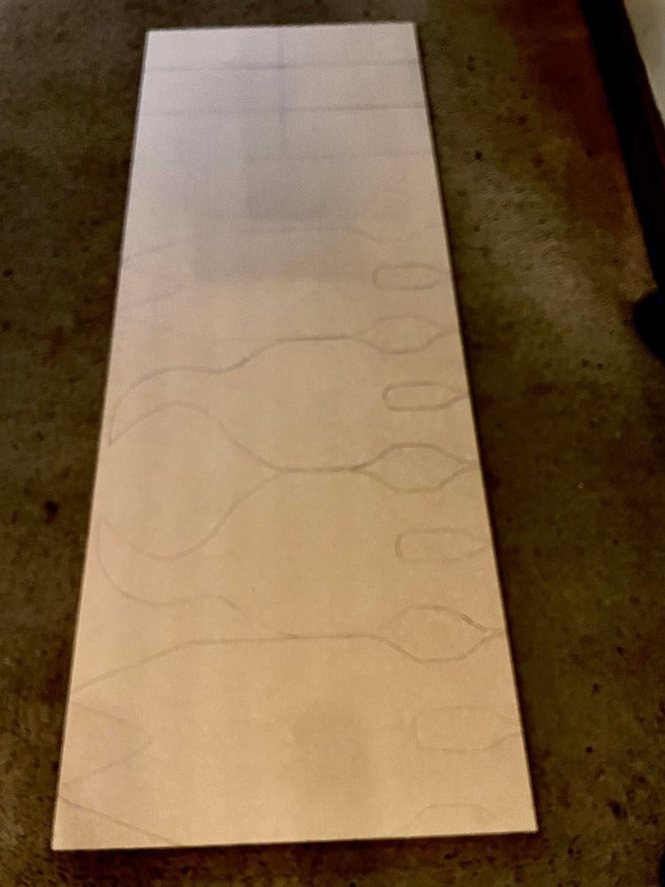

Making two dogs from a single sheet of MDF wood. Made the design to fit the wood, for minimal wastage. https://www.bunnings.com.au/16mm-mdf-panel-standard-1200-x-450mm_p0590053

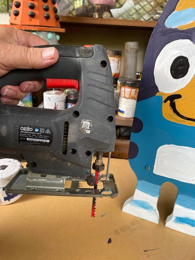

Circlular saw and a jig saw.
If don't have these, can go to the wood section, and ask for rthe wood to be cut, and the bits that are normaly cut off, paint that section with the paint colour that might match the background colour. If a flat tint wall in a bed room, that colour, if in the garden, a green colour like leaves. Glue wood be used in stead of screws.
